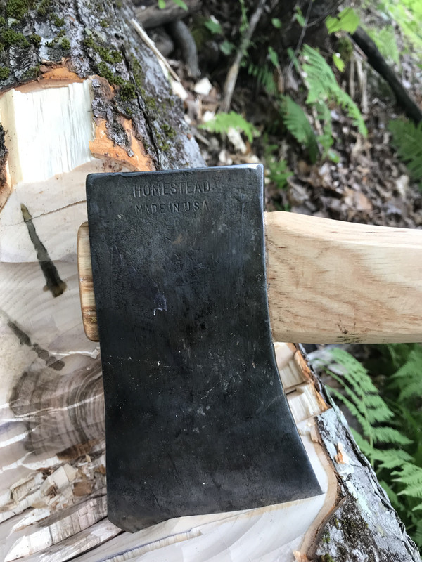

Collins homestead 2 lbs 6 oz hung on a 31 inch handle that I thined and made octagon. I had been wanting to try a boys axe head on a longer handle. Thinking like it a lot so far.

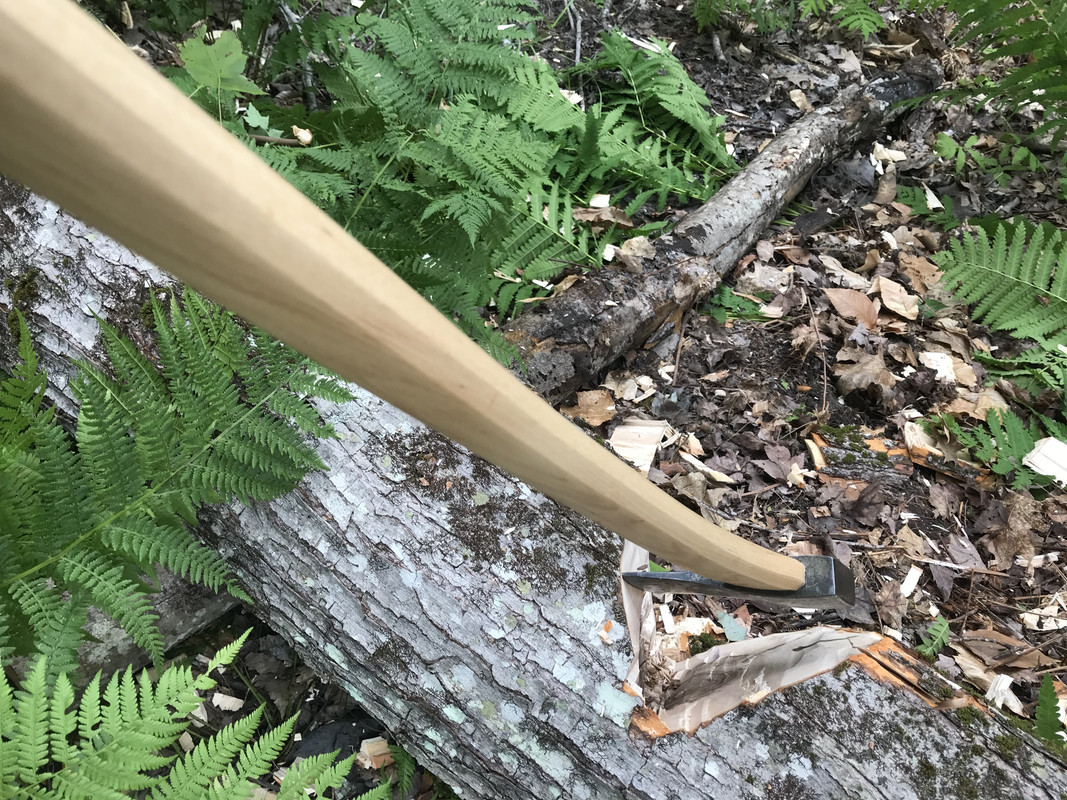

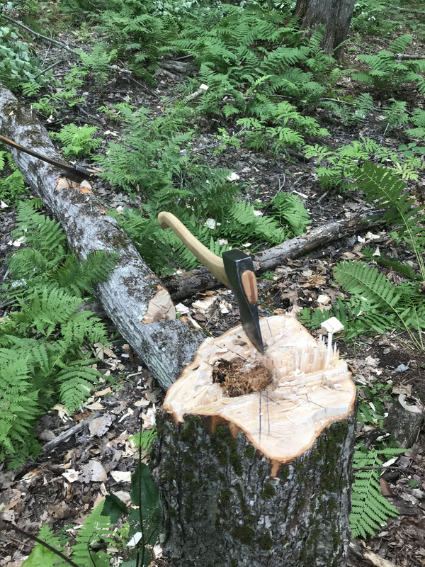

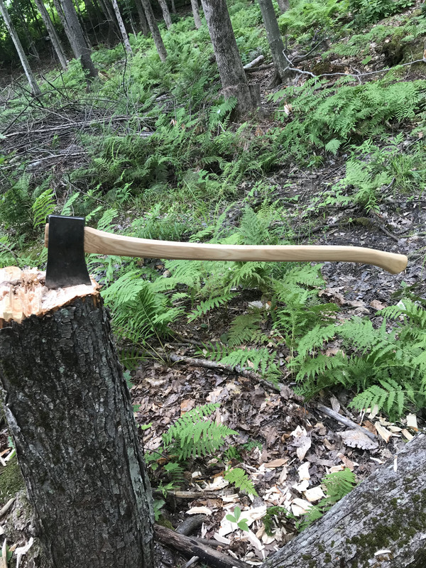

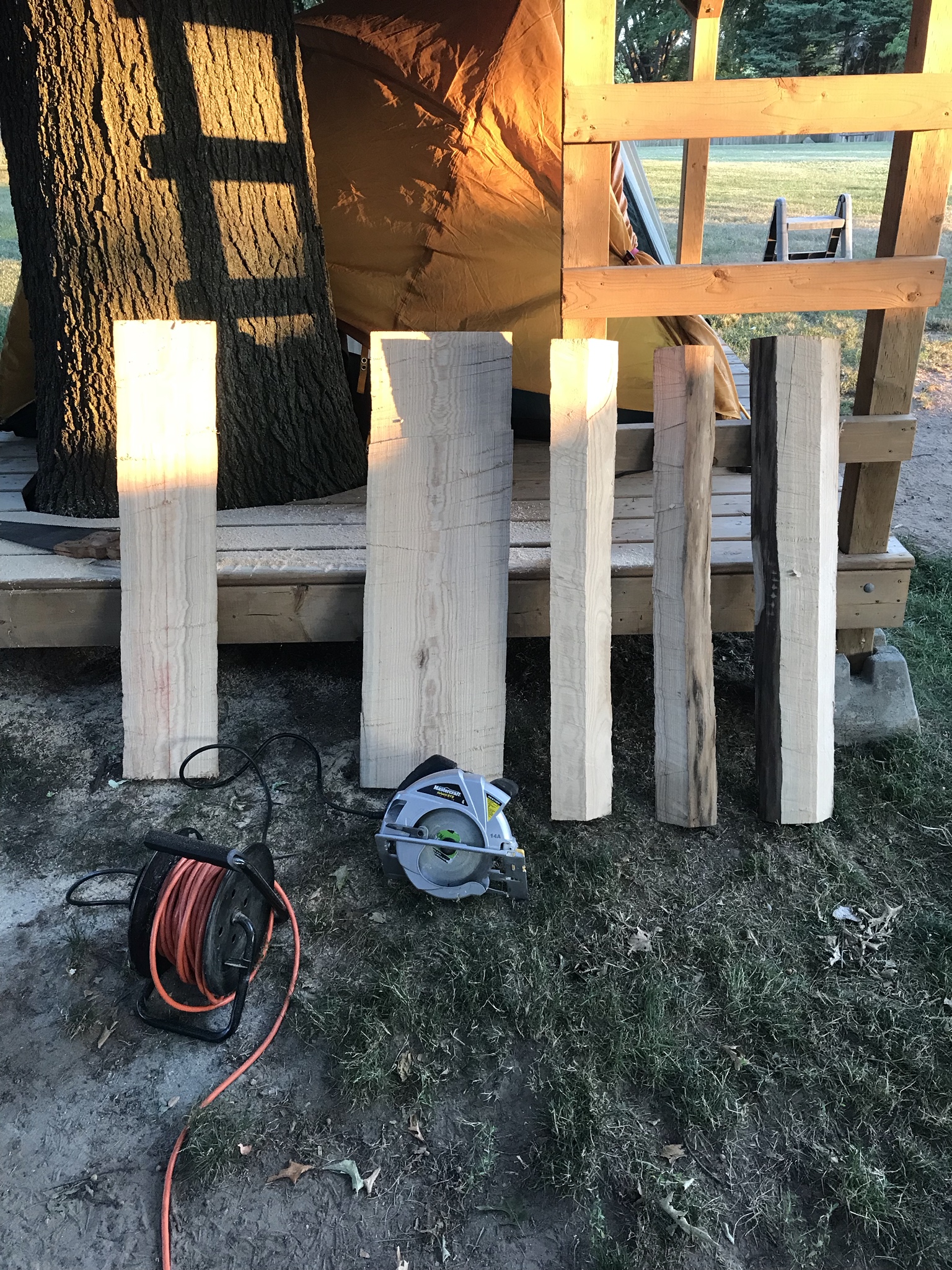

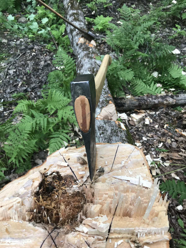

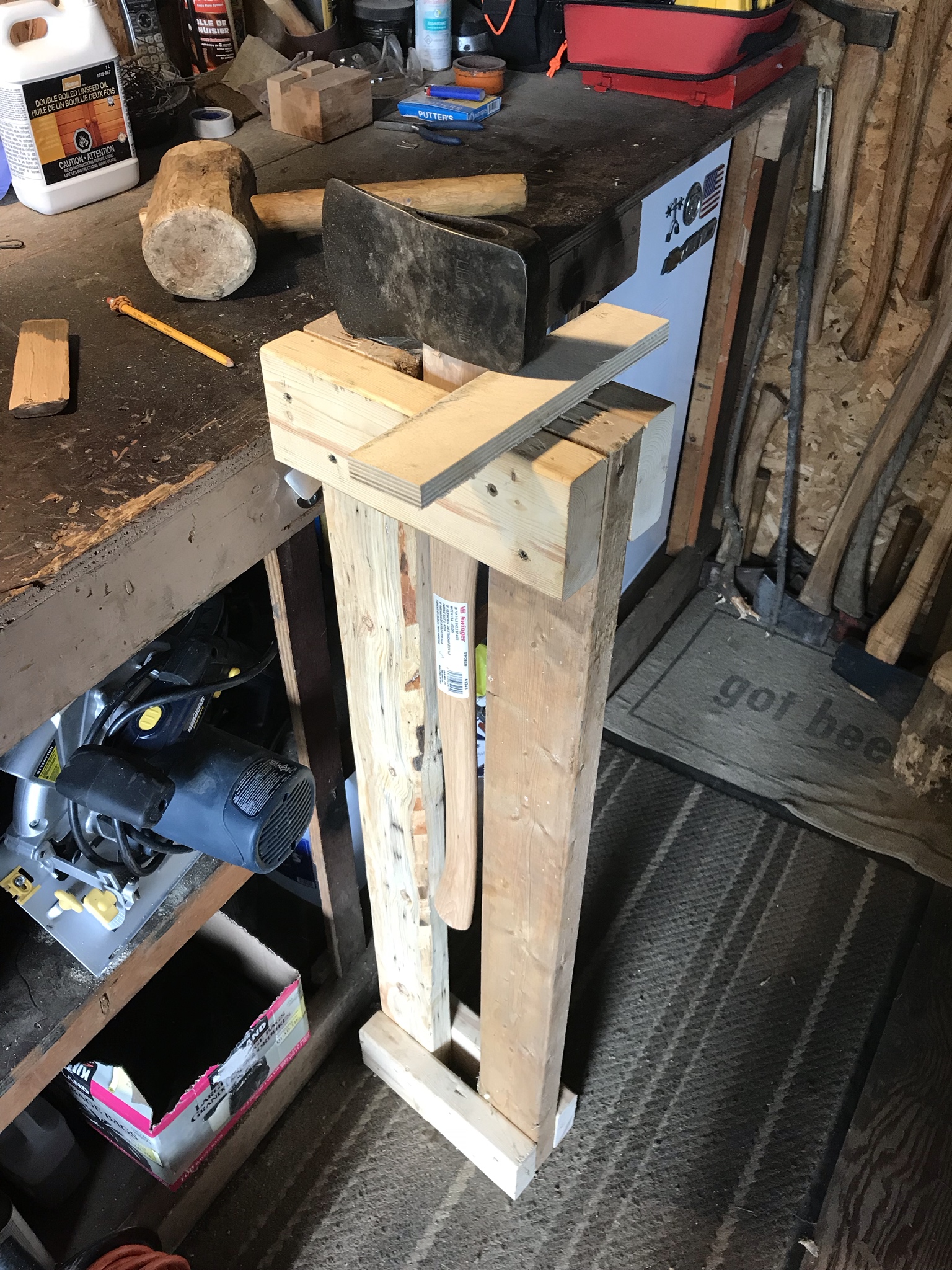

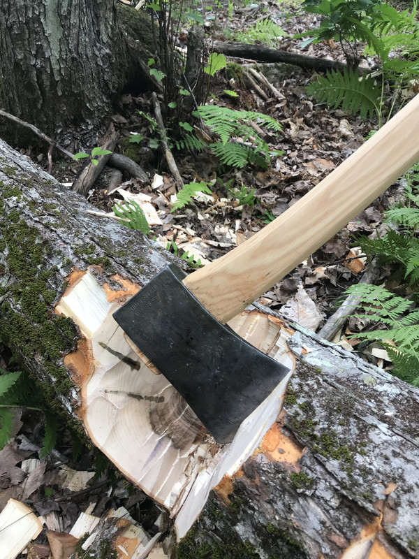

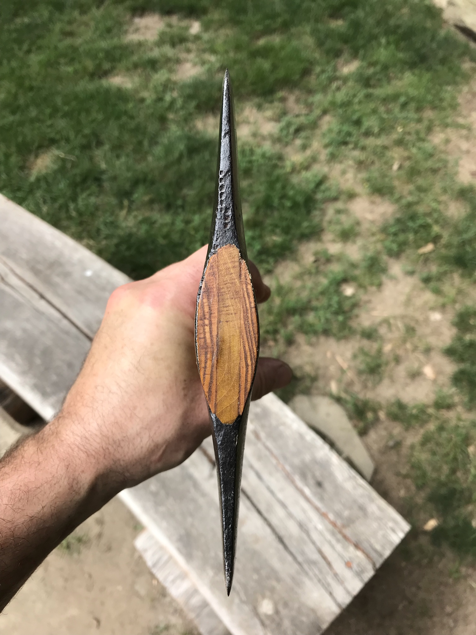

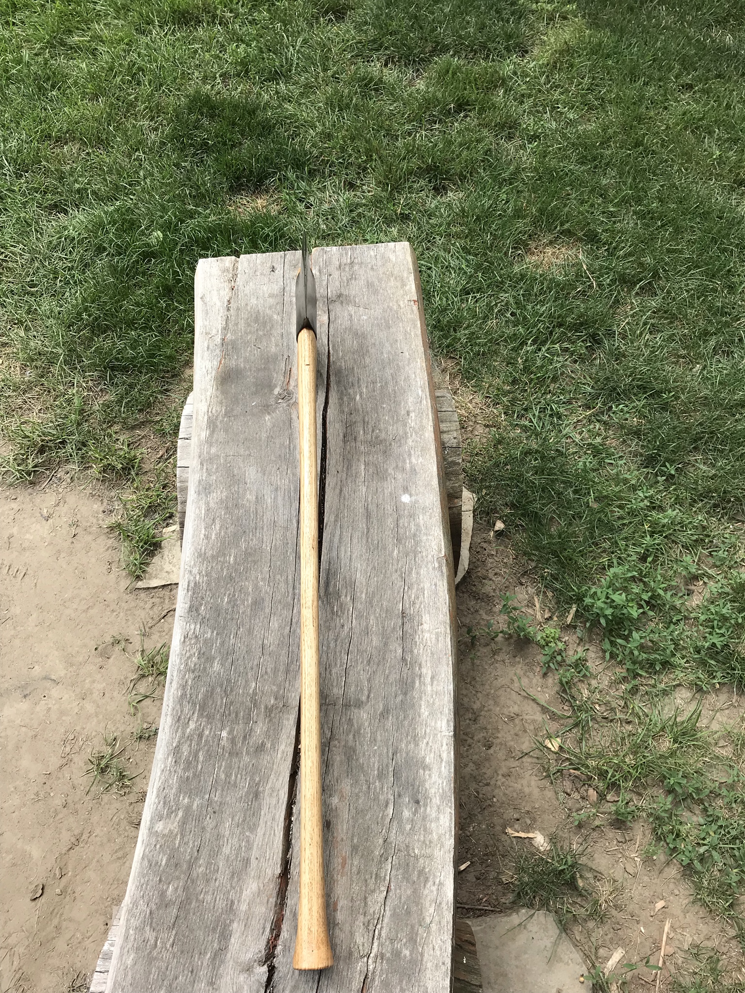

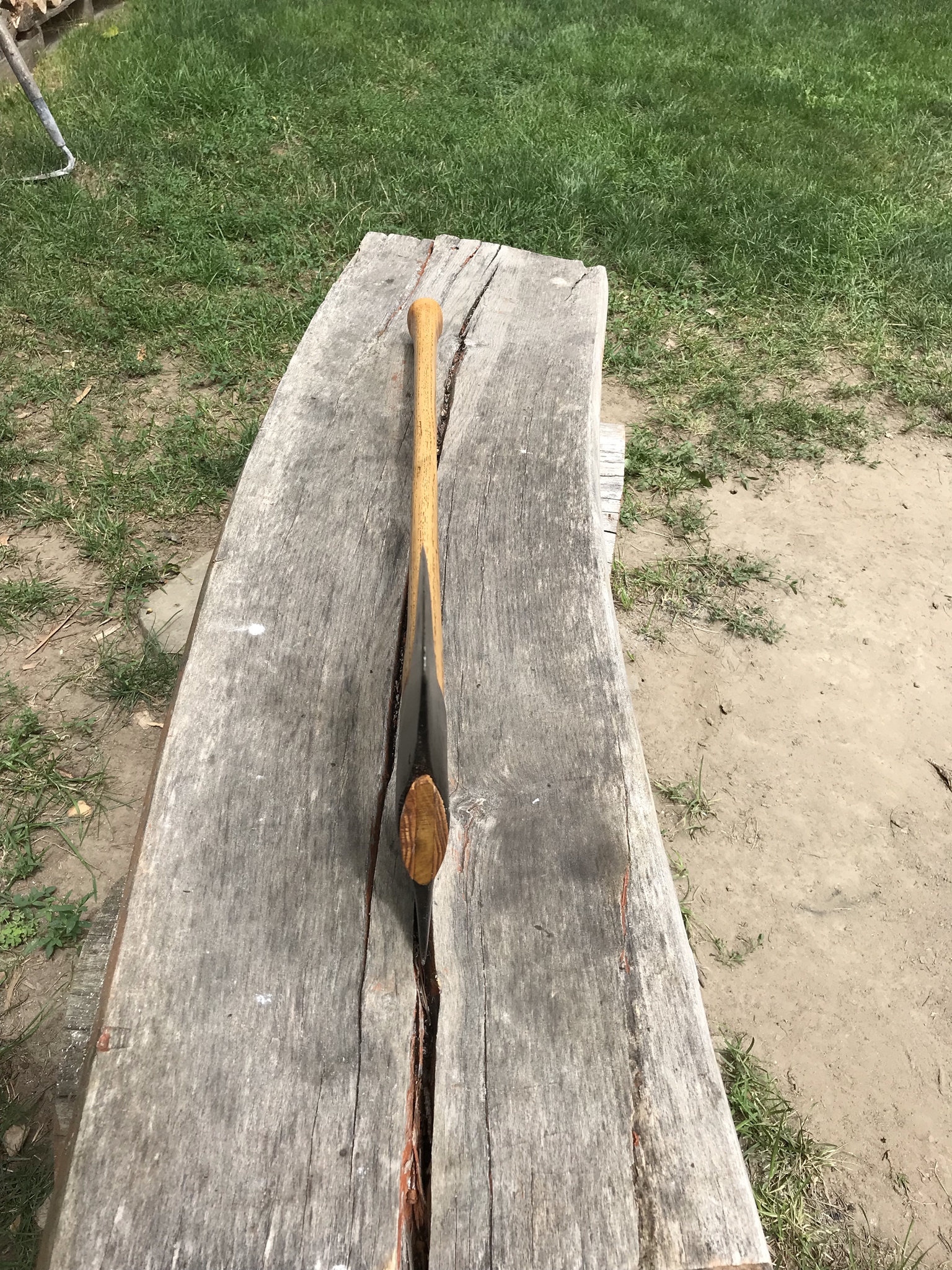

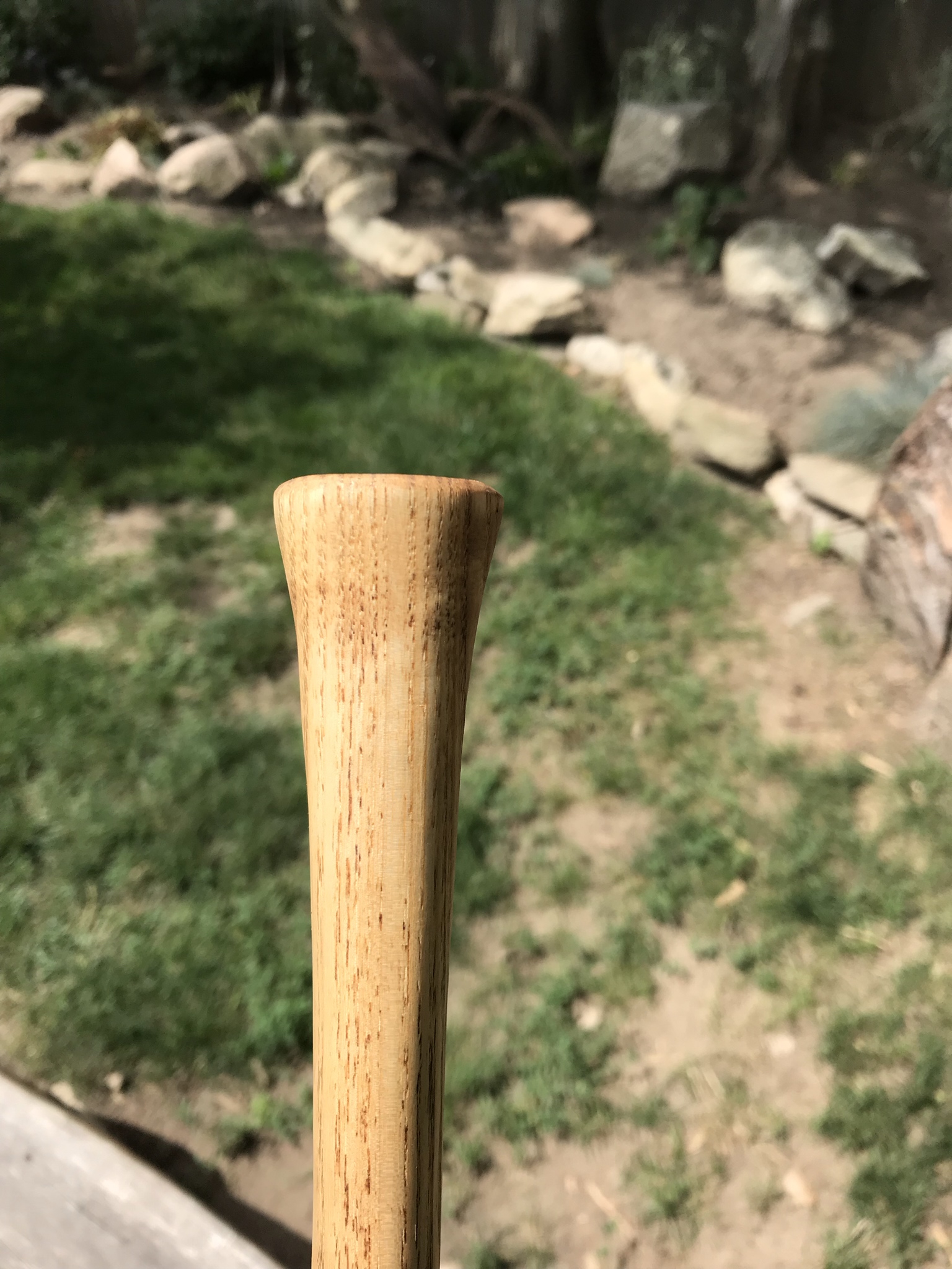

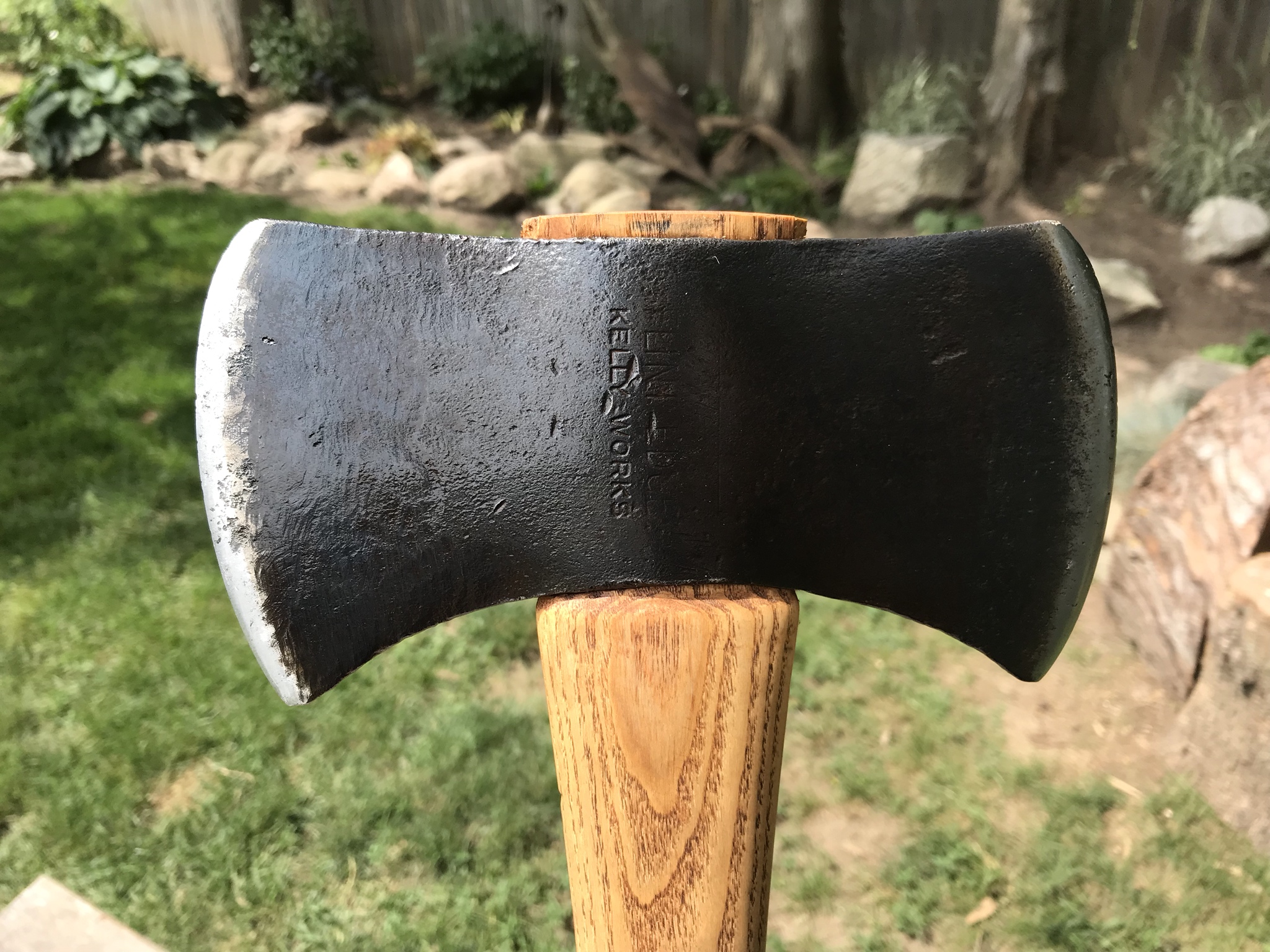

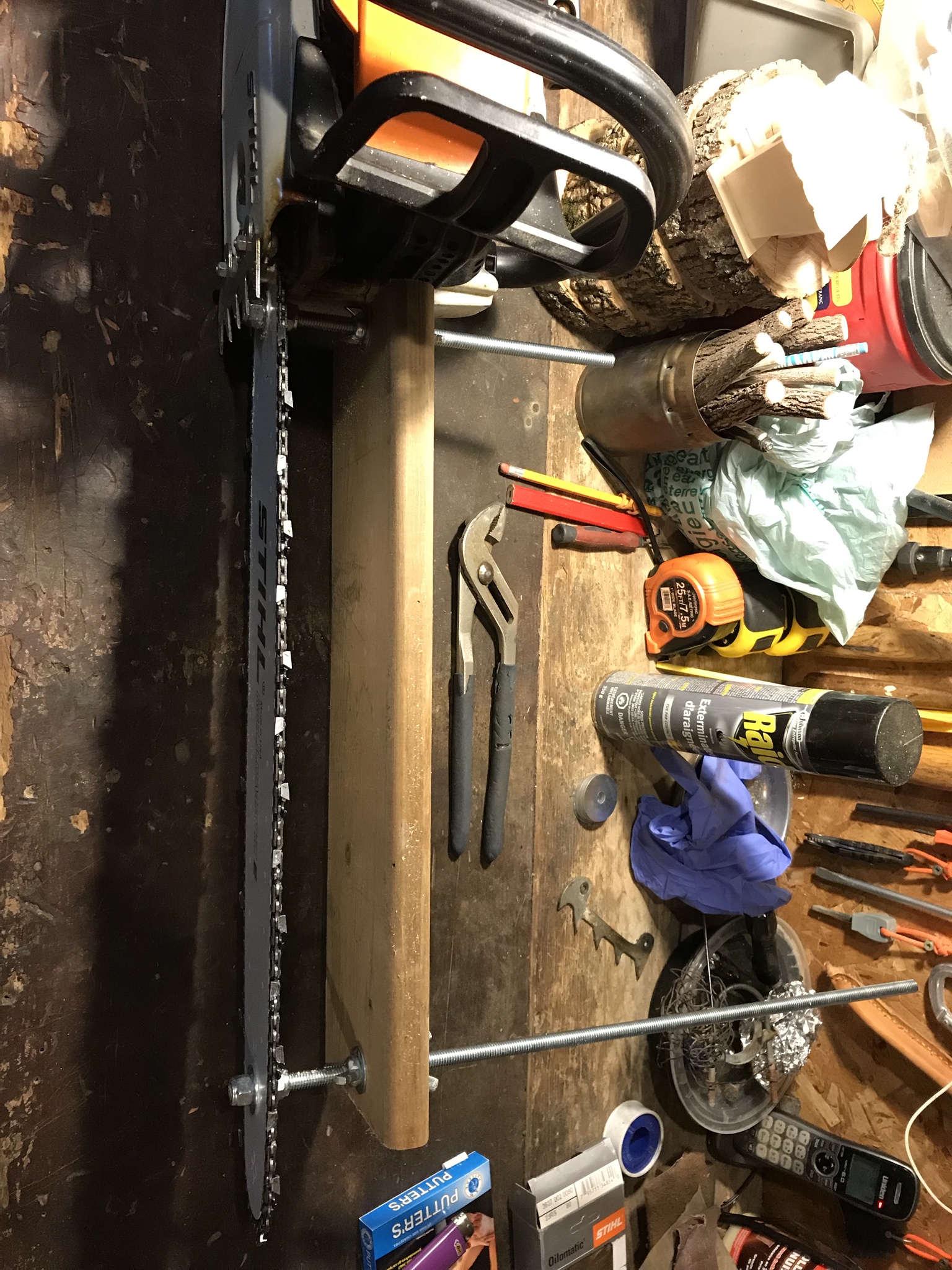

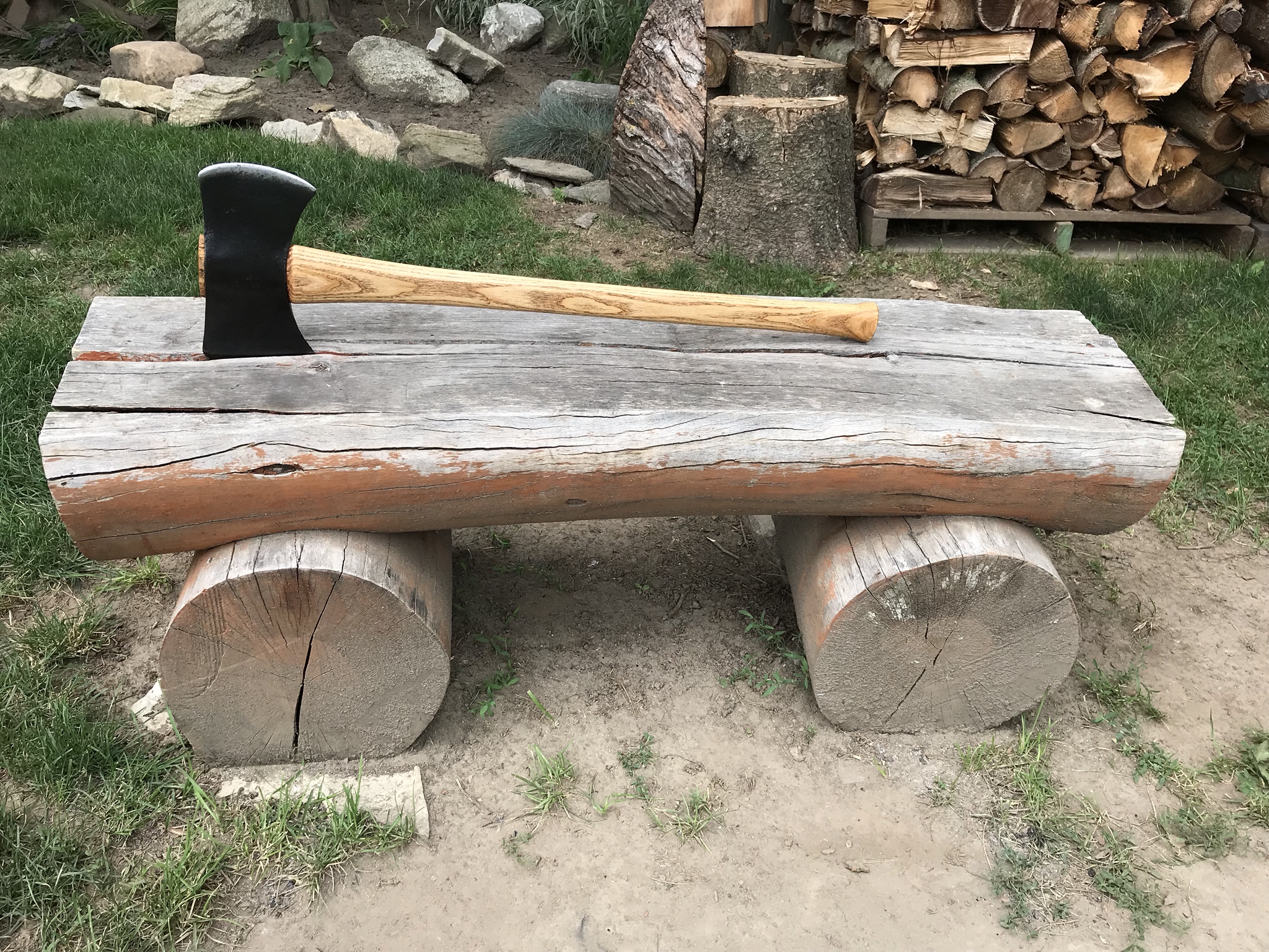

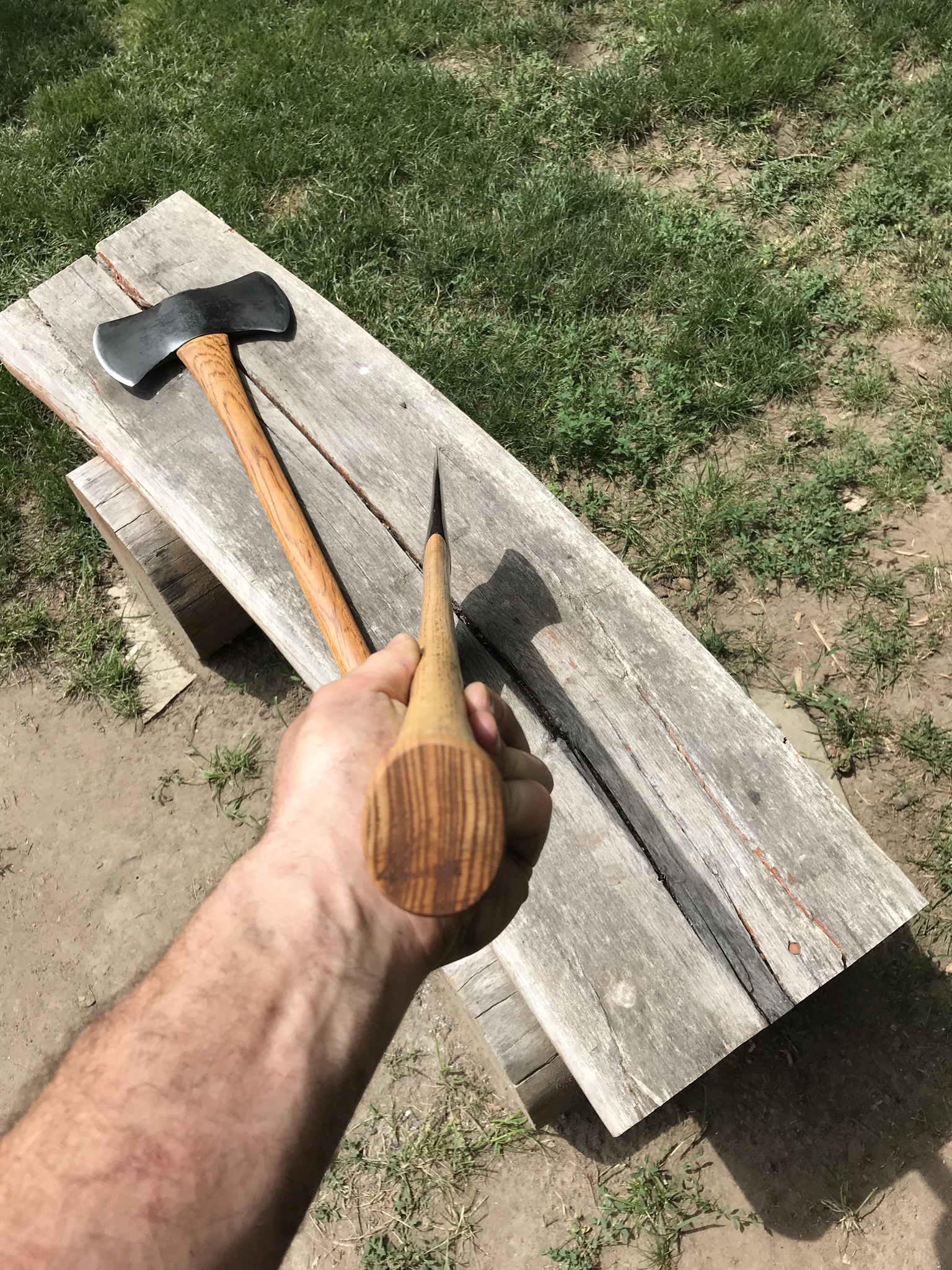

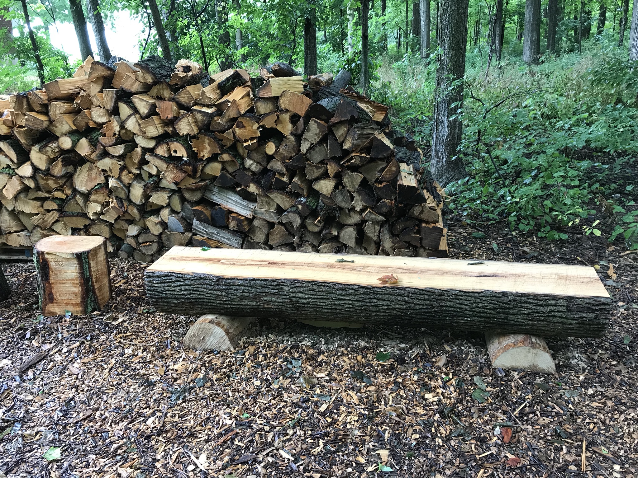

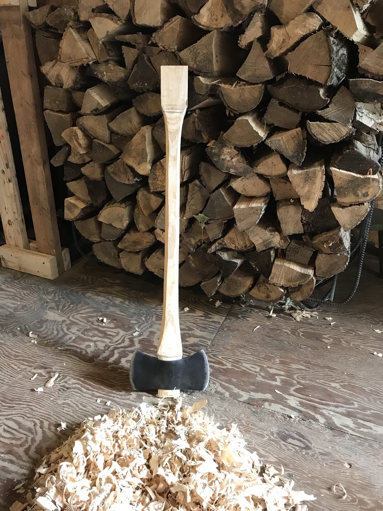

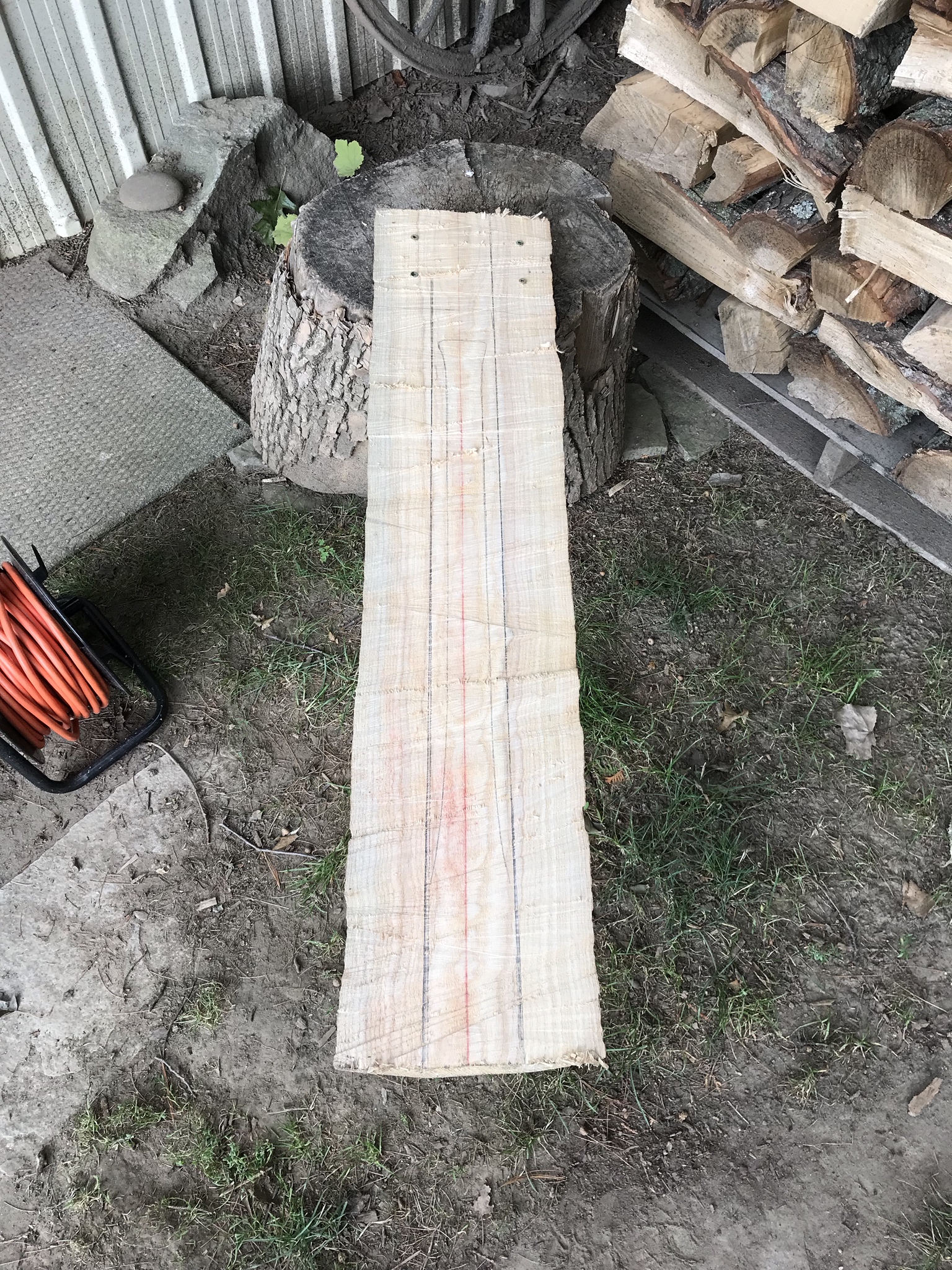

My first attempt at a self made handle. Double handles are hard to get in Ontario, and I intend this axe to be a gift for my dad, so I thought I would try something different and make a handle from one of his own trees. I also wanted to make bench for my parents fire ring anyway so I made homemade chainsaw mill then took some slabs off an ash log.
I took some pictures of the process and also of a jig I made for drifting handles out. The ash is definitely easier to work than hickory!
Really great job man! I appreciate the effort as i make some of my own handles out of ash from my back woods. Beautiful job!

It was a good learning experience using a draw knife and a spokeshave. I found I could remove a lot of material quickly using these tools, but I had to pay close attention to the grain. When it would start to tear out then I had to cut in the opposite direction. Thanks for the encouraging comments, I have a few more heads needing handles!
I like this! You've taken a good old axe that needed some love and given it just the love it needed. Now you have a fine little axe for your efforts.
You are well representing the spirit of this forum.
Thanks Square_peg! There’s something about taking an old tool others may consider junk and trying to turn it back into something usable that’s really satisfying. But, I guess most of the people on this forum know that feeling, lol

Great work there! Making a handle from raw wood is the most rewarding.
Jasper33-great job! You mentioned your draw knife and spoke shave work. When you have to change direction with the spoke shave because of tear out you might look for a old Stanley No. 62 reversible spoke shave. As Stanley said in their 1892 catalog "This spoke shave can be worked to and from the person using it, without changing position" The No. 62 is hard to find, but worth the search. My 62 was my Grandfather's, and it and my Stearns No 13 Universal spoke shave ( it has a flexible spring bottom that allows it to cut flat, concave, or convex surfaces) are my hands down favorites of all my spoke shaves that I use.

I should have also mentioned draw knife guides to help with tear out (also help with octagon helves) There were a number of different makers, but your best bet is a modern Lee Valley Tools #15P20.01 modeled after an original. Their catalog has a good pictures of how it is used.
