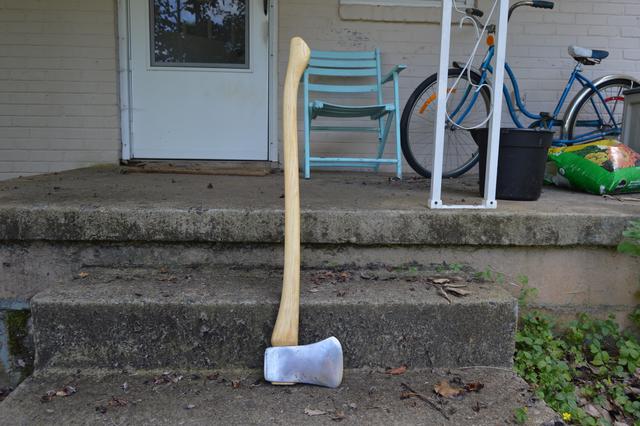

It's been a little bit since I refinished an axe. This was a NOS hardware store handle with an old yellowed lacquer finish. Scraped and oiled, and the head is hand sharpened with files and two Baryonyx stones (the Mutt and Arctic Fox). I love the shape of the head.
The axe is 32" long and weighs a total of 4.5lb.

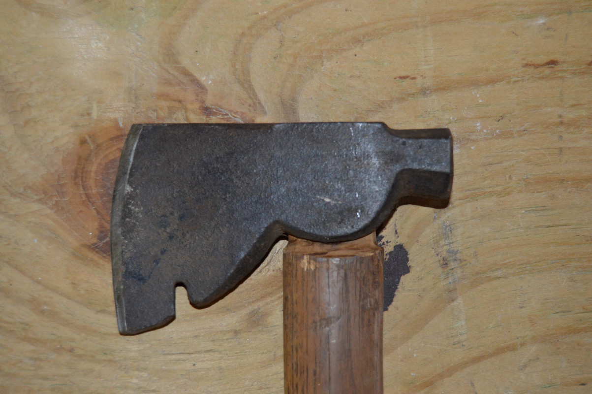

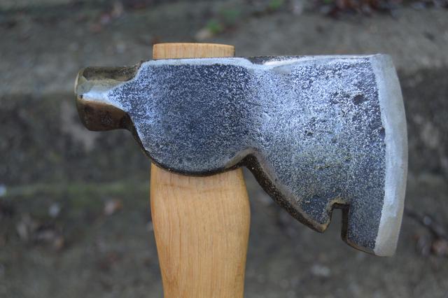

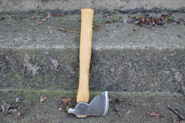

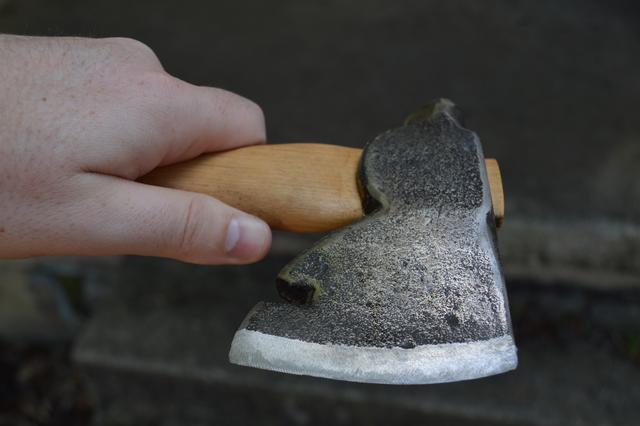

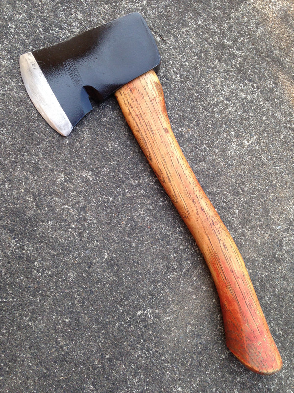

Little half hatchet, loose handle with no wedge that I just popped right out. Refinished this for my uncle, used to belong to my grandfather.
There was some damage to the hammer portion, filed/ground most of it out.
I measured the bit before sharpening, found the angle to be 48 degrees. I assume it was because when I did the vinegar, there was no hardened steel shown. Nevertheless I brought it down to 34 degrees and it pops kindling apart with little effort.

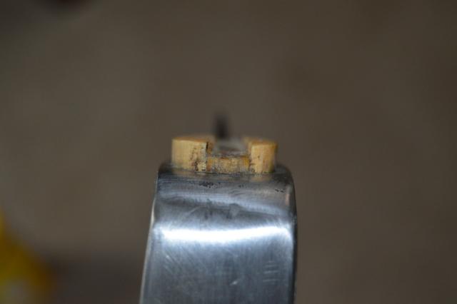

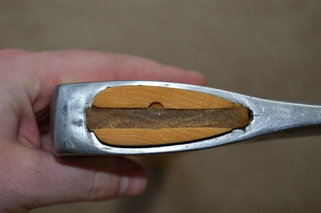

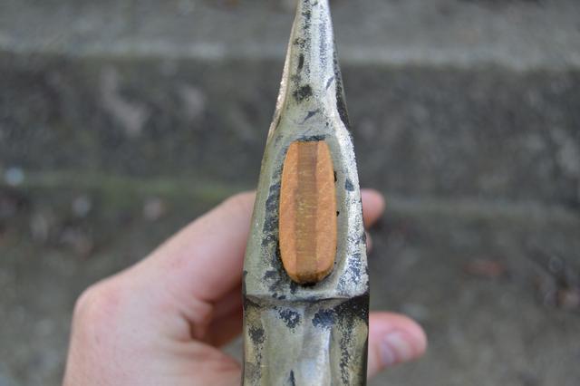

I tried this method without using glue for the wedge, just wet the wedge with BLO and sank it under, then soaked the head for 2 days. Saw someone mention it a few months ago, please let me know how it looks.
