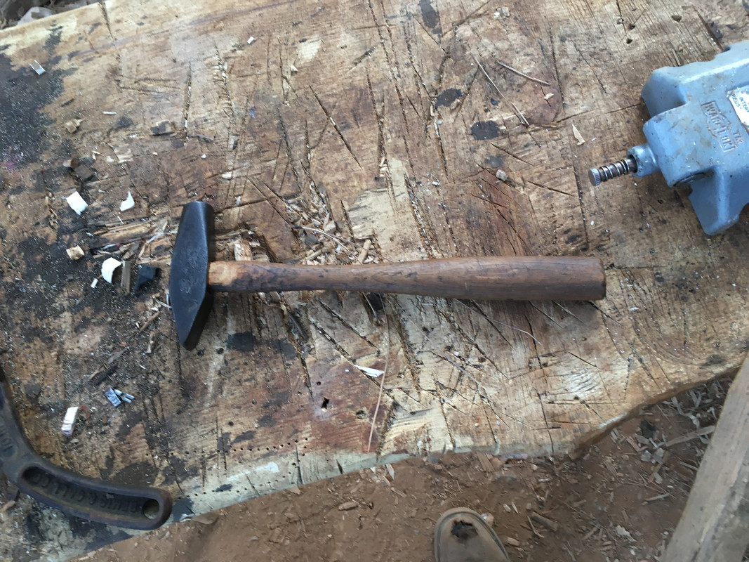

Any thoughts on where I could get a handle that would fit this? The eye is approx. 2" x 1".
Wasn't rehung today but in the past week. My brother gave it to me after he found it with a broken handle. The eye was pretty wide but I had this vintage used handle that had just the right eye size. It appears to be an old unmarked sheetmetal hammer.

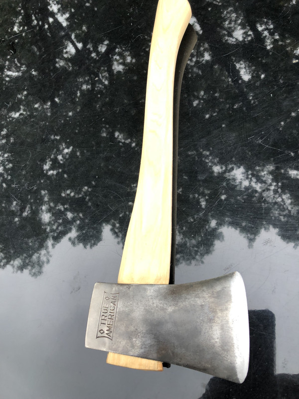

I don't post on here much to begin with, I hang about 3 axes or so every free weekend on average I would say. This would be this past weekend's work, the Autograph in the middle was previously hung, just went over it again. Not pictured is a hatchet I went back out later in the day and re-hung.
