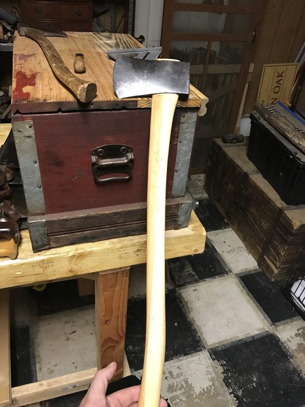

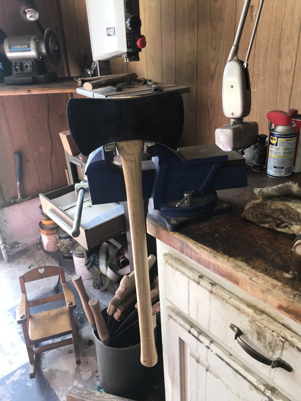

I hung this Woodslasher cruiser on a link handle today. I had to order the handle through my local hardware store. It is a decent handle. It could have been better. But the grain is nice and the palm swell is huge. I still need to take some wood off the lower portion of the handle and fix some chatter marks, but I wanted to post it. Thanks for finding this axe it’s home JB!

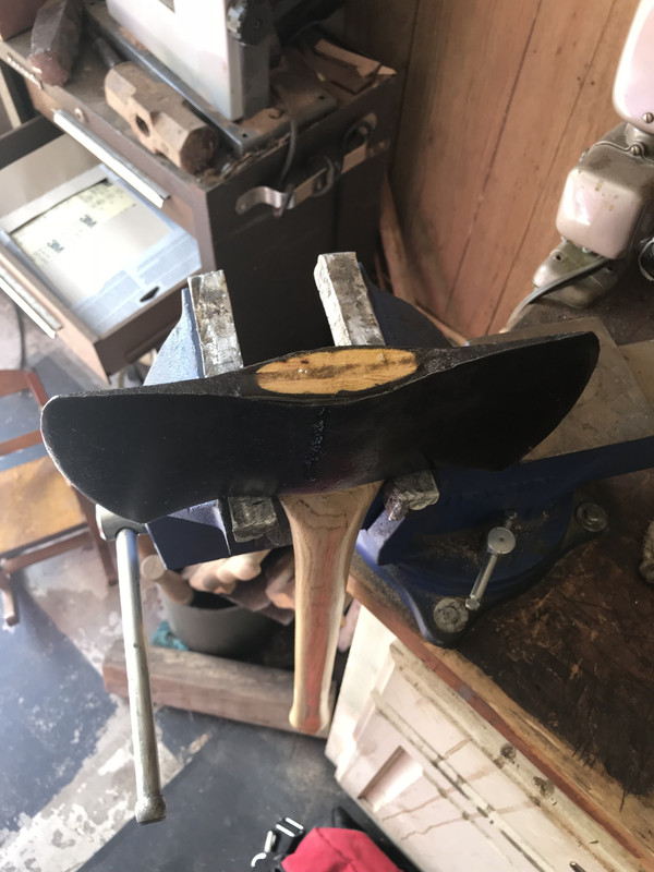

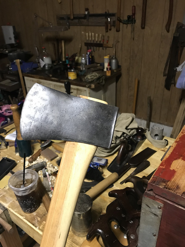

I held out for as long as i could! I've had this nos "dependable" o.p. link haft for a couple months now and I've been waiting for the right head for it. I got this TT Kelly Perfect the other day from my uncle along with a C.H. boys axe from western Germany. I wanted a nos Maine made axe but thought this was a good fit. Best handle i think I'll ever find.
Handle is 30" and the head is exactly 7"x5-1/2". Weighs #3-4.8oz. It's a keepa! They ALL are!! Thanks fer lookin!
