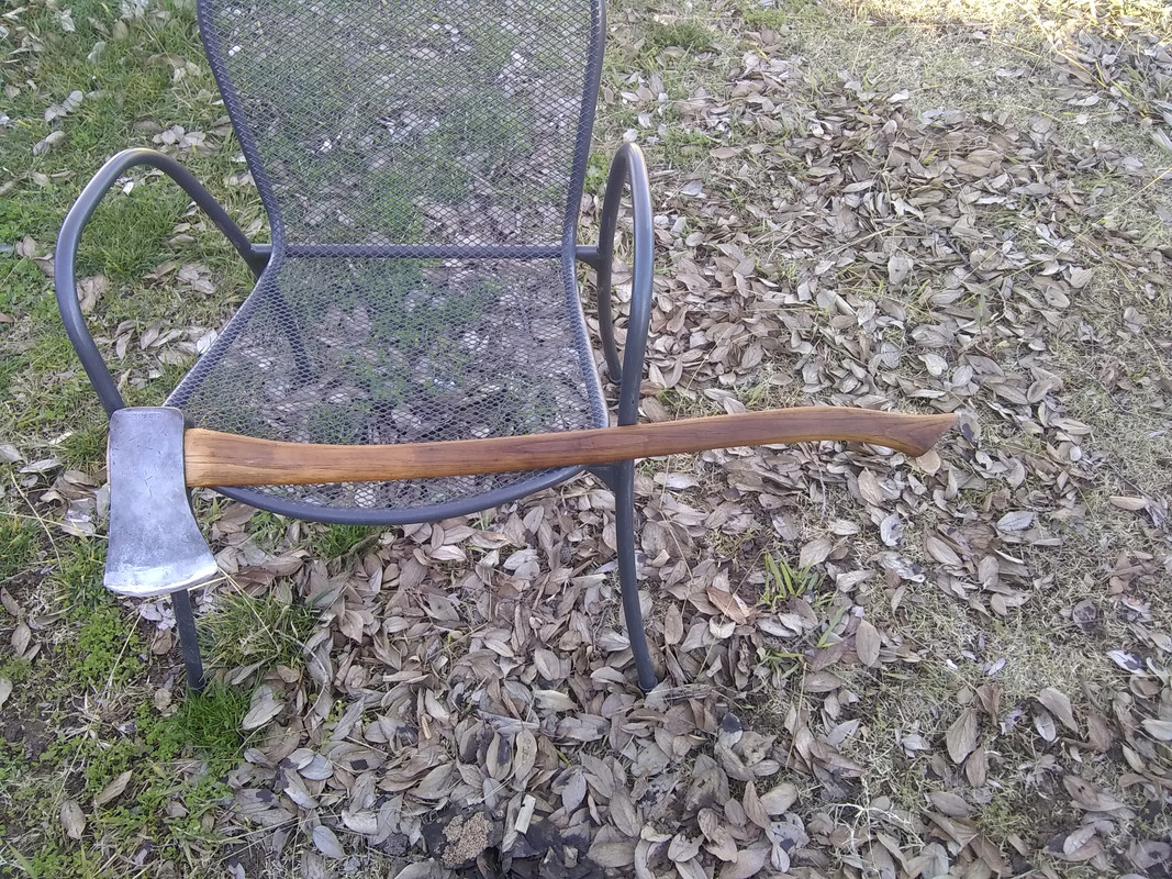

Tidied up this flint edge cruiser today that I picked up over the summer.
Usually it's the top that gets beat up, but this one it was the bottom.
Enough to spall off a piece, but really it's not that bad overall.
Not much left of the wedge, but nothing's really wrong with this handle.
I used this little Jimmy to remove the wedge. It's just a piece of 1/4" with a sharpened end.
Then knocked the handle out easy enough.
Worked over the rough spots and set the bevels, which weren't really too bad
Cleaned up and refit the handle. Before setting it I blued the shiny spots I made.
Carved a quick wedge
Nice fit in my opinion. Just peeled a shaving at the end as I drove it tight
Cleaned up just right. Nice contact, no step.
Here's a few of the end result, after a couple good doses of danish oil, and hitting the bits with a stone.
I guess she's ready to go back to work!
It's ready to rock-n-roll now. The hammerings on the bottom of the axe were from someone trying to remove it. The chip occurred when they hammered too close the the hardened bit.
@muleman already knows this. But I say it for the benefit of someone else who is considering hammering their axe off an old handle.
Or someone had it mounted upside down and kept hammering it down because it kept loosening up
