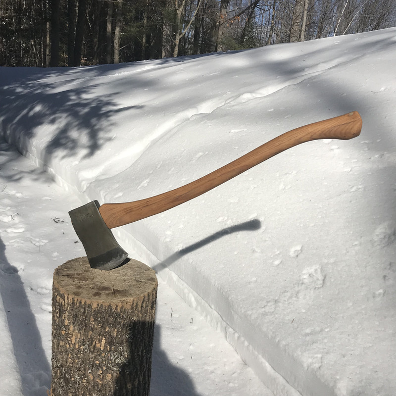

Still too thick? I filed that edge for a couple of hours. I don’t use a gauge, but perhaps should.Curt Hal , the cheeks on your ax (post 5217) are thick. Hang looks good. DM
Don't see any photos...Still too thick? I filed that edge for a couple of hours. I don’t use a gauge, but perhaps should.
Oh i see. I thought you had filed it again since that photo. That would be fine for splitting, but for falling it ought to be thinned out a tad more. You'll have a much easier time. I haven't purchased a gauge yet. I don't know how many dozens of axes I've filed but after awhile you just get the "hang" of it.

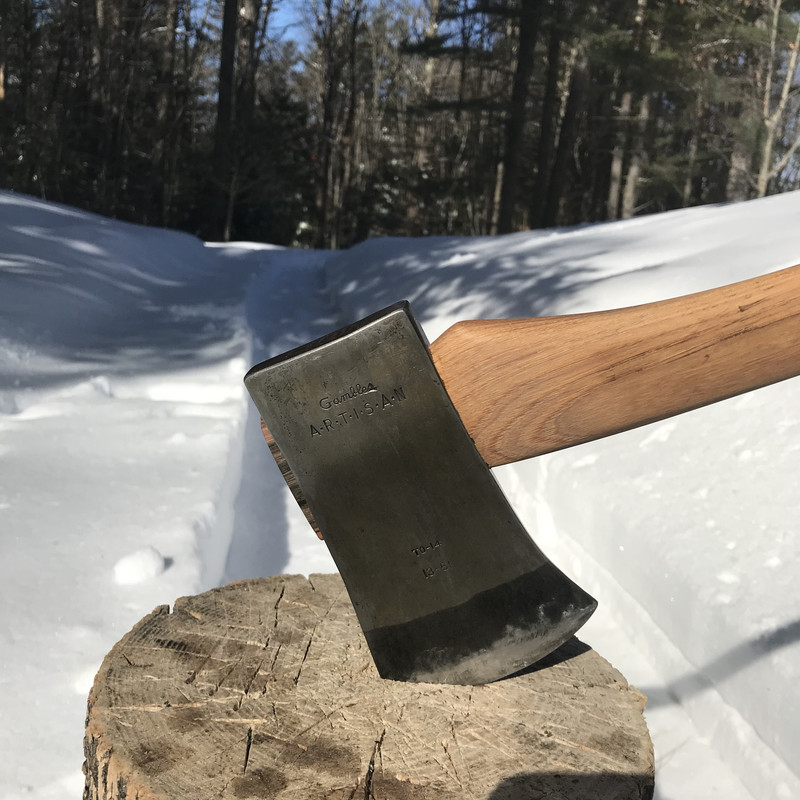

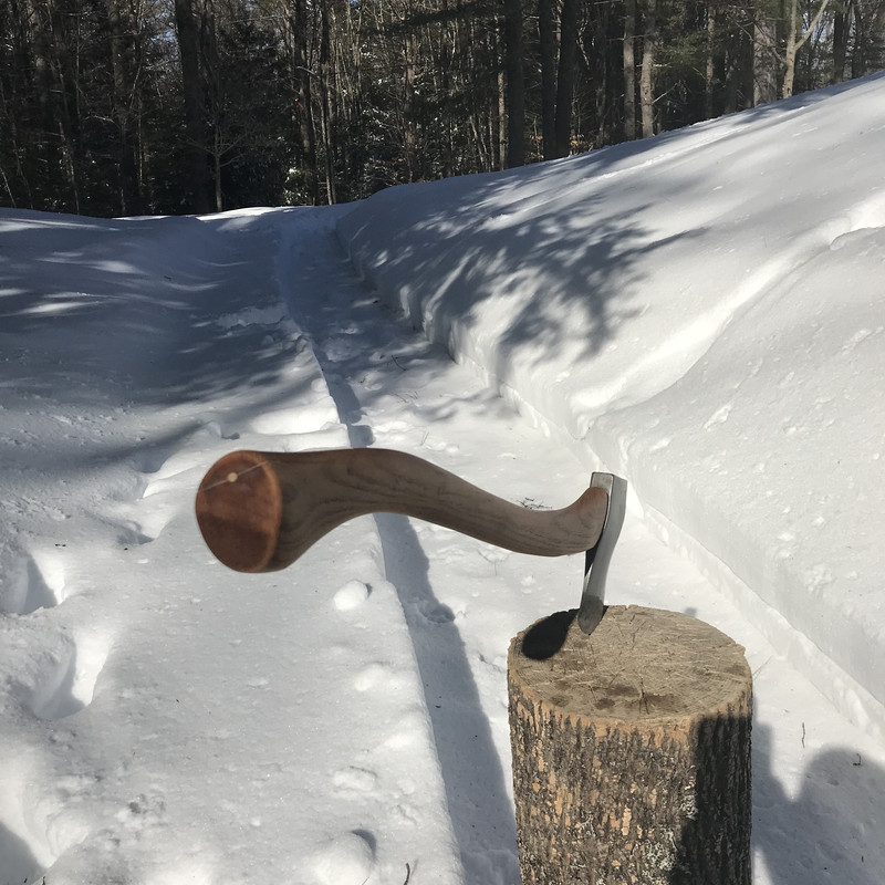

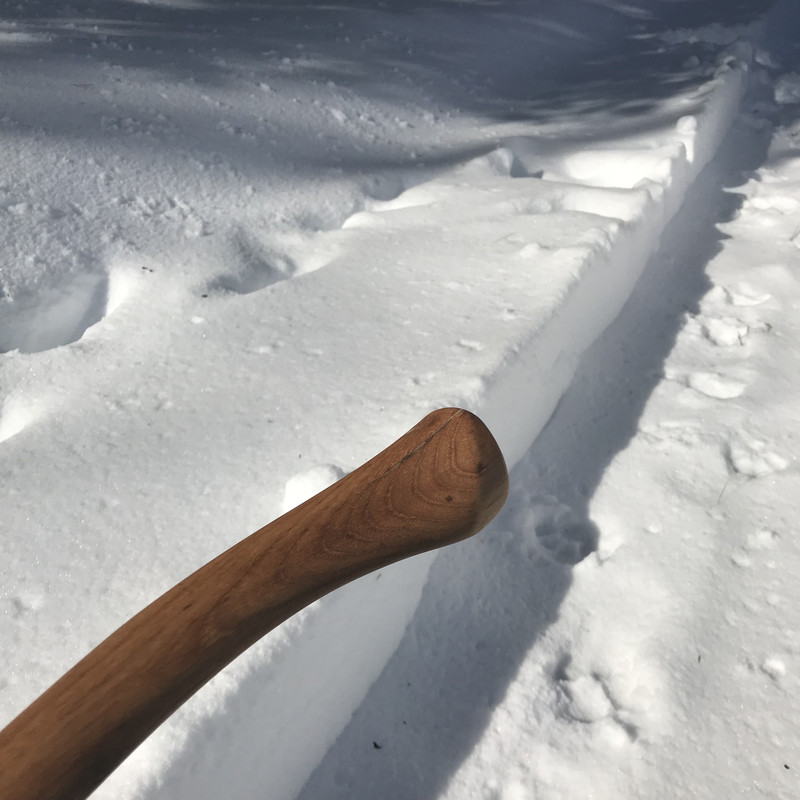

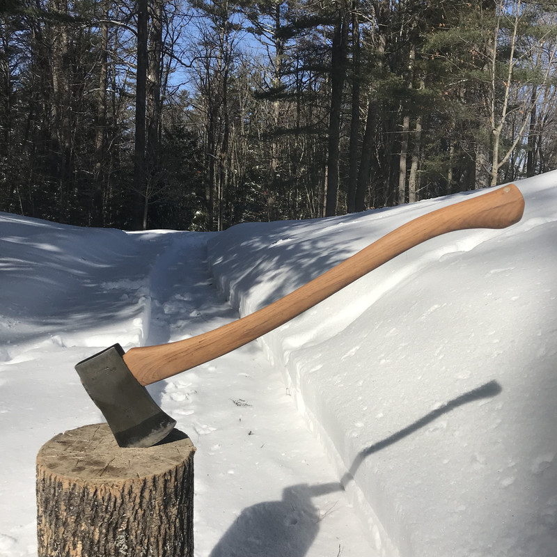

Love the handleIt's an East German head, close to a Yankee pattern I'd say. Here's a better picture and some of the whole axe.
Thanks, I spent quite a bit of time working the swell to fit my hand and be comfortable swinging for a long time. I wanted this axe to be sort of a template for future handles so I have something to go off of.I like the shape you put on the swell of the straight handle - something to stop your fingers up front and relaxed on the back to try to avoid a hot spot![]()

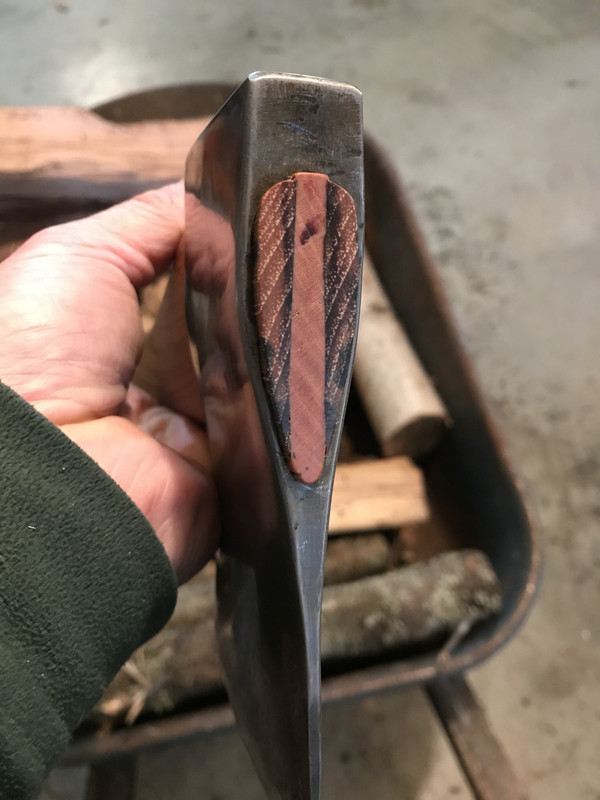

Hard to say. When I got the head it was in very good condition and the poll had basically no wear. Not sure if that is because it wasn't used much or because it is hardened. I've only ever struck the poll with a wooden mallet, but I don't see any obvious forging line.Some good photos. Nice ax. Do you think the poll is heat treated? DM
