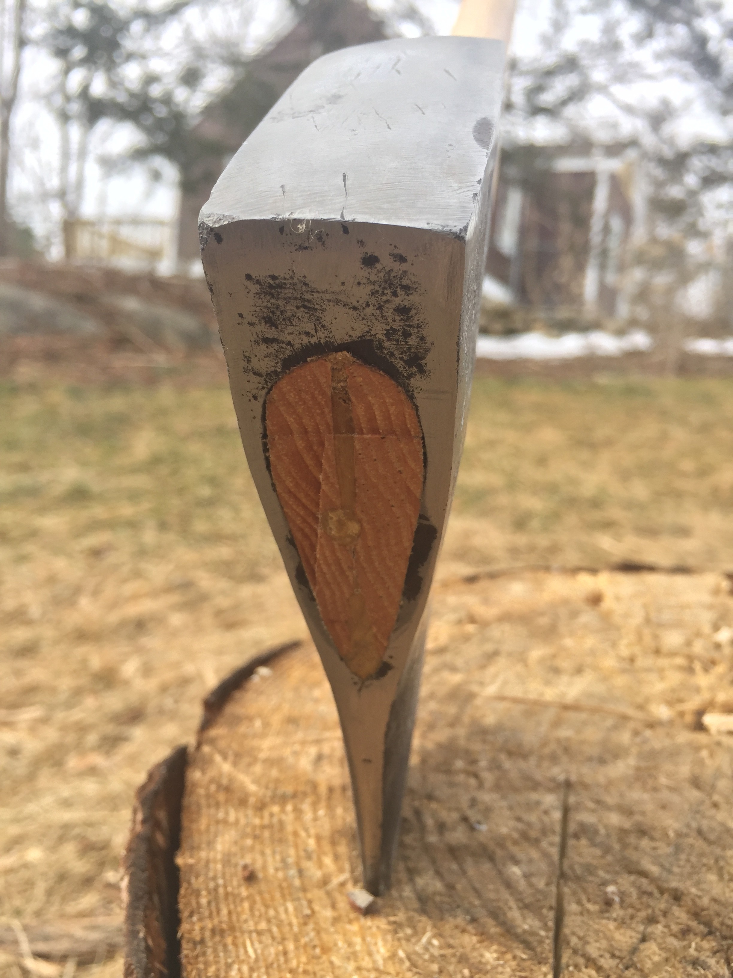

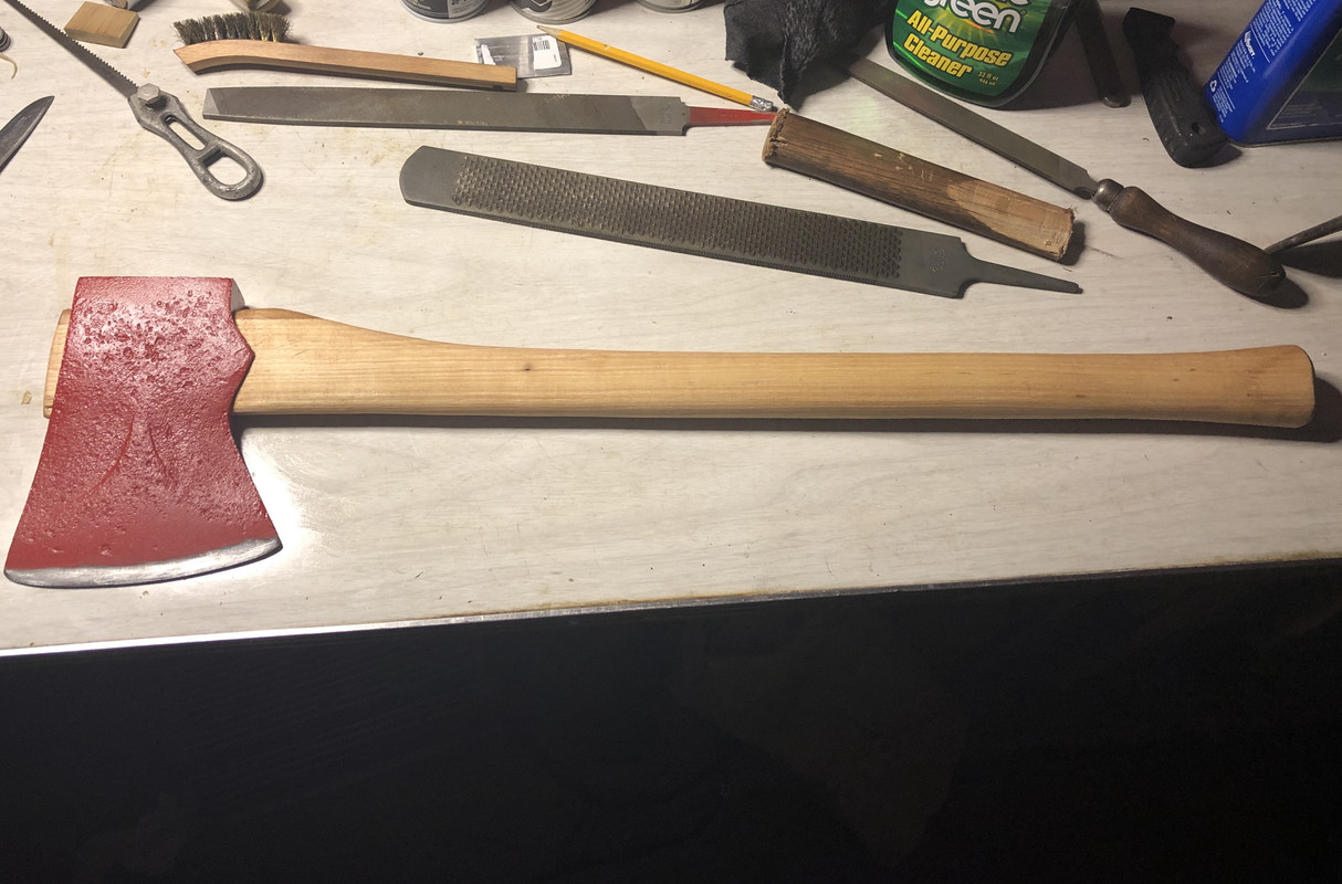

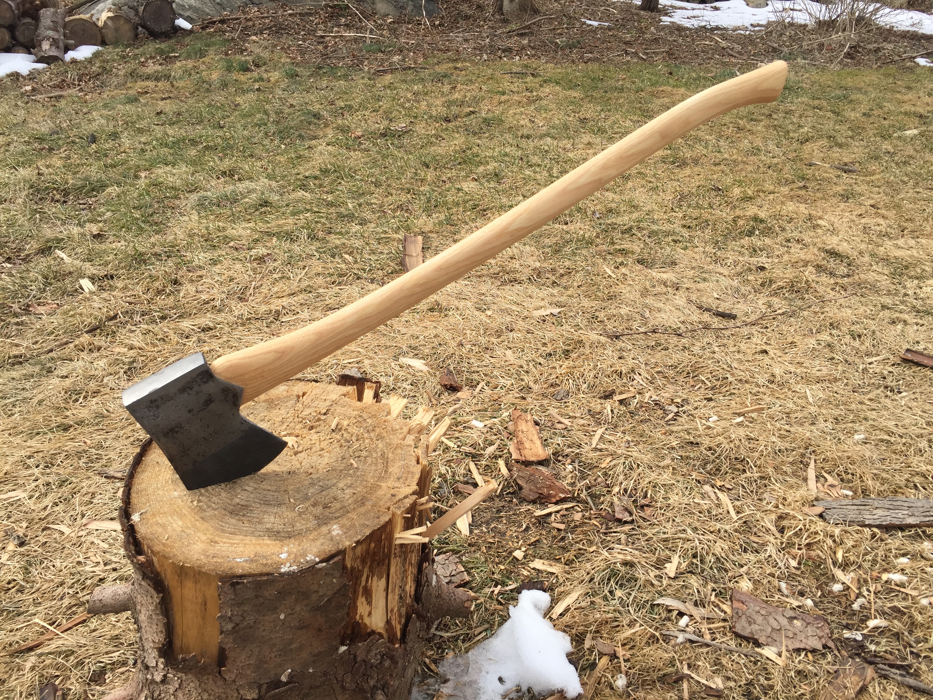

Love this thing. Inclusions were deemed acceptable upon close inspection. I could've shave it out, but I like this one meaty. The wood is insane, it's out of a thick board i think I've mentioned before that was very, very tensioned. It was a big board, it bound their (Woodcraft) saw with an upward warp when they were cutting it with a Festool miter saw, lol. And then on my table saw it pinched like a mother. I think it might be from a very, very large limb or severely bent tree. I think this is going to try out for camp hatchet, though.

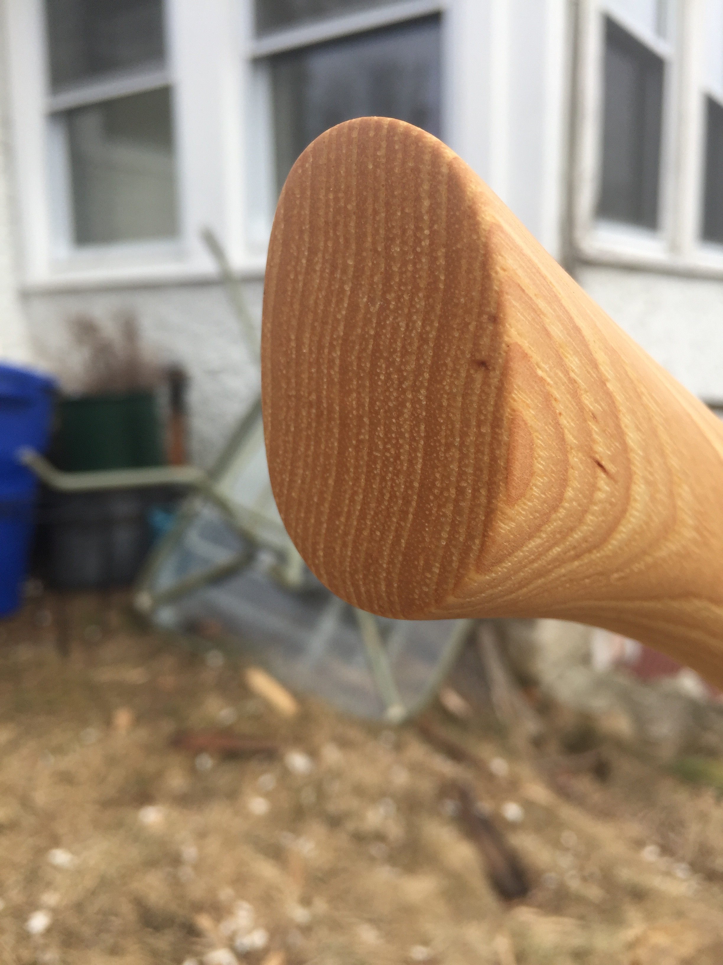

The wood has chilled out and has a great timber when knocked. The haft is octagonalized to the grip, You can see how parallel the grain runs both edge and flat. I rived a stave out of aforementioned large board and it worked out good. 16".

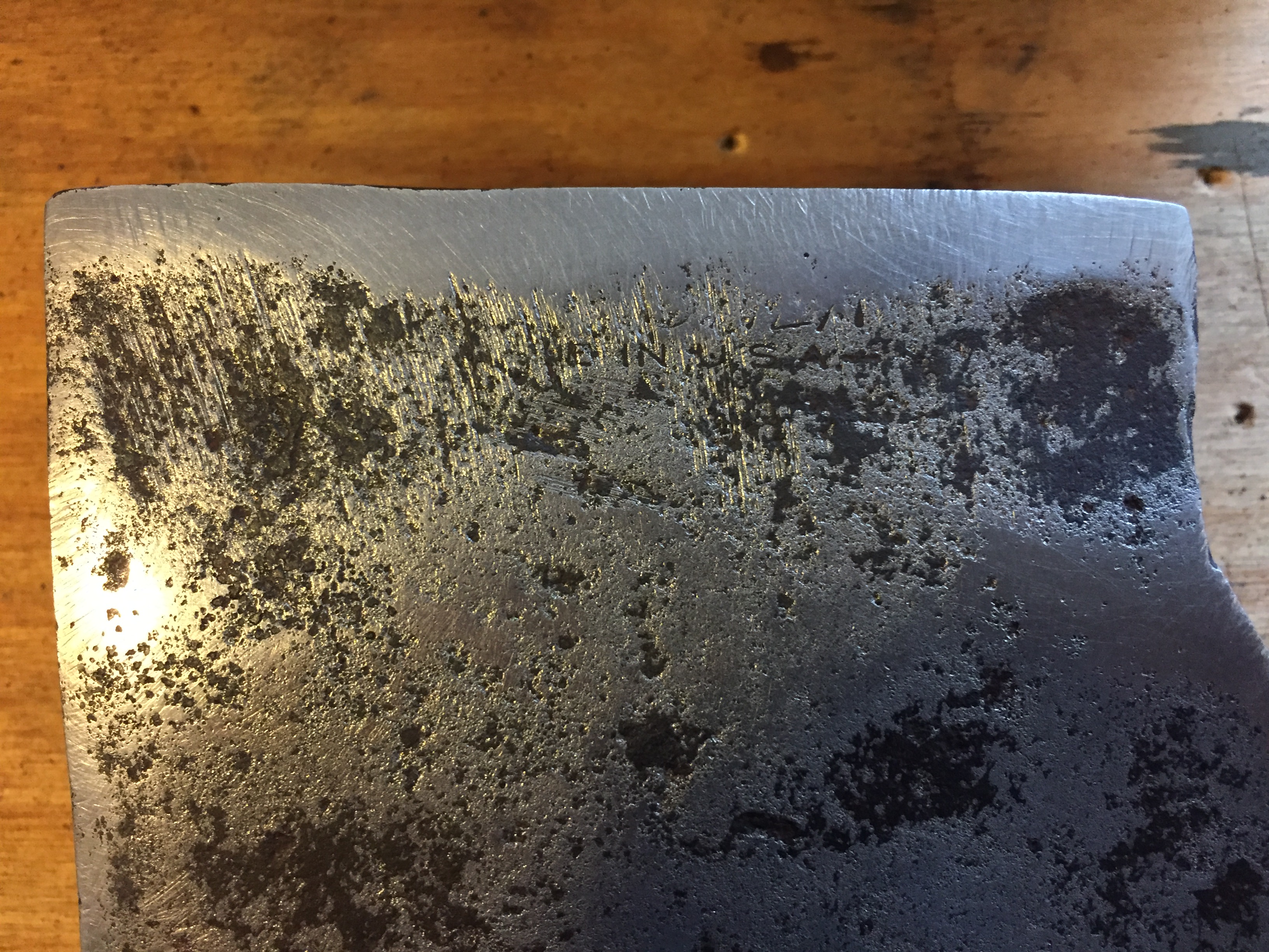

The head was in fantastic condition, steel feels real good under file. No idea of the vintage but the oxide later is very hard and substantial. I like Plumb steel a lot, too. I very, very excited to get to know this fellow. I'm happy with how it turned out.
