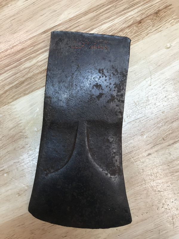

I appreciate your craftsmanship in retoring those but I think those might not be worth the effort. The one with the failing forge weld has likely lost the last of its high carbon steel. The chipping pattern on the 2nd one suggests a bad heat treat. Your considerable skills might be better used on less used axes.
I say this as much for the benefit of the forum as for your benefit. I like to pick my battles.
I certainly appreciate the kind words and your point of view. This head was more a challenge, learning experience and effort for myself, knowing any mistakes made with a heavy hand, I could justify due to the condition I started with.
I felt I would have a good user, till I hit the peeling...than I just needed to follow thru and finish regardless with hope and optimism driving the 2nd filing.

That haft is definitely oak! I don't think any other American wood has such strong rays. Could be wrong but I haven't seen it. Great job man I can tell you put a ton of work into them! I do agree with SP though. I've learned to save my energy for ones that have a lot of life left.
You must've run into the spot where the dissimilar steels met. Is that what you think? I've never seen that before! Interesting...
Yes I came upon that junction of layers and peeling. Not a happy place to come into, however I wanted to file thru to completion for the axe, my effort but to know what it looks and feels like filing.

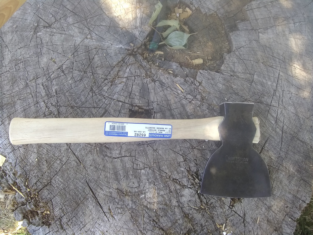

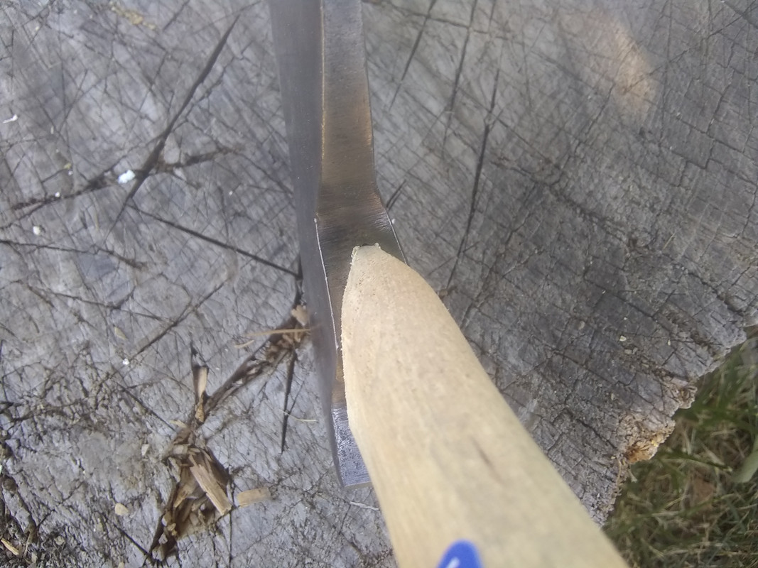

I finally got a handle for the pre 70's Vaughan / Craftsman AgentH sent me.
I went with this fat link handle so I had room to work with.
I had a perfect fit and it was slated to be my best hang till I pounded in the stupid step wedge.
The wood is cracked but the hang is still good I suppose, I'll slim the handle later.
I had dreams of carving a handle for it, but realized I'd probably want to have it in carving handles when I ever go for it.

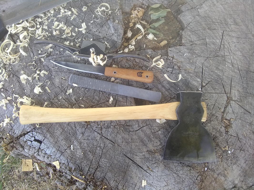

I'm still not very proficient with the spokeshave yet and got a bit carried away, the handle is a bit skinnier than I'd like but it's not too bad.
Maybe I'll try lacing on a leather grip or something, I generally don't like anything but a bare wood handle but it could work here.
I like using that style of hatchet. Thin is good as long as it’s comfortable.
I’m glad you are enjoying that one. That shape head doesn’t discriminate against left handers!

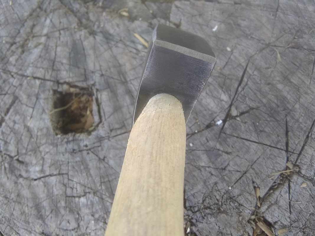

Hickory n steel- I hope you are a lefty, because you set up your Craftsman broad hatchet to use left handed. Holding your hatchet in your left hand and the stave to be worked in the right hand, the flat side is facing the stave.
Enough said about using steel wedges.
Looks like Agent_H beat me to the left hand comment !
Certainly not.

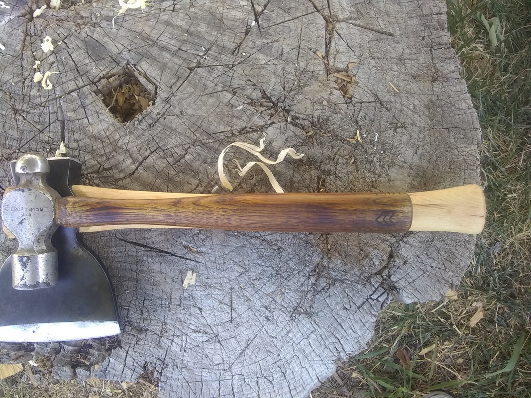

I decided to go with a slightly rear curved handle like you see on riggers axes some times as it's something I've wanted to try.
Oh and this handle was $1 less as a larger older locally owned Ace a couple towns over, $15 was still kind of high for this but it beats $16 :D

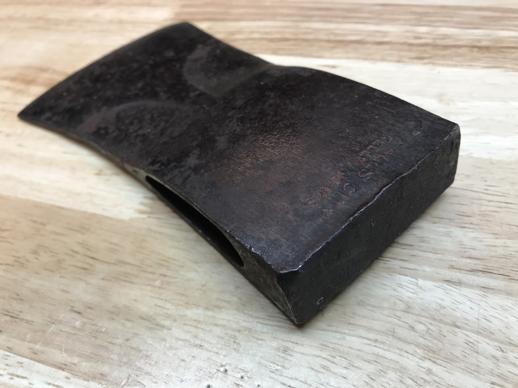

This hatchet only has "drop forged" stamped into it. Temper goes back to the nail slot. I've lucked out again and got another one with awesome hardness. It's just right. Takes a long time to file but not so hard that I'd be afraid it would chip. It was made to be used!

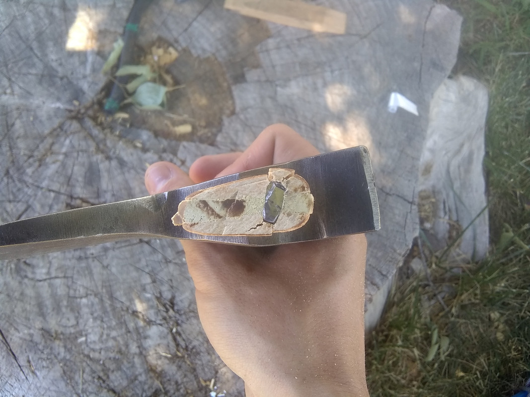

This eye had minimal taper but it does have some. A 1/16th larger in either direction at the top of the eye. So I left it proud by an 1/8th to compensate. Wish I had a hardness file kit. I'd love nothing more than to be able to report a closely estimated hardness with my posts here. Saying "the steel is hard". Or "the steel is very hard" doesn't really convey what I'm trying to describe. An HRC number though would really mean something! Anyway have a great day all!
Got it hung! Ended up using a TT woodslasher haft. 30"long now.
There's 3/4" of contact up inside the eye on the bottom.
You can see the dimples from where the woodslasher's grooves used to be. Also it appears someone maybe used a cat's paw to try to remove the metal cap wedge at some point?
Here's the other side. A 6 I do believe. 15613978898896413291897723909927.jpg
I cut the tongue flush as I always do but afterwards I re-blued the steel on top.
Not bad for 20 bucks! Haha. Hard to find deals like that these days! Have a great afternoon all!
