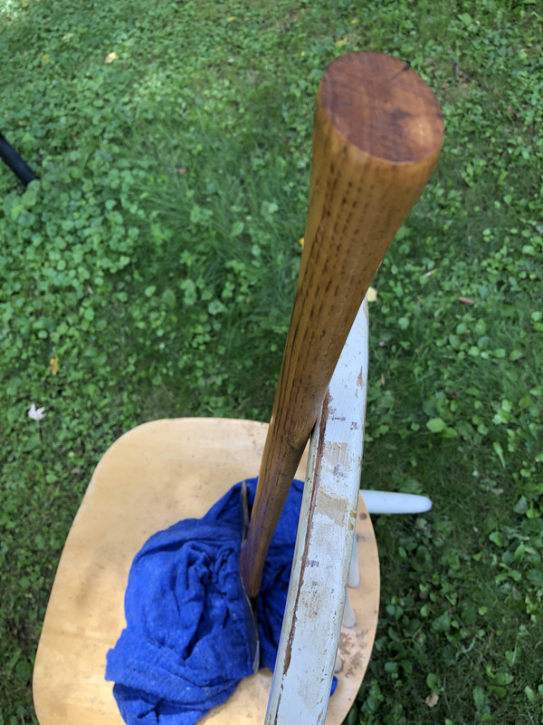

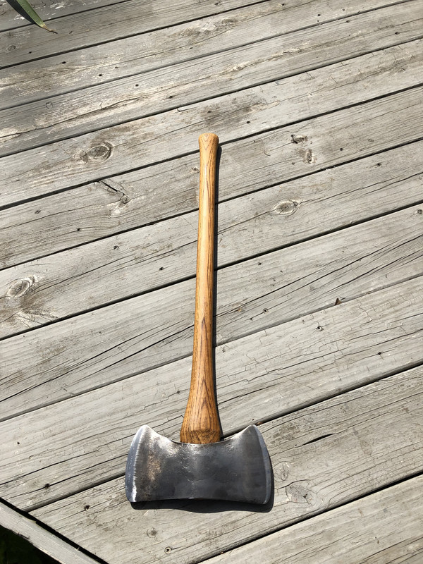

This post will be a little picture heavy, but I wanted to include some progress pictures as this axe came together.
This axe belonged to my wife's great-grandfather. As a teenager he lost his left arm in a hunting accident so he used this 1 1/2 lbs Hults Bruk which he could still swing with one hand. The axe was later inherited by my grandfather-in-law.
We were having a conversation about axes one day when he mentioned his father's axe needed the handle replaced. He showed me that it had warped considerably from being tightly wedged against the side of his four-wheeler for years and had also recently cracked. I offered that I could carve him a replacement. He mentioned that he thought it was original, so I decided to try to reproduce it's pattern as closely as I could.
I traced the pattern onto some white ash. The eye had mushrooming at the top and the bit had been ground unevenly on a bench grinder. A good amount of filing reprofiled the bit and fixed the eye. I used a brass brush to rid it of some surface rust which revealed remnants of the original blue paint. Finished it off with a yellow birch wedge and multiple healthy coats of raw linseed.
When I returned it to him he was very surprised and a little emotional. The axe is clearly important to him and I was happy to bring it back to working order. He said he wanted me to have the axe after he passes on, and hopefully one day it will find its way into the hands of a young person who will know that it belonged to their great-great-grandfather.

Gorgeous! Beautiful work and such a great story too. It's nice to do a project that has special significance to your family. I've done similar things before and it's gratifying. Thank you for sharing your story and fine work with us!
Edit; I wanted to add isn't yellow (or white) birch AWESOME for wedges! I find it far and away the best wedge material I've found.

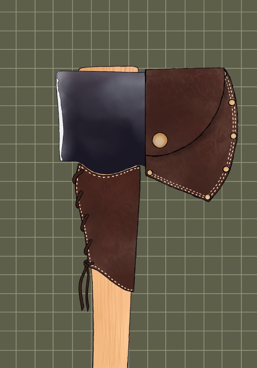

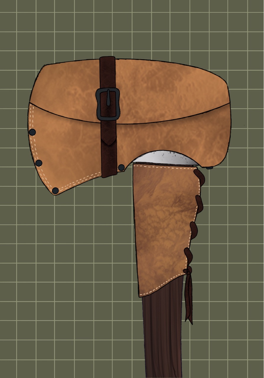

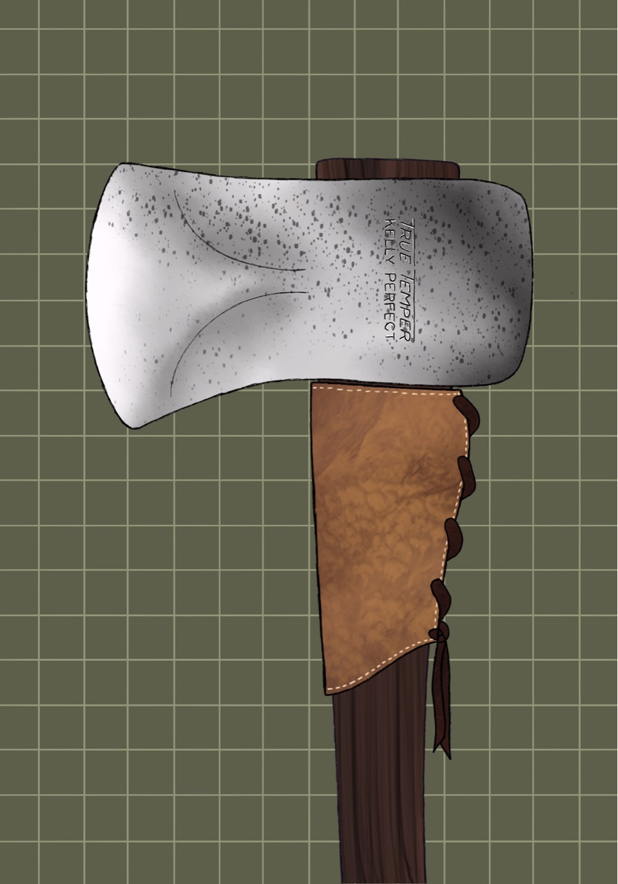

I'm curious: does anyone here ever sketch out what they're planning while getting started with or working on a project? This is the sketch I did of the axe I posted photos of a couple days ago. The axe is finished but the mask is yet to come.
The drawing was done in Procreate on an iPad Pro. If you want to get real nerdy about which brushes I used and all that jazz then we can plunge down that rabbit hole ;)

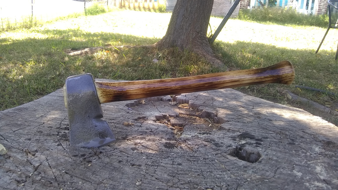

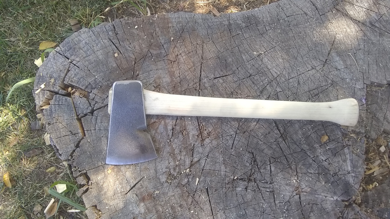

It's done, and it came out to 14" exactly.
I decided to go a little bit different with this one, nothing crazy though.
I went with a straight handle, but I don't like the look of a regular hatchet with a hammer style handle so I reshaped it more like a traditional straight axe handle.
I also rounded off the top and bottom of the head as well as the poll, and besides that you can see I gave it a fairly closed hang.
The whole torched look is something I've gotten away from, but for some reason I decided to torch this one a little bit.
I'll need some time to decide, but I may end up giving this one to my 16 year old cousin.

It looks from the photo like the handle curves backward slightly. Is that the case? If yes, is was that intentional? Personal preference or functional reason?
Just the angle of the picture and the taper up to the shoulder creating this appearance.
I did that not too long ago for a single bevel hewing hatchet and like the feel, but I don't think it would be that great for a normal hatchet.
I tend not to go to far outside the box with axes and stuff.

Right on, looks great! The straight haft really makes me want to pick it up and use it.
I think you have yourself a great little user, for you or your cousin.
