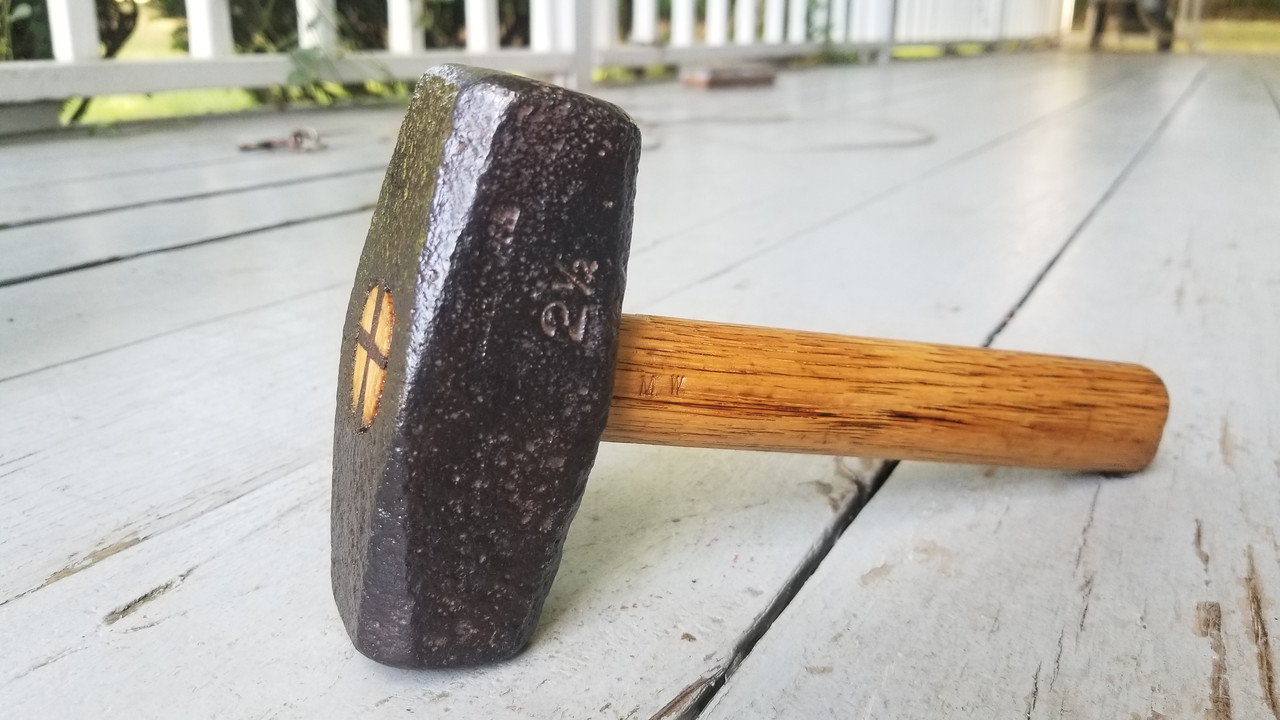

Wow! Great ingenuity!I'm not done with this one yet. But I did hang it today! I've since steamed and bent the helve and it's currently drying and cooling. I was pretty disappointed that the back end of the shoulder didn't fill out the back of the eye. I thought I had enough material to do that otherwise I wouldn't have used this haft. But I'll shim it and make it work.![]()
Now for the dreaded gap... It's a real tight hang everywhere else so it'll be alright. It's just a bummer![]()

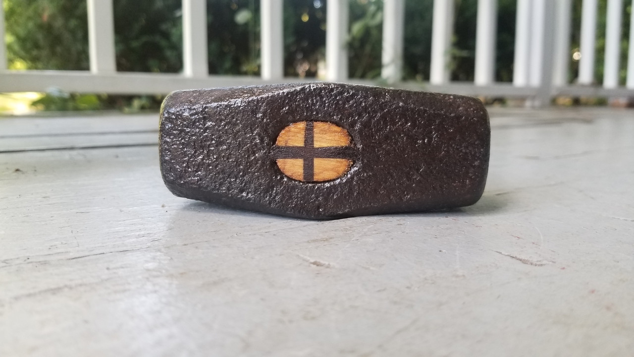

Didn't have a chance to wedge it tonight, but I like how this $1-flea-market-find, kinda-gnarly, 3lb Dayton that I think is a Plumb turned out!

Fmont , perma-bond won't pop, it'll just work loose. I had a Plumb boy's axe that was perma-bonded that had the bond stop bonding as well and the head just started getting loose. A lot of drilling, a little rasping and a little sawing later, it has a Brian Rust black walnut wedge and isn't going anywhere fast. The full process is shown here: What did you rehang today? | Page 263 | BladeForums.com

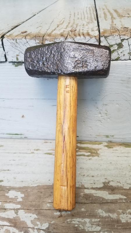

I hate hogging the thread but here goes anyway. Two posts in a row as I hung two edged tools today. Up first is the old W. CAMPBELL broad axe. Here's the shim or wedge I made to fill out the back of the eye. Didn't glue it just drove it home.![]()
I ended up with a 2-7/8" offset on a 24" handle. It's hard to get good shots of an axe with an offset haft! Probably would've been easier on a bench.![]()
The lugs have total contact.![]()
Not sure when I'll get a chance to use it but you can bet I'll share the results. I'm looking forward to it because it's lighter and I think it'll help me learn technique before moving on to my 6 or 7 lber. See you in the next post! Thanks!![]()
