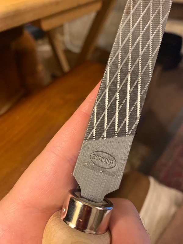

I'm very fond of Simonds Multi-Kut pattern.
http://www.simondssaw.com/handfiles/Pages/Items/73244000.aspx
The current stuff is made in China but it's not too bad. If you can find NOS American made Multi-Kut files then you'll really have something! Heller made the pattern first and a NOS Heller is the cream of the crop. Heller was bought out by Simonds decades ago. Sandvik offered this pattern in a line made in Portugal. Those are pretty darn good! I don't think they're still made.
Here's a closeup of the maker's mark on the one I got. The pattern looks very much like the Simonds you link to.

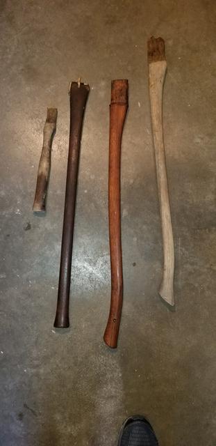

Something that works well for me when I pull a axe haft, I first pull any of those damn metal wedges-there are some great techniques already shared here. To relieve the wood wedge, I drill it out with a tapered twist bit. The bits I use are a part of wood screw countersink bits. They come in different sizes so you can match to the wedge size. I remove the countersink collar and use just the bit. This will do little , or no, damage to the kerf in the Hickory haft because of the tapered profile of the bit. I bought the ones I like about 20 yrs ago. They are marked -FULLER, HS, USA and then the size. I also used these bits when I rehung some late 18c- early 19c tang wood chisels with some new Koa handles.

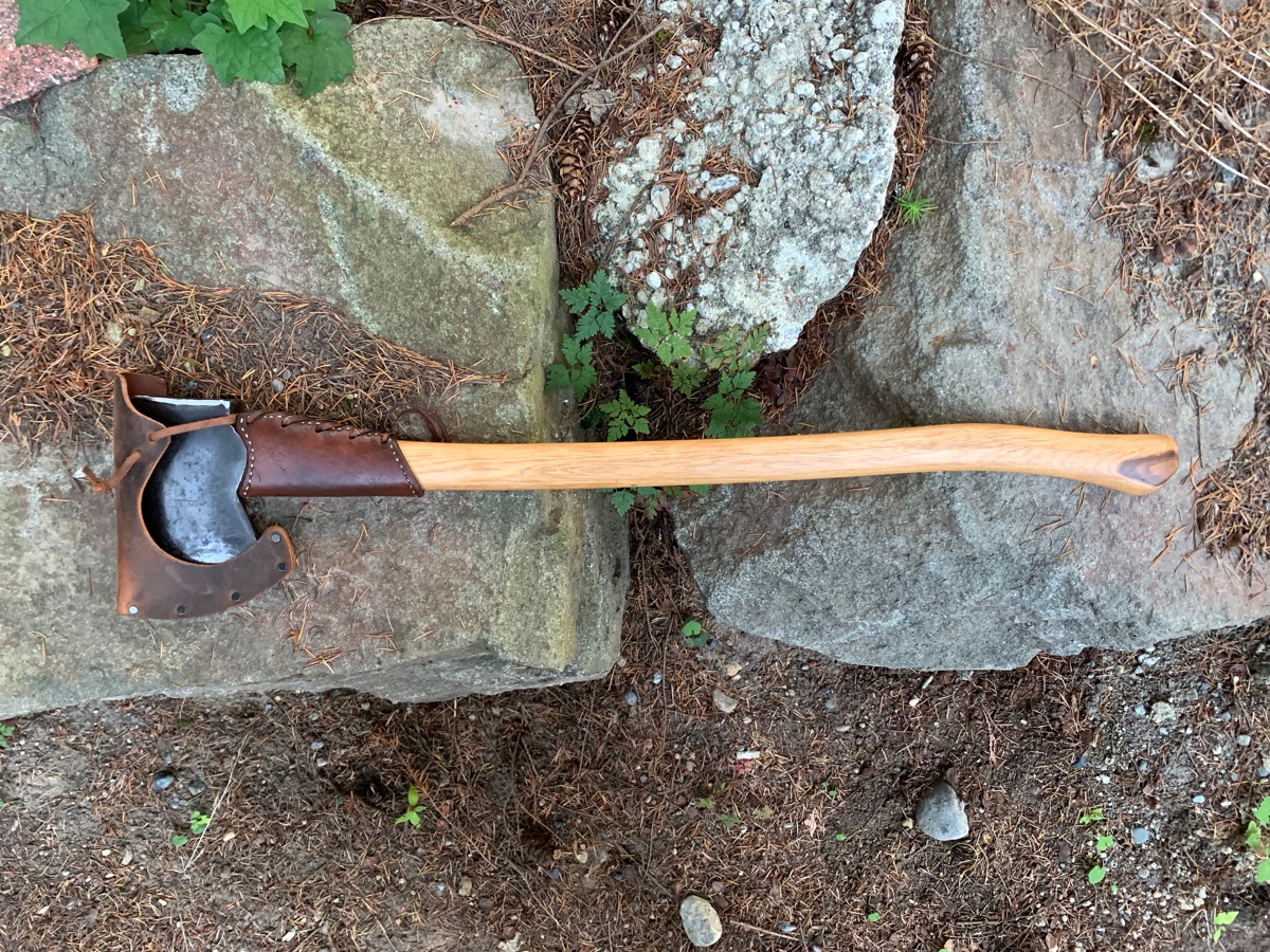

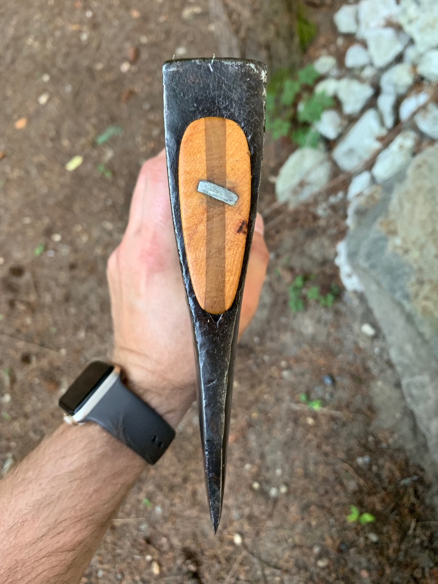

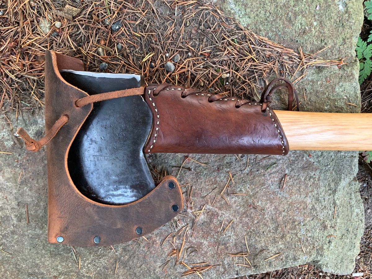

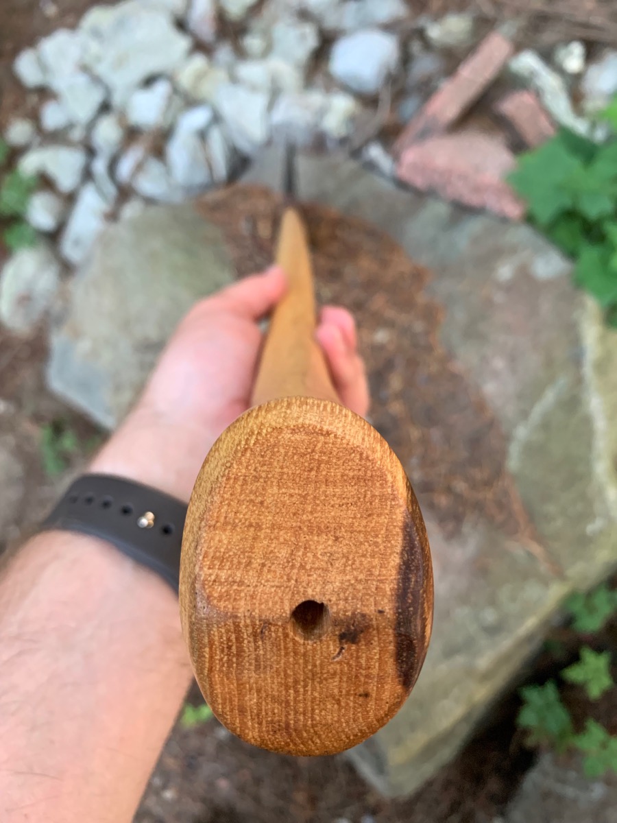

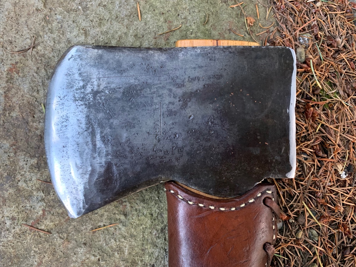

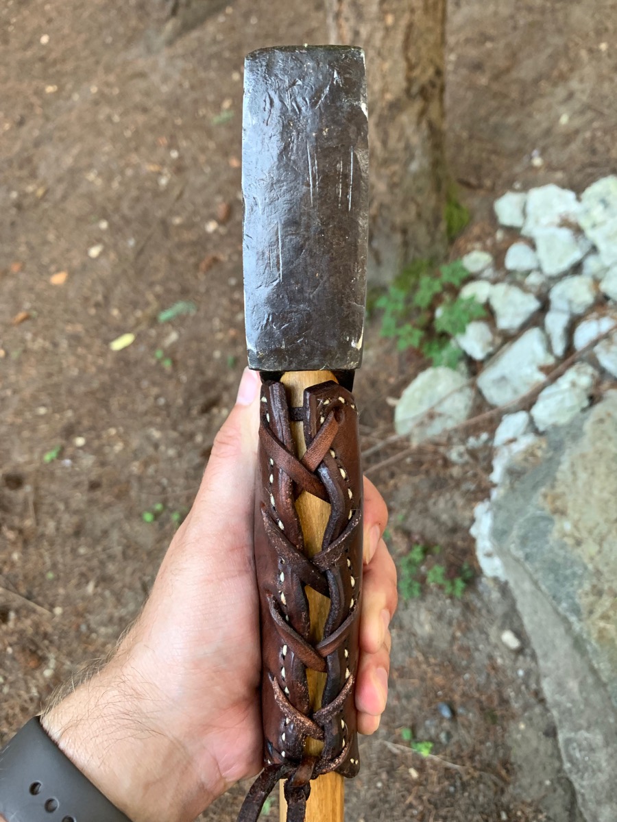

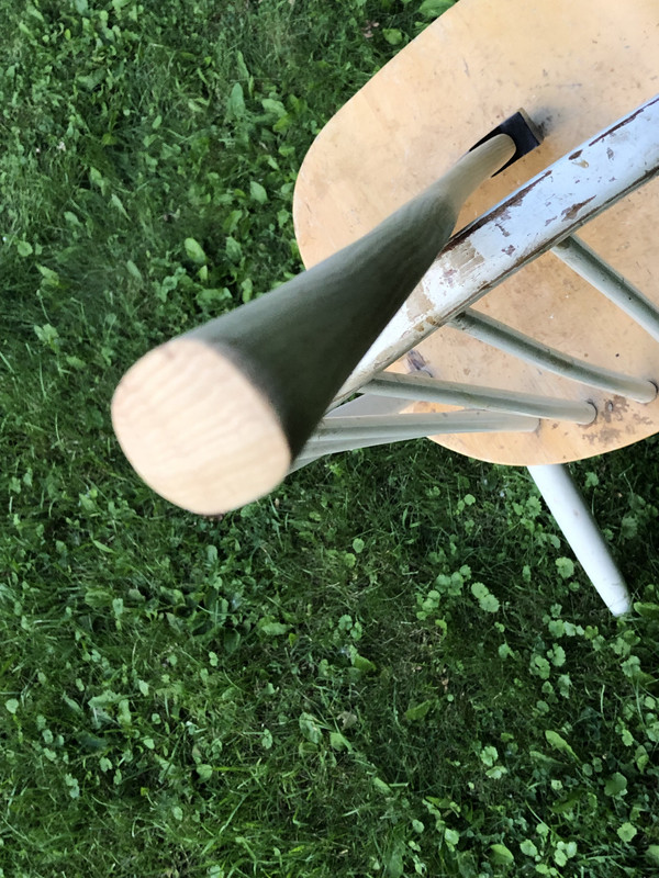

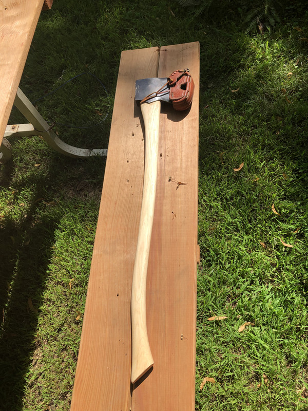

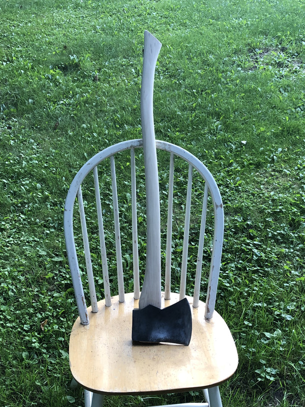

All right, well it's time for me to share my first project. This is an axe I've been working on for a couple of weeks, and that I did most of the work on before I found this thread. If I were starting it right now, with everything I've learned from you folks, I'd do a few things differently. Nonetheless I'm pretty proud of this piece. This is my first time hanging any sort of tool, let alone an axe.
It's a single bit Plumb, weighing in at about 3.5 lb. for just the head, and at about 4.5 lb. for everything assembled. It was listed as a Rockaway pattern, but I've picked up from some of things I've read from you all that Plumb's rounded lugs could make this a Jersey instead. If anyone can provide a proper identification I'd appreciate it. The head, when I got it, had a pretty ugly grind that looked like it was done with a power tool, and some fairly bad mushrooming on the poll. The latter I filed more or less flat, while the former I sort of remedied with files and stones. It's not the prettiest grind, but it is sharp and I'm looking forward to testing it out. There's an interesting triangular stamp in the head, opposite the Plumb logo, that I'd be interested in knowing the meaning or origin of if anyone knows. The head is mounted on a 36 inch, curved haft from Tennessee Hickory, which is coated in about seven layers of boiled linseed oil, and everything has been treated with a beeswax, carnauba wax, and citrus oil mix. The leather strike guard is something I made from scratch and wanted to include for a couple reasons. For one, I just like the way they look. Second, this is going to be a trail work tool, meaning it may be overstruck either because of inexperienced hands or dicey footing. Third, the strike guard makes for a more comfortable hand-hold when carrying it miles along a trail. Finally, the cover is something I got from Big Bear Tools in Canada. I have one on a Hultafors boys axe and so I got one for this axe. Now, having done the strike guard, I think I want to make a matching mask, so that will be a "soon" project.

That's a Jersey, but it can be hard to tell a Plumb Rockaway from Jersey on pics unless you get a completely lateral shot. The Rockaway has rounded lugs, but so does their Jersey (I think some had pointed, as well). When you have them side you can see there is the slightest curve to the beard and it's a much smaller waist on the Rockaway.

Very well done, it's obvious you put a lot of time and thought into each step. Thank you for sharing and putting yourself out there. Look forward to see your next project. The hand made strike guard is a nice touch. Makes it just that much more personal.

Great job Aaron! Particularly for a first ever hang!
Looks well fitted, I’d be surprised if you needed that metal wedge. You may consider foregoing that in the future, if you think it detracts from the look or compromises the grain. I tend to only use them on hammers but I’m sure others have their own opinions.
