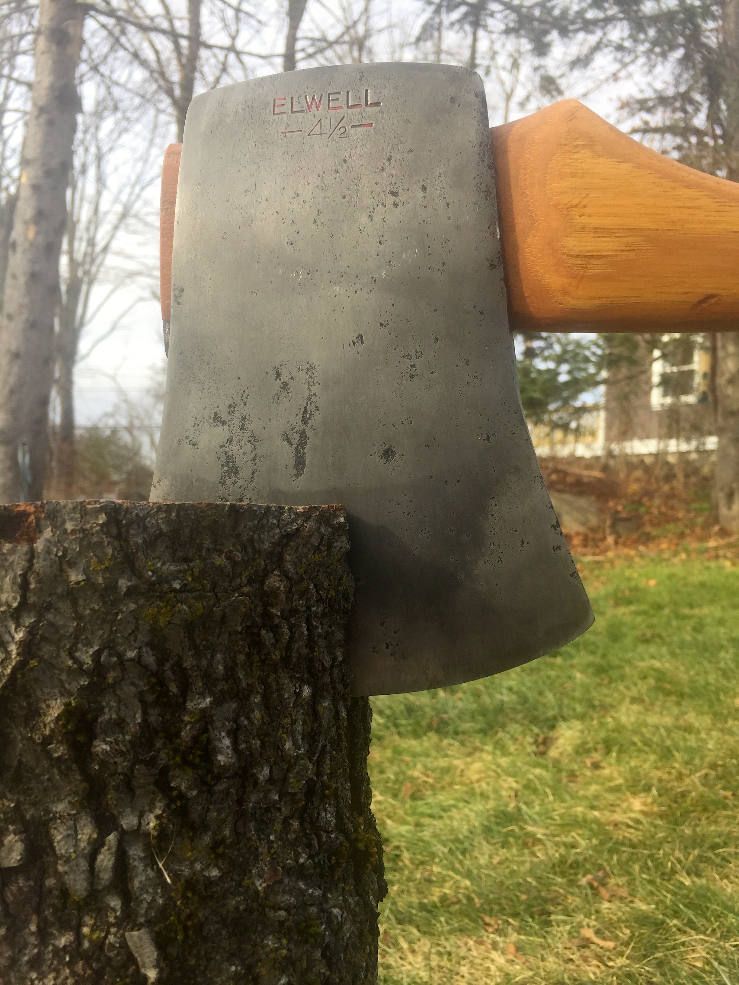

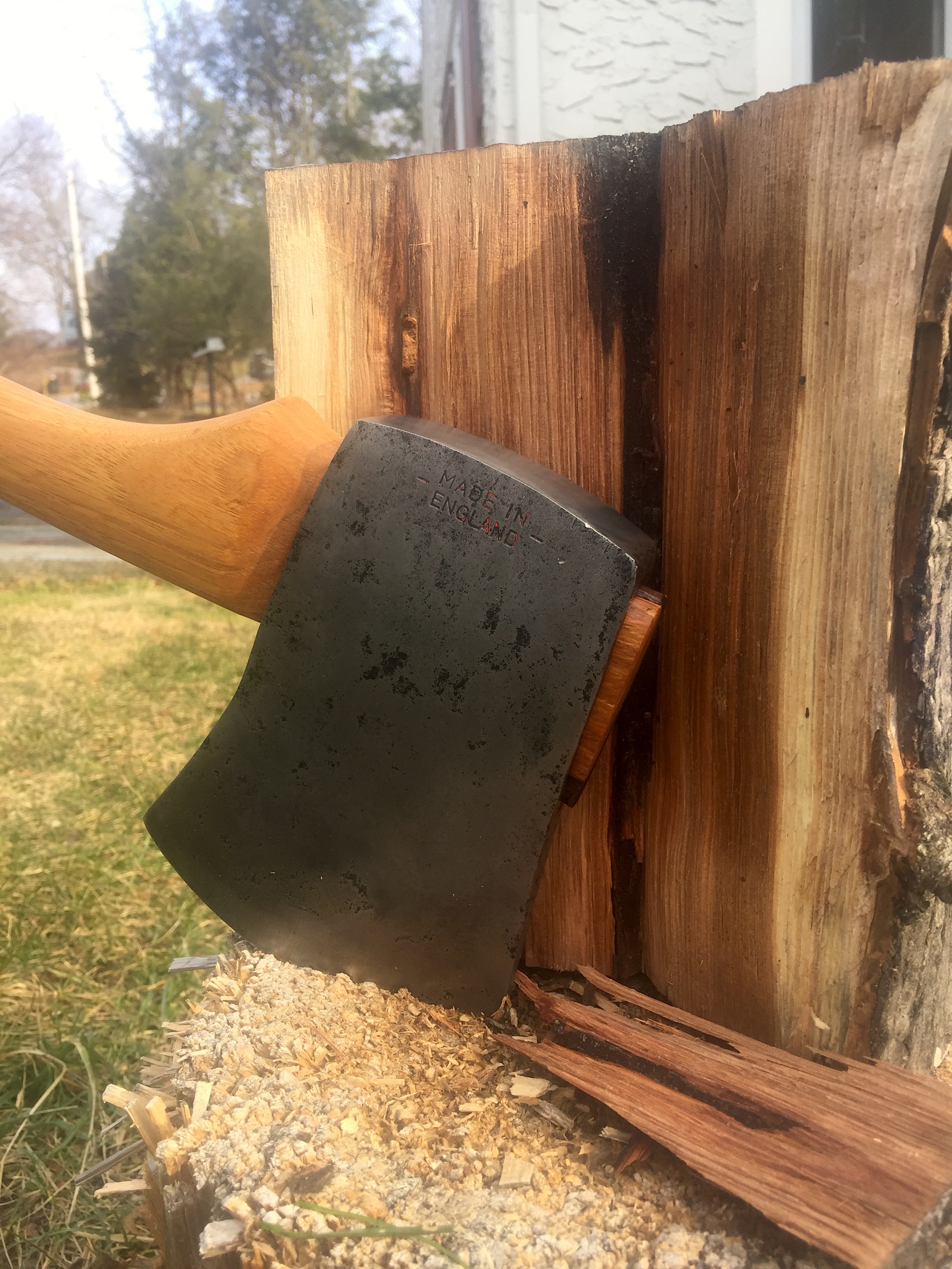

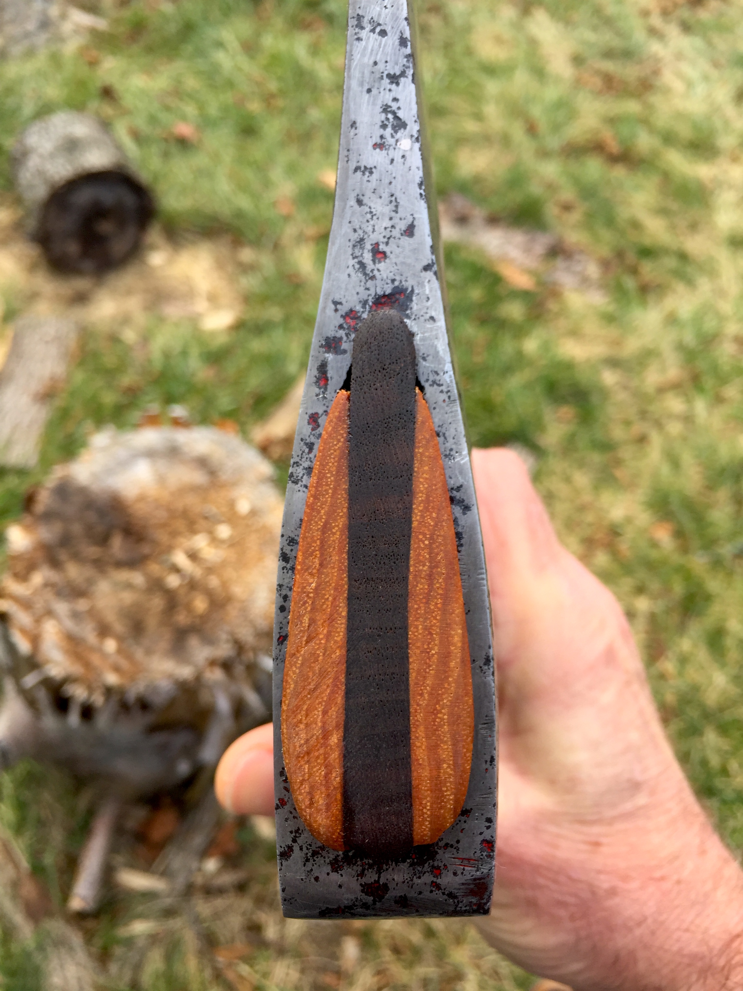

The Elwell has landed! Work has been demanding these past couple of months. But with a few days off I was able to finish putting this Tassie together. I paired it with a Hoffman 32" haft. There wasn't anything decent locally, so I decided I'd give one a try. It is a nice piece of wood. I had to take a lot off the tongue in order to get it into the eye. Anyway, not a perfect hang, but it is a personal best. It'll be a user, so good enough will do.
After a BLO soak and wipedown. There's a small gap on either side of the wedge at the front of the eye. The walnut wedge is a nice touch.
Yeah... This will do fine!
Now I'll move on to the leather phase of this project.

Beautiful axe and beautiful hang! That grain is the epitome of perfect. The pair complements each other nicely. It's hard to move past connies or tassies for looks in my opinion. Jerseys look real good too but there's something about axes like yours... Nicely done Mr. DB_cruiser!
Thank you! And I agree. Connies and Tassies just do something for me as well. Funny I found a Tassie before acquiring a Connie, given my location on this Earth.
Well, that is a nicely executed Elwell!
About what time range did Elwell make an axe in that pattern?
I am curious about this too. I haven't found anything specific regarding this. I find information (internet info - grain of salt required) that the forge in Wednesbury (which itself seems to have a longer history) was purchased in 1831 by Edward Elwell and operated for around 100 years. It merged with Chillington Tool Company around 1930 and was later acquired by Spear and Jackson. It seems many tools were still stamped with the Elwell name well after 1930. I have not been able to find any information about when they made this pattern and I have no idea how old or young my example might be.

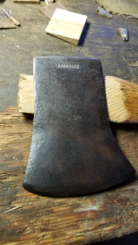

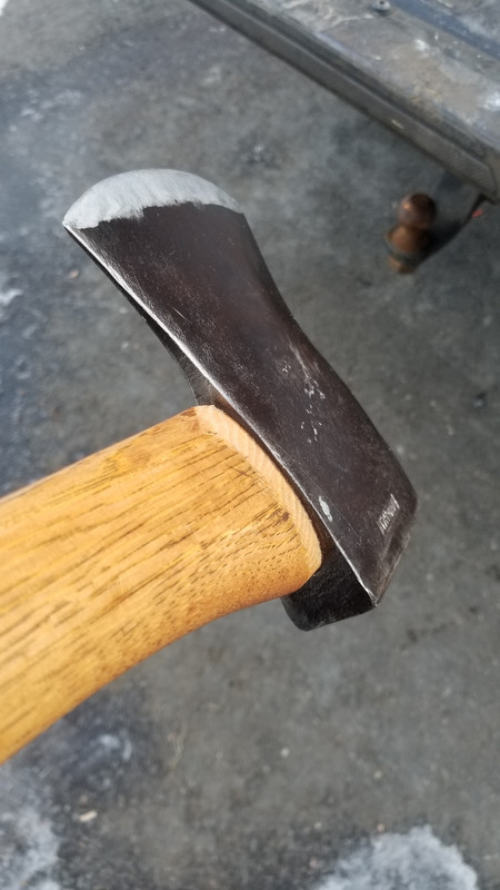

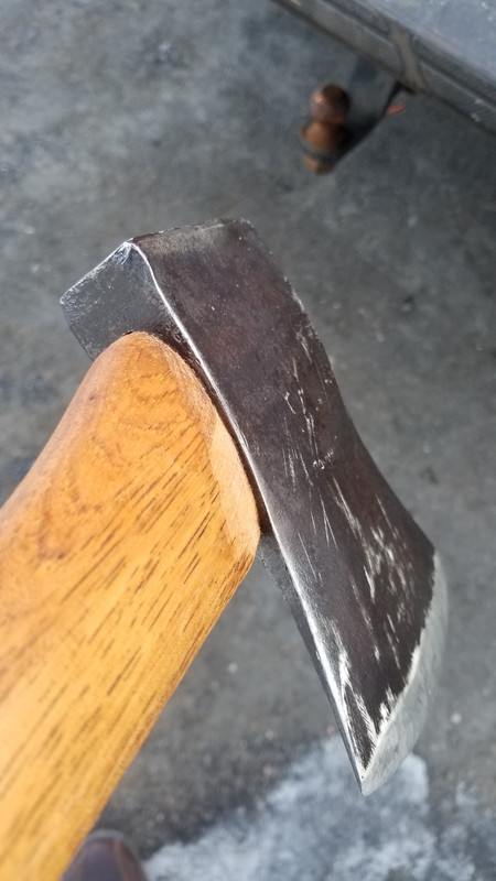

Sweet!! Thanks a lot. Can you spot straight line electric weld line near the Voughan's eye? It might be my brain trying to bend reality and see a line that's not there.
I had not noticed any kind of weld lines and i have been handling it a bunch the last couple weeks.
Where or which picture do you possibly see something? I will gladly take a closer look, just for my own peace of mind.
Thanks
