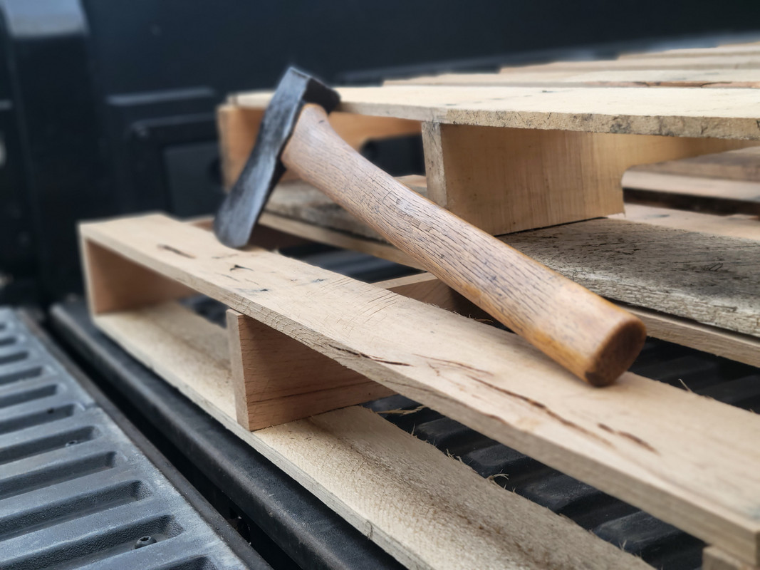

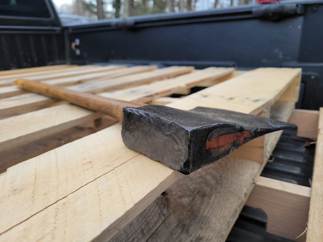

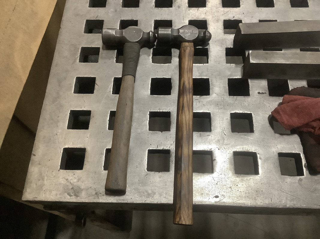

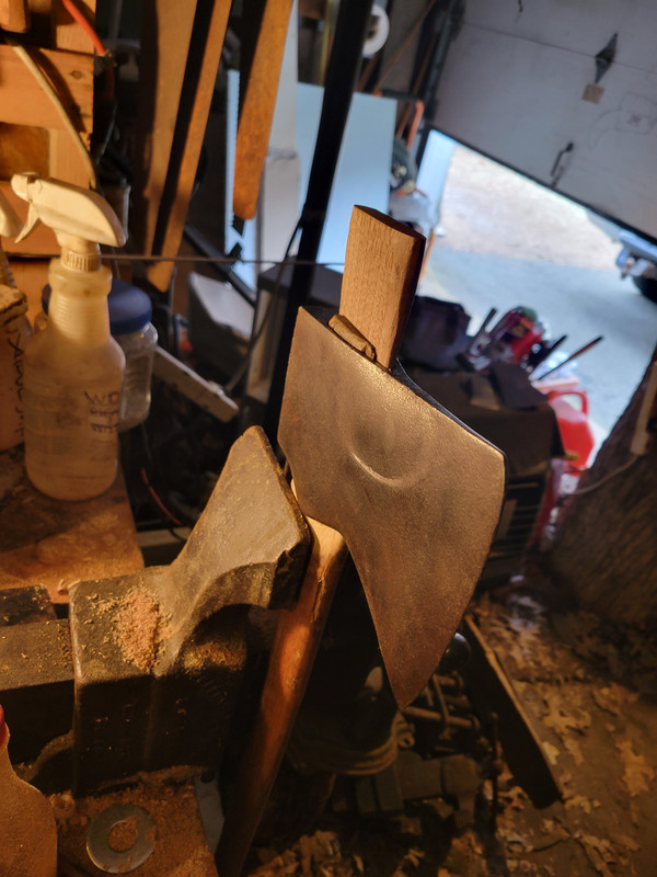

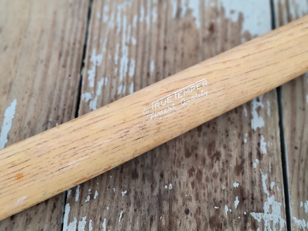

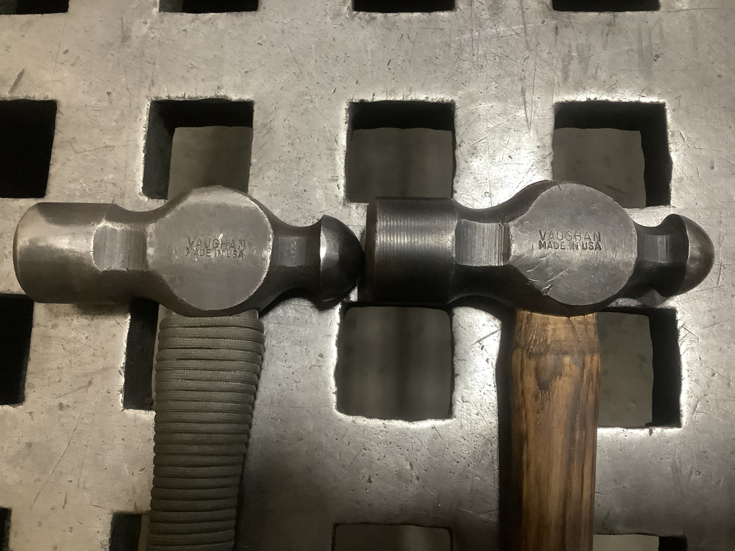

First thing this morning I broke the handle out of my baby peen and had to stop what I was doing to make another one 😩
I just used a piece of hard maple and locust for the wedge. I’m not very picky 😂

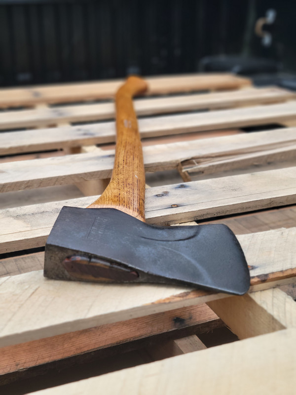

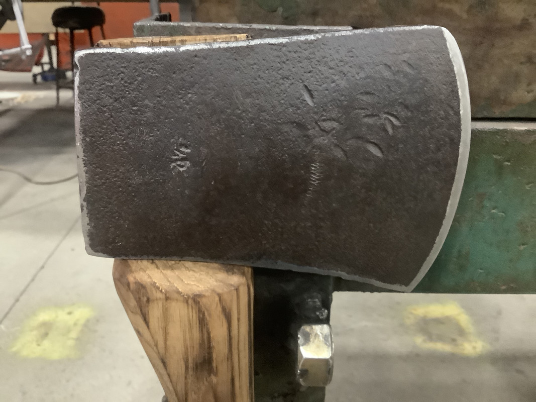

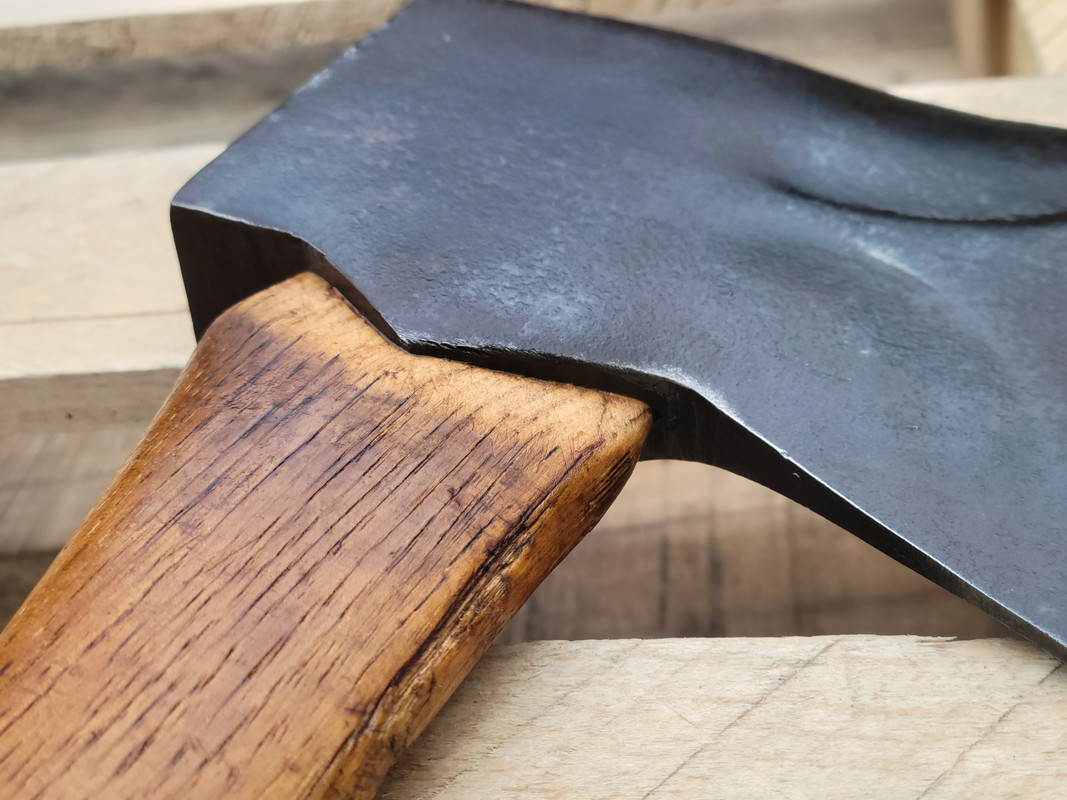

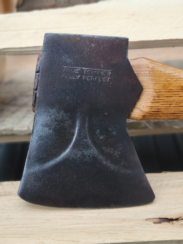

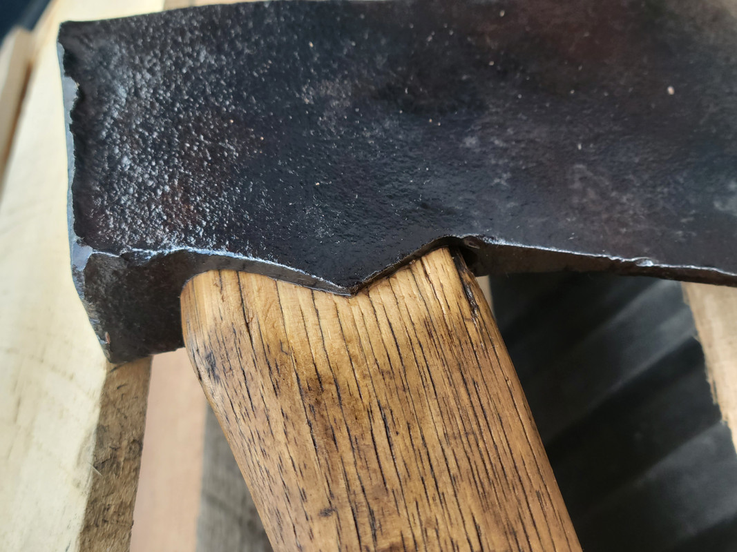

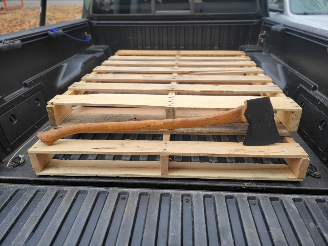

Did you have any problems fitting the lugs to the handle while hafting? I have a Jersey pattern axe head and YouTube isn't very helpful in pointing out any challenges -- maybe because there are none! But I thought I'd ask you. Thanks for any guidance you could provide.
it's actually not terribly complicated, you'll see a log of guys cut reliefs for the ears, but it's not a terrible issue. Instead what usually happens is you take a spoke shave or rasp and just take down the shoulder on the side until it's a smooth plane. If you look on some of the old handles, they swell a little, but the only shoulder they have is on the spine of the handle under the poll.

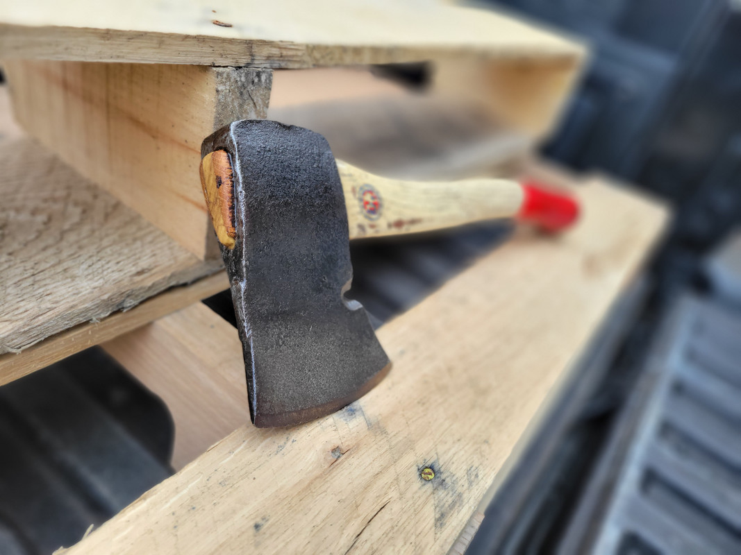

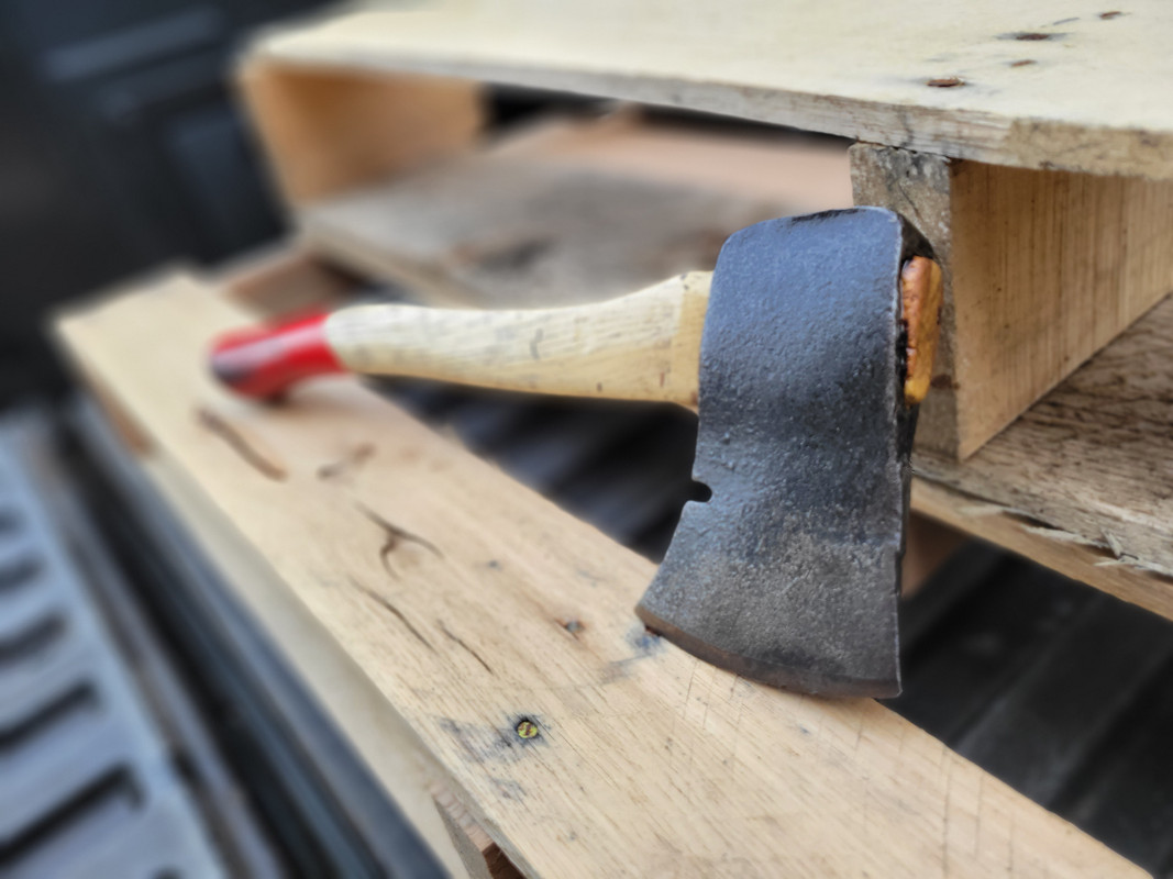

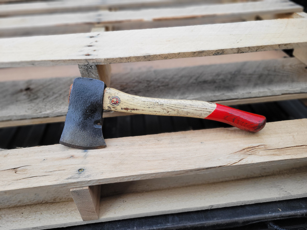

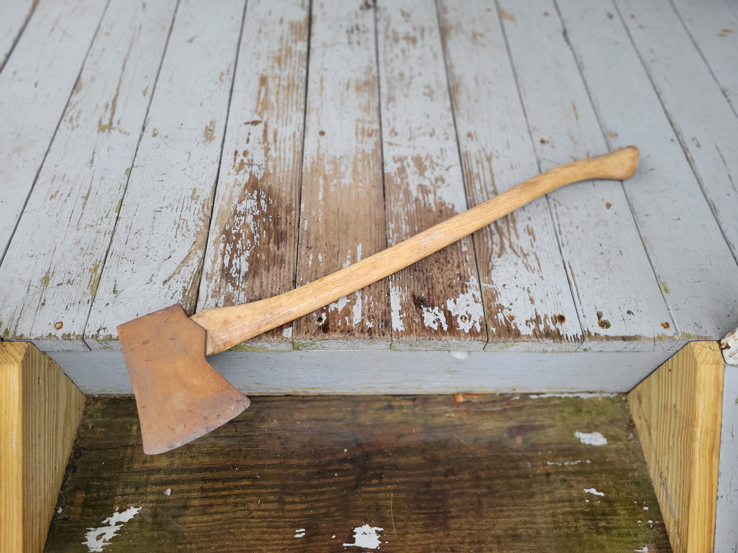

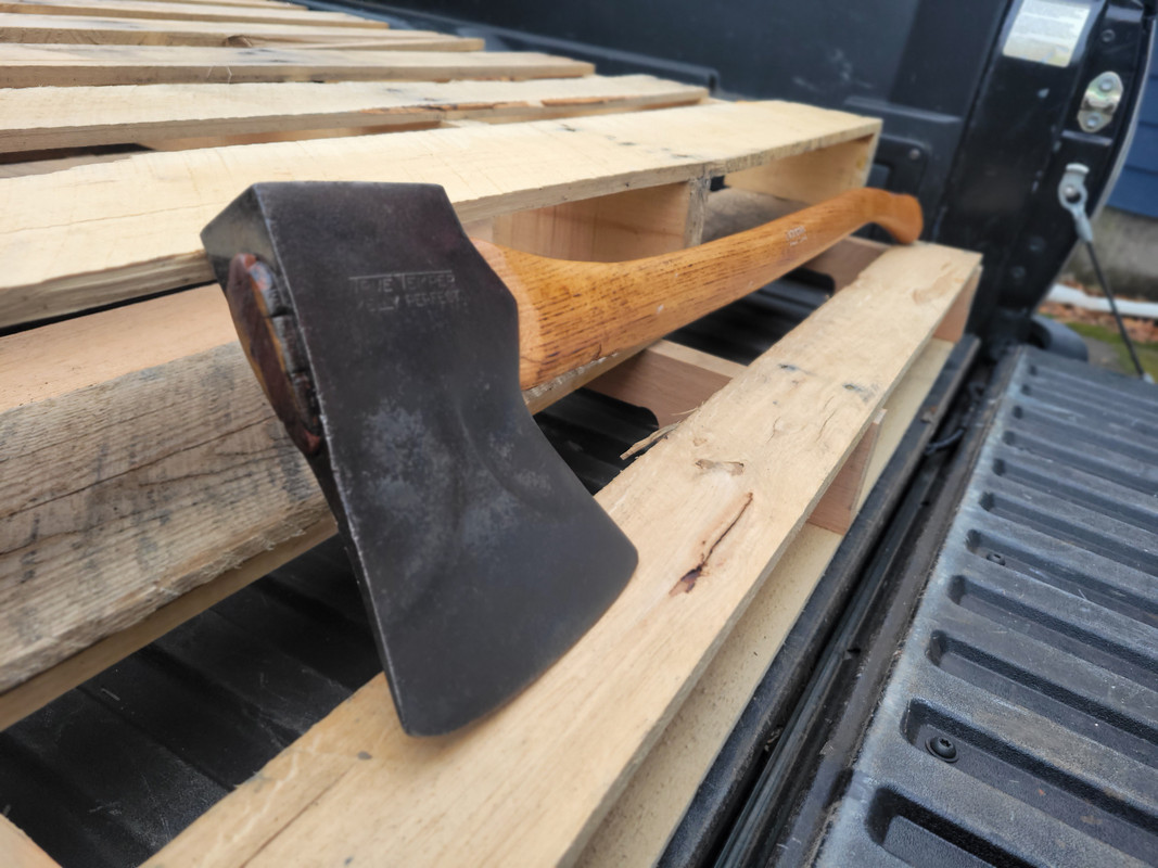

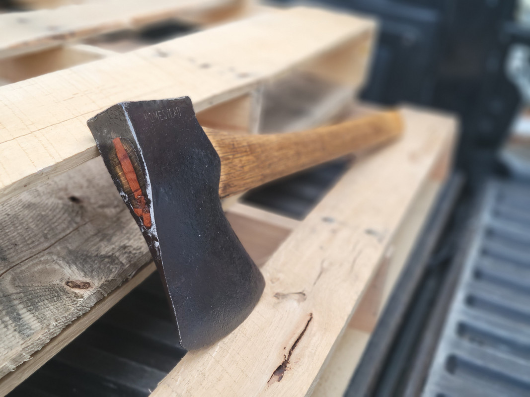

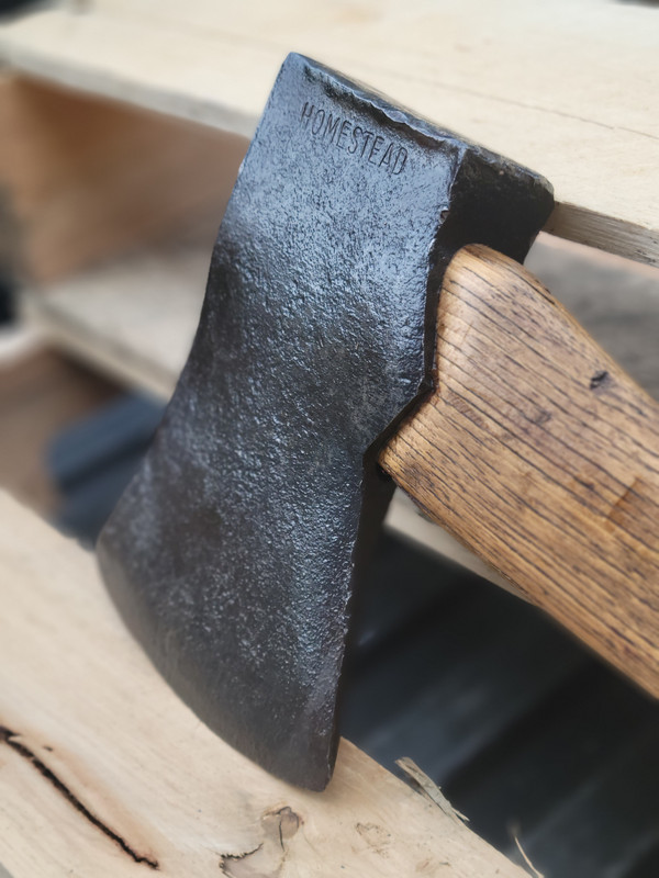

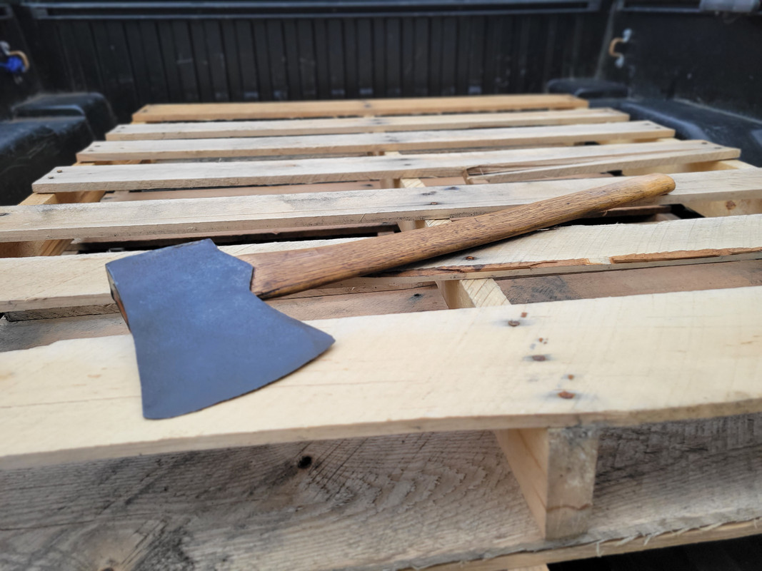

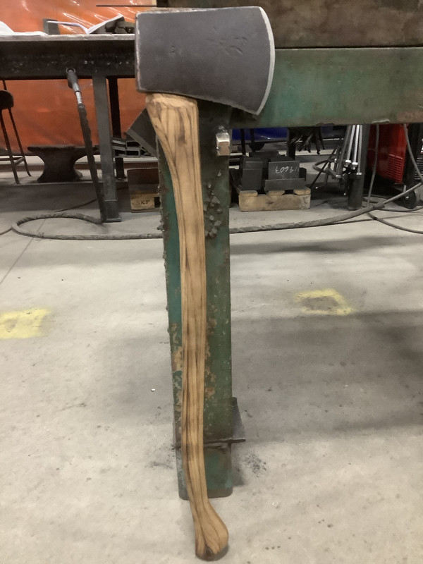

funny thing though, I finished that ax about 2 years ago and mailed it to a friend in texas, who promptly busted the handle.

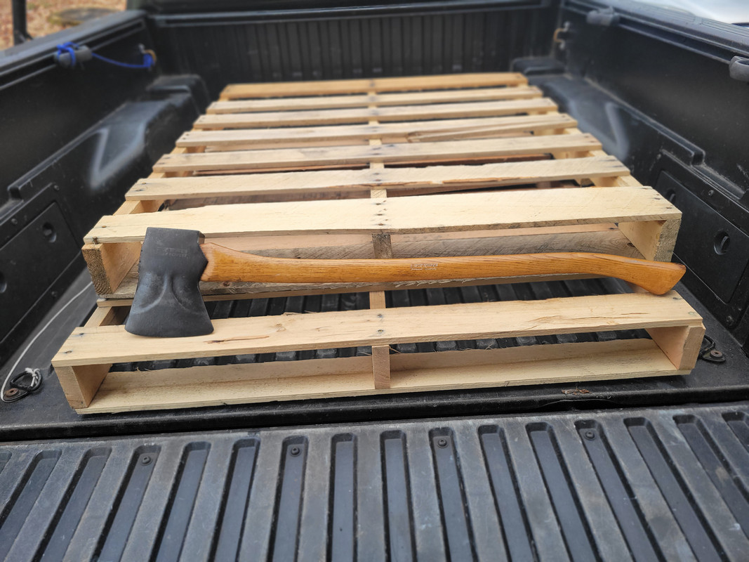

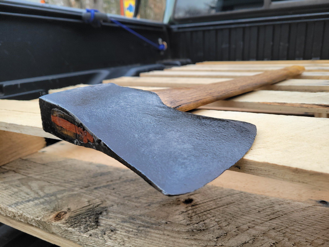

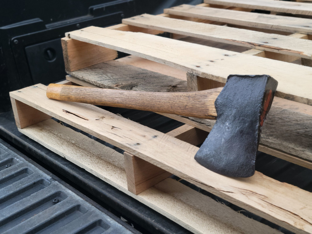

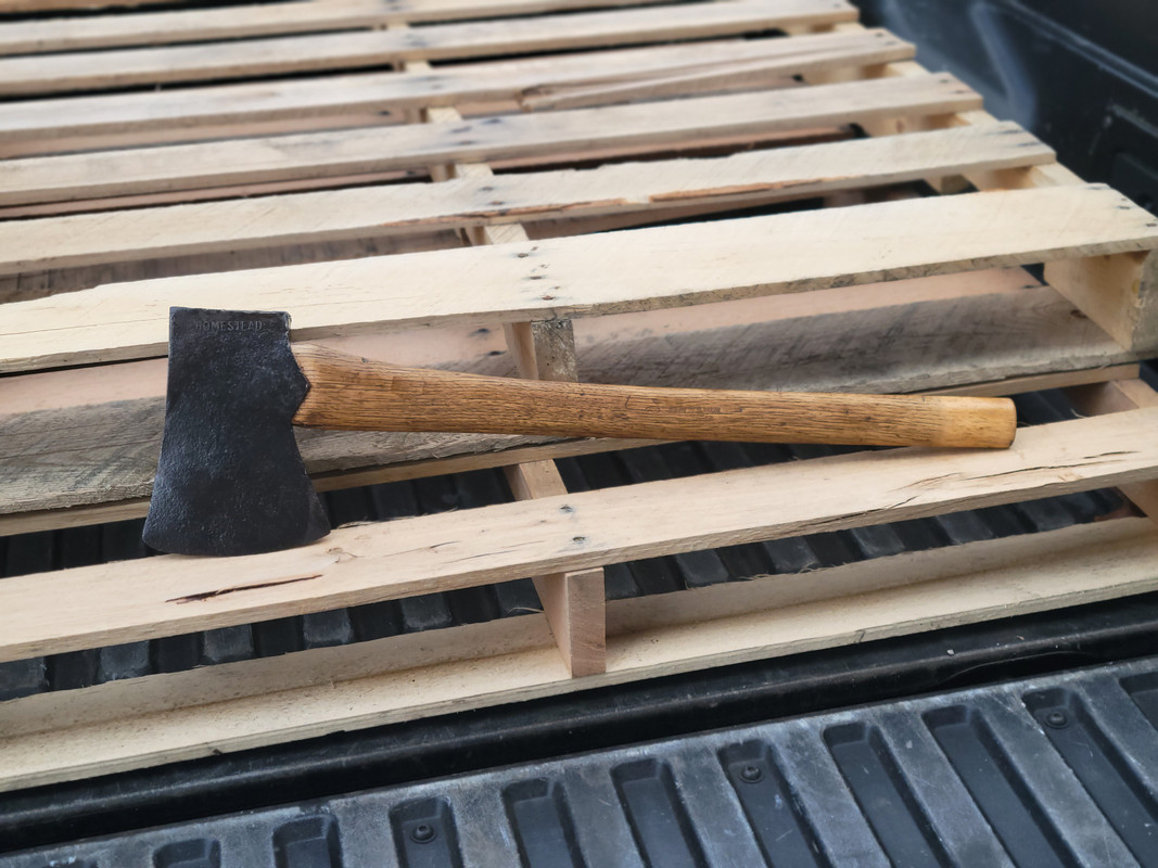

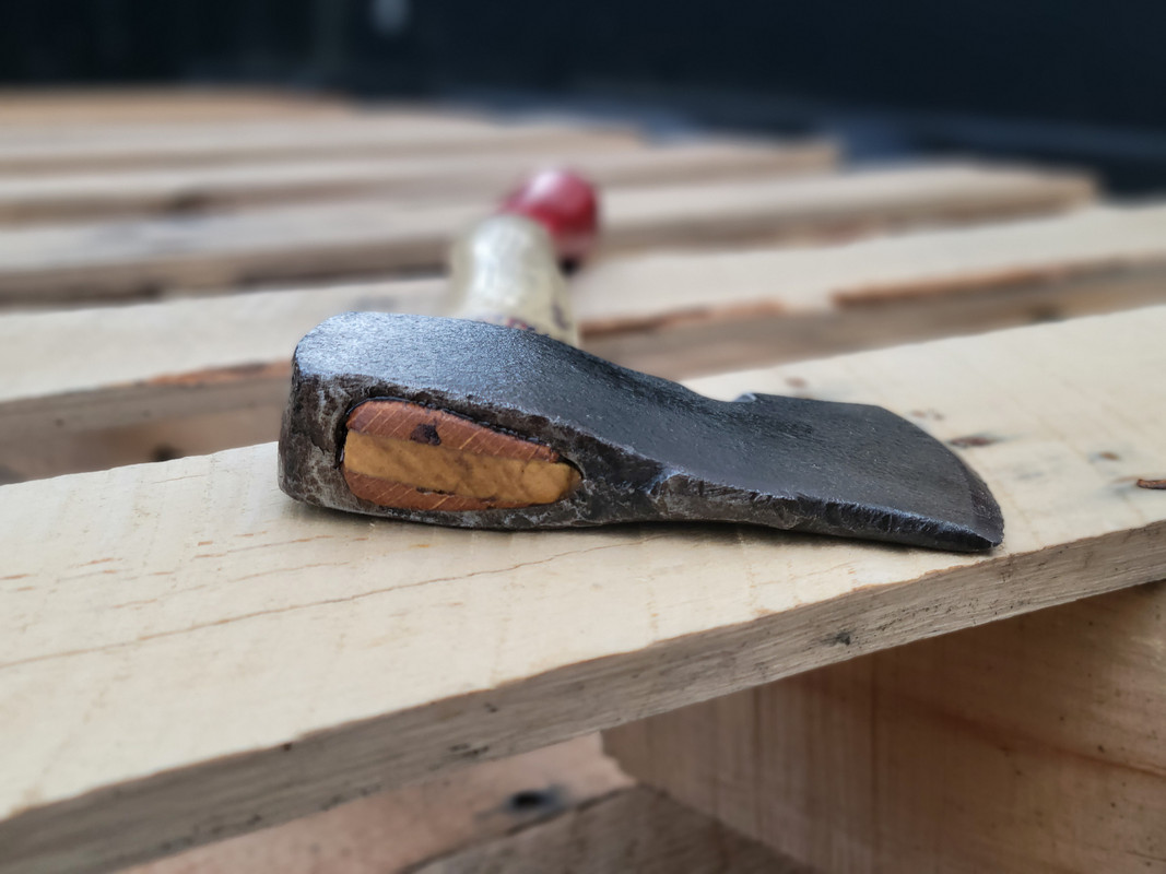

this is what it looked like as the handle was done. it had been sitting so long that the head needed another go around.
again not my cleanest work, but it wasnt a particularly nice head either

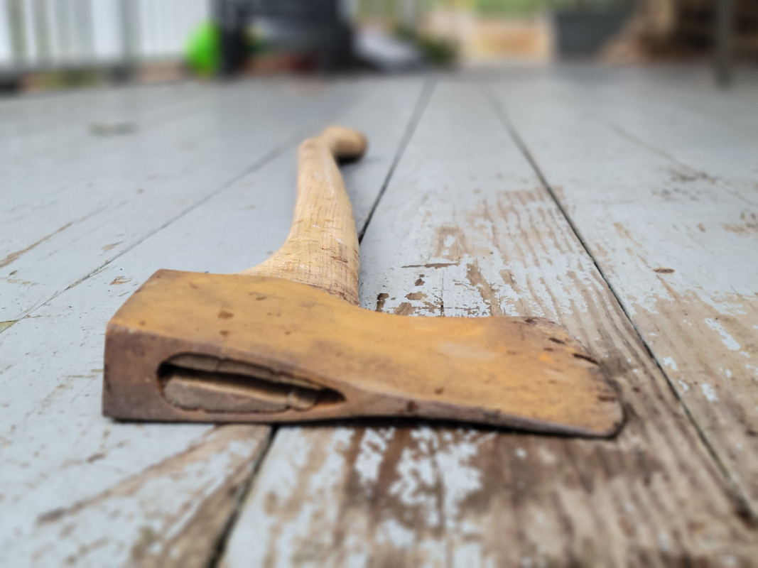

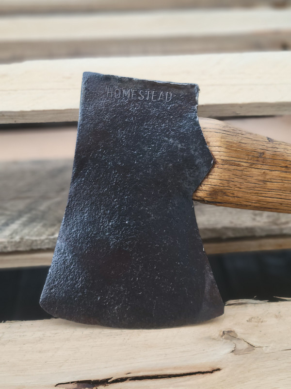

i do rehang a lot of axes and hatchets from flea market , on home made shafts. but today i did not rehang much but i repaired my unmarked hudson bay in a brutal but efficient way. eye was rounded by former owner using it mostly as a hammer, i hafted it like that but since a while it was wobbling , so this morning i left the haft seated and with a big hammer and the help of a sturdy concrete wall as an anvil, i blew a few strikes on it and it made it back to a more oval shape like it should be and haft seems to be ok and tight, then...
The figure is only one element so that alone will not tell much about the handle strength. At most I'd say it does not help on that account but you have the aesthetics for compensation plus it is a smaller axe. vidmate.app saveinsta

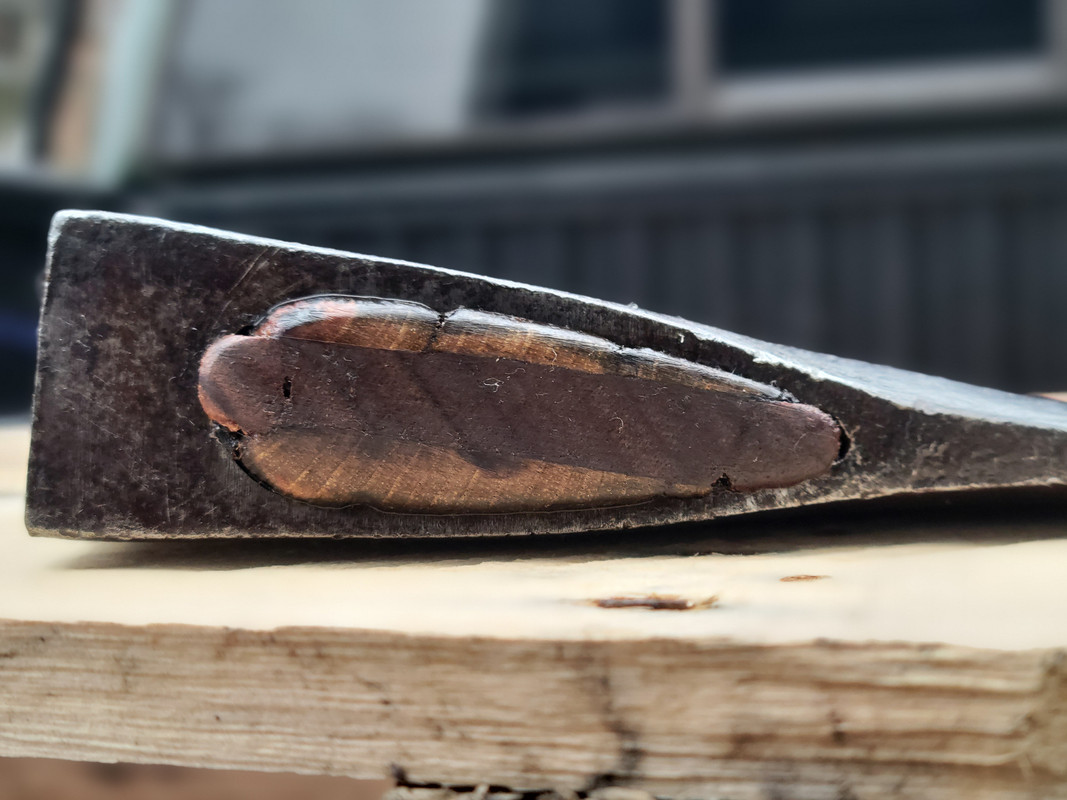

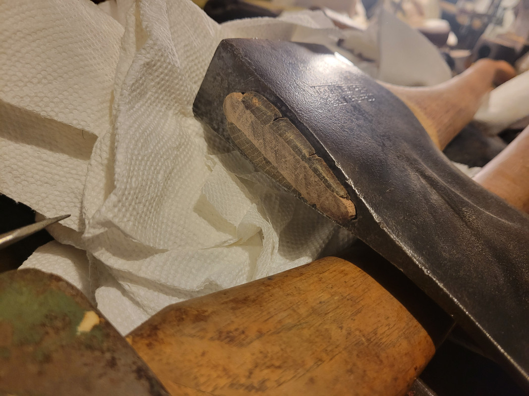

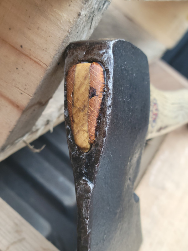

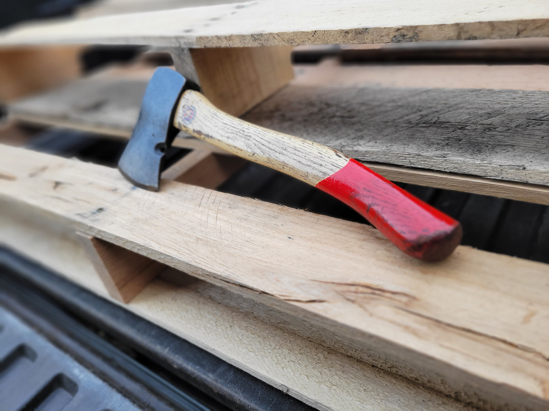

I thought about re-rehanging this one due to the wedge breaking apart on the last mallet blow.
After choosing the wrong saw to cut it flush, it went squirrelly.
I love it tho! The rough look i do go for more than the fine and finish.
