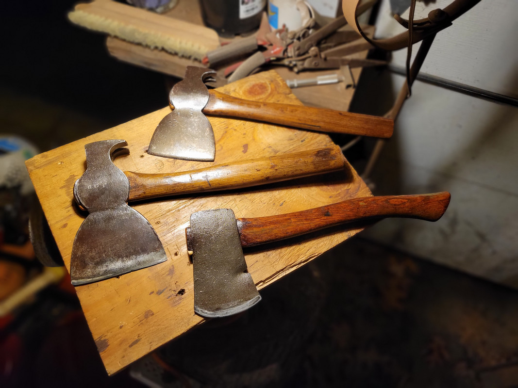

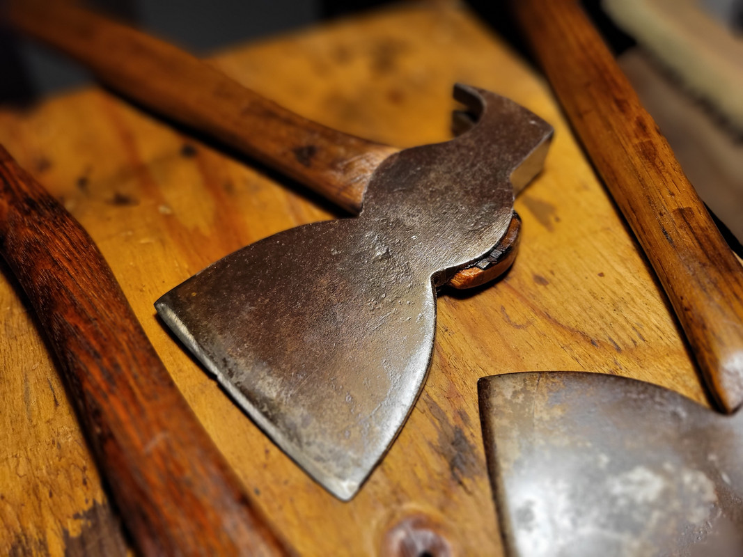

3 beauty's today!

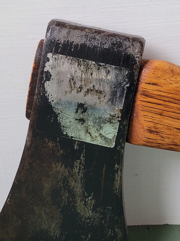

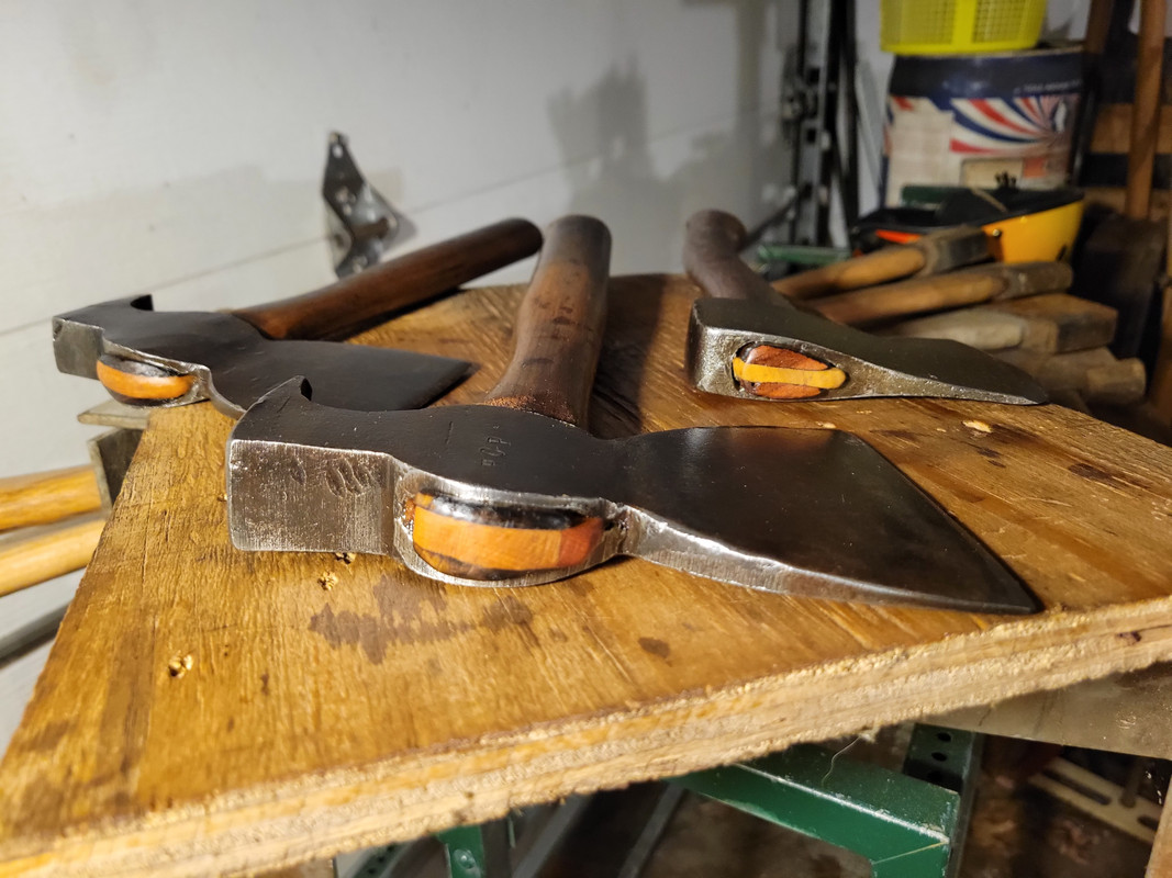

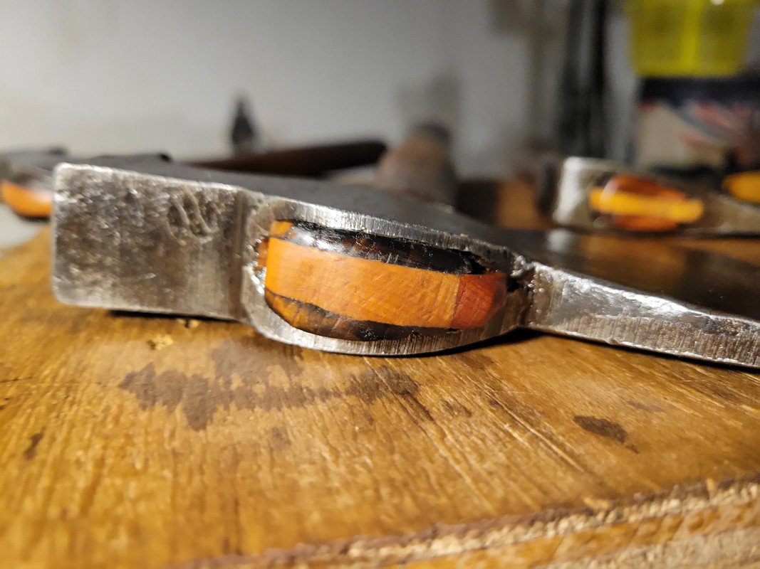

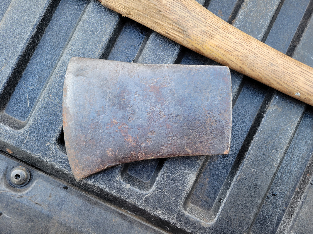

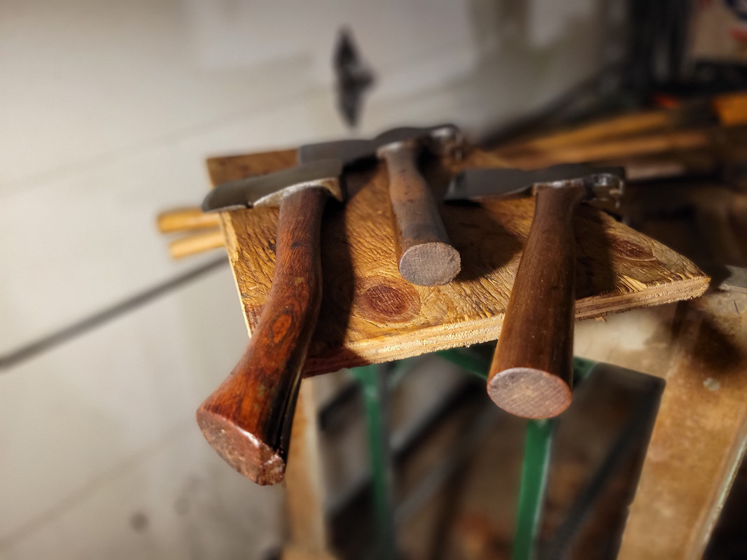

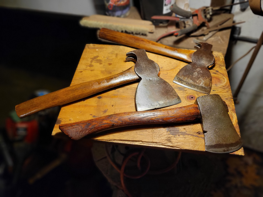

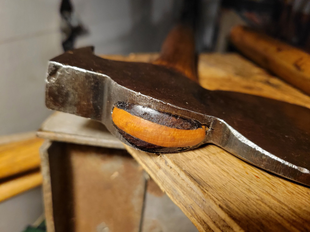

All hunches on these without stamps.
I believe the two claw hatchets to be paper label true temper and the scout/camp hatchet to be a Marion.
Just hunches
1½lbs X 13½"Long X 3"Bit
2¼lbs X 13¼"Long X 4⅓"Bit
1¾lbs X 12½"Long X 3½"Bit

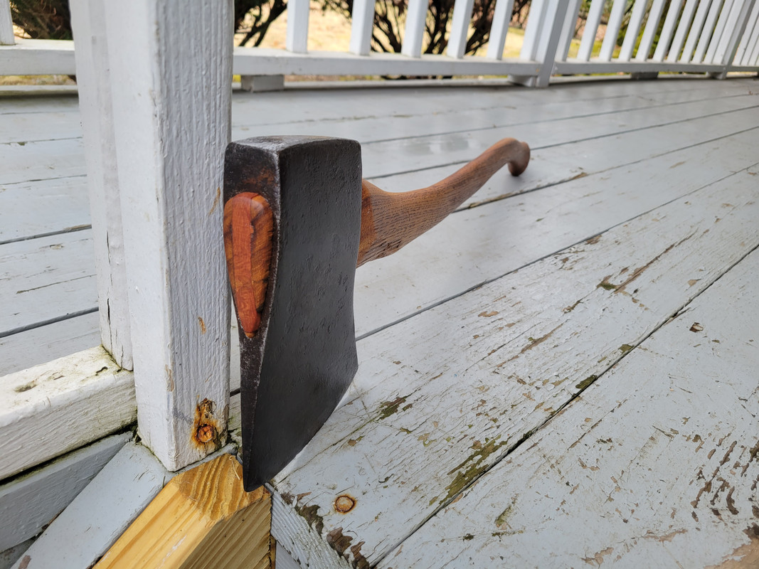

Yesterday was a good day.

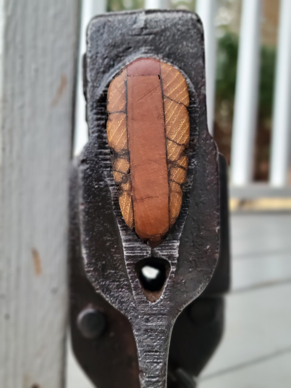

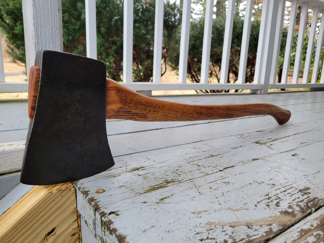

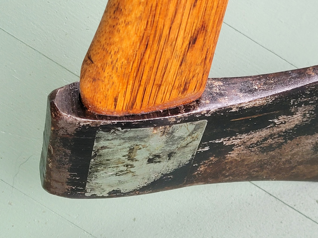

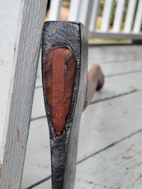

It was our wedding anniversary, my son had a school concert, and i hung this beauty...
True Temper
Connecticut Pattern
3½lb X 6⅞" Head and 5¼" Bit
Six Eye Ridges
Original True Temper Handle
Unmolested, Unabused, Lightly Used
Single Birch Wood Wedge
4½lbs Total
Slender Thin Curvy Best
Solid, Full
Tight & Secure Rehang
31" Long

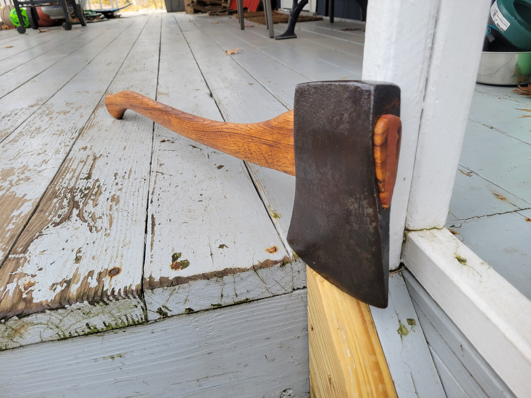

Sneaking into the weekend early I hope!

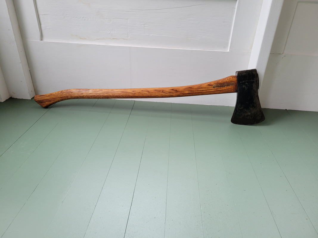

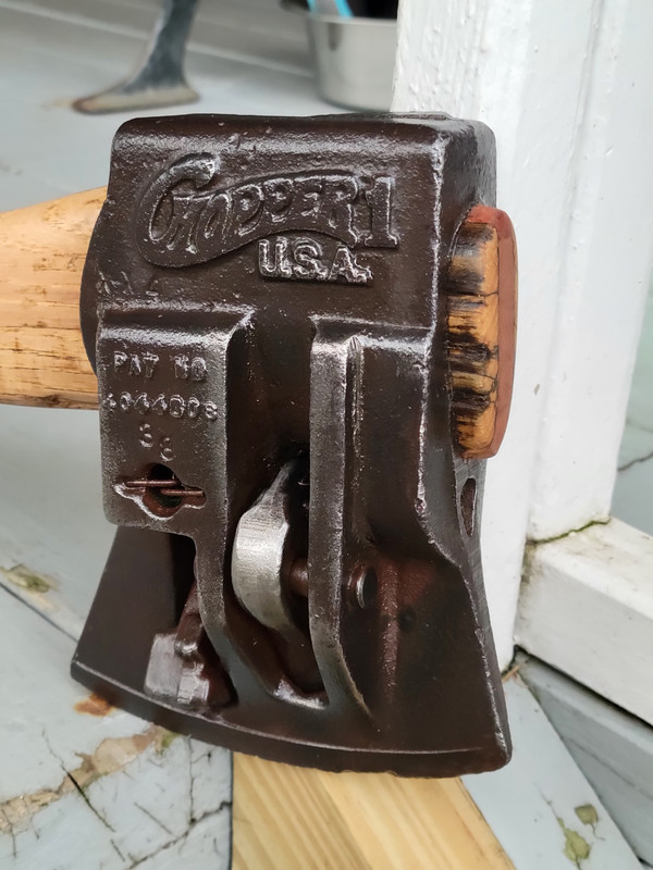

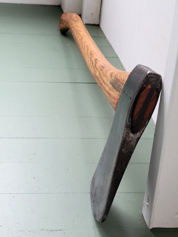

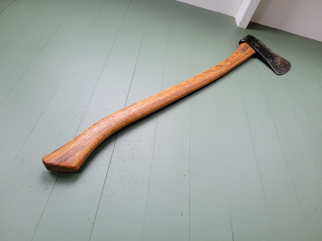

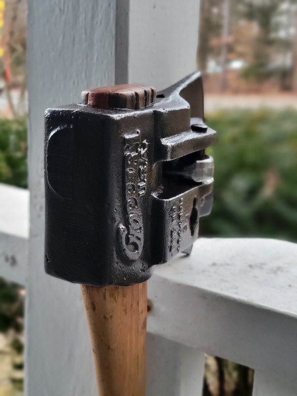

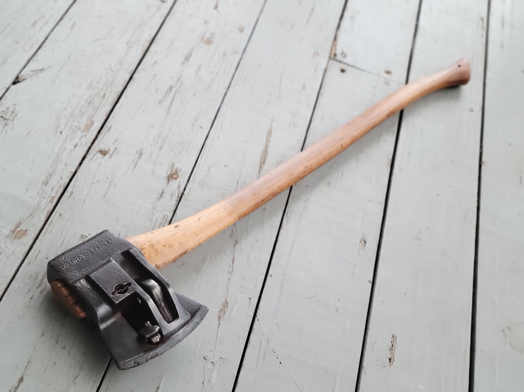

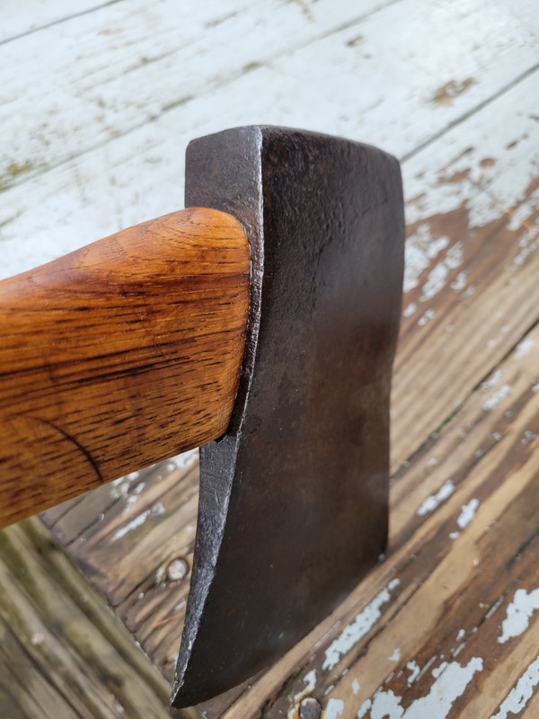

Yesterday i was able to take some time, clean and build up this
The Chopper 1
6¼lb X 6⅜" Long Head with 5⅛" Bit
Quick, Tight, Smooth Spring Action
Rehung On Era Similar Handle
Removed Remaining OverStrike Guard
Birch Wood Wedge
7½lbs X 34¼" Total

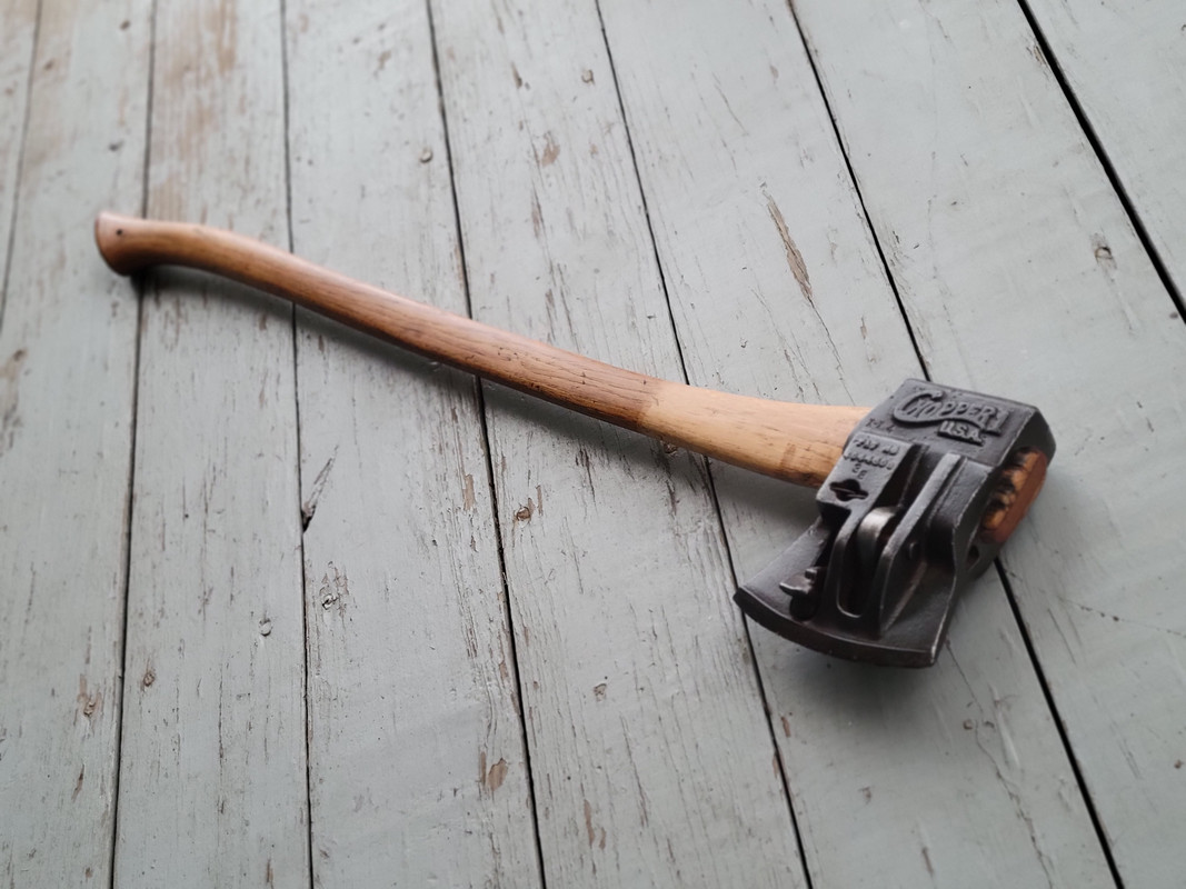

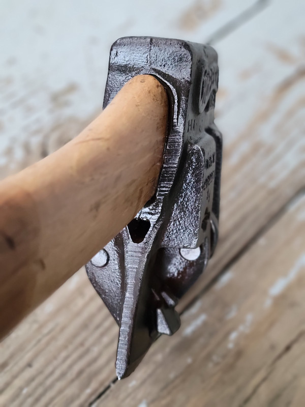

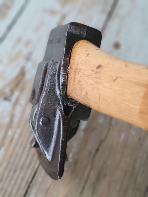

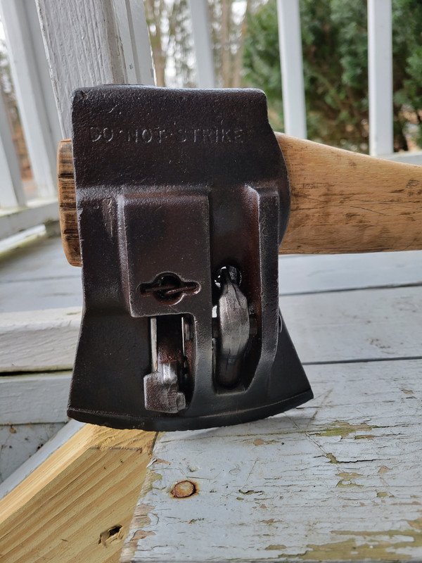

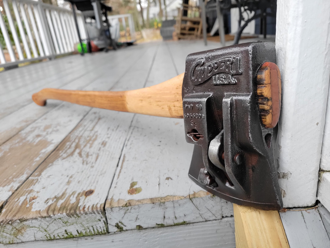

I've never seen one of these in person, but I think it's beautiful.
I watched several videos of it in use.
Gentlemen who have used:
Is this model really functional with high density or twisted woods?
Congratulations on the tool, this ax is very beautiful.

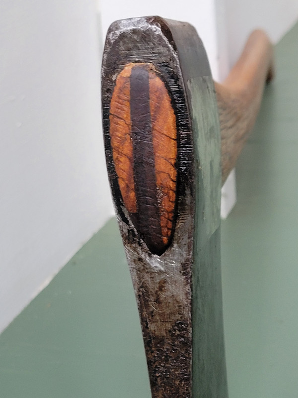

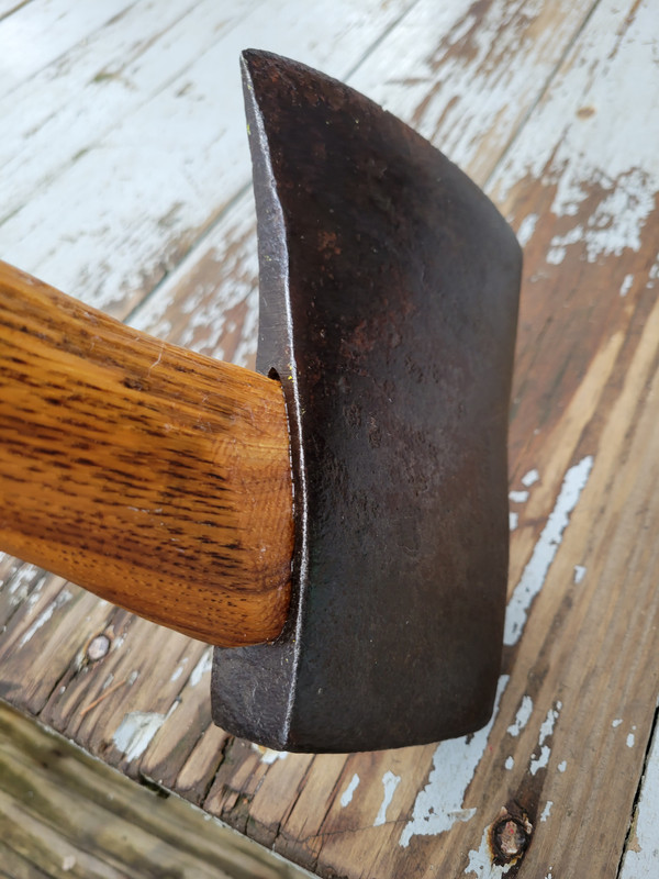

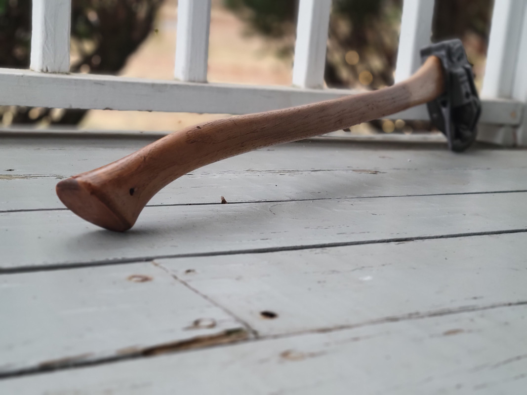

it's actually not terribly complicated, you'll see a log of guys cut reliefs for the ears, but it's not a terrible issue. Instead what usually happens is you take a spoke shave or rasp and just take down the shoulder on the side until it's a smooth plane. If you look on some of the old handles, they swell a little, but the only shoulder they have is on the spine of the handle under the poll.
funny thing though, I finished that ax about 2 years ago and mailed it to a friend in texas, who promptly busted the handle.
this is what it looked like as the handle was done. it had been sitting so long that the head needed another go around.
again not my cleanest work, but it wasnt a particularly nice head either
I just tell people that the lugs are merely an extension of the eye. Just to pretend the whole eye shape extends down to the points of the lugs. I've found that most are on the same plane as the rest of the eye, they normally don't taper in nor flare out. I really like your advice about the shoulder. Nice and flat, a smooth taper and transition from handle up into the eye. I see a lot of people leaving super thick shoulders on the sides and you know due to that they normally have just a little bit of contact at the bottom edge. Having thick shoulders has become a fashionable thing. People reinventing the damn wheel again. Haha

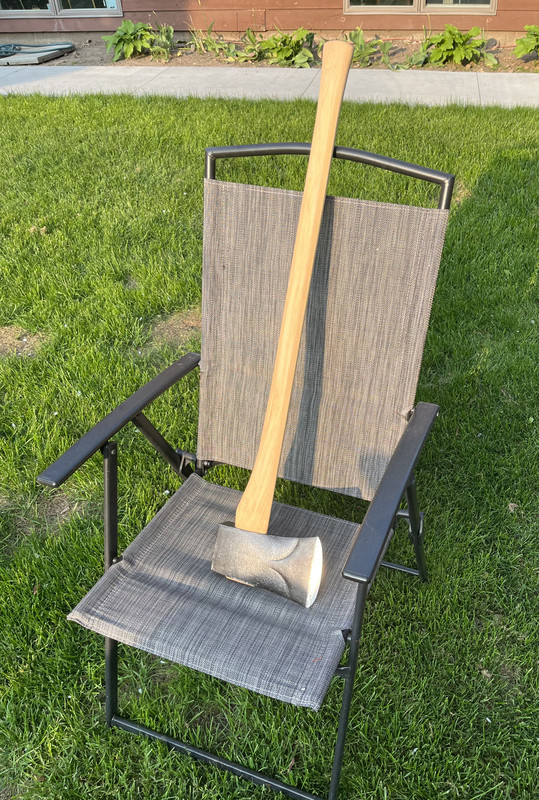

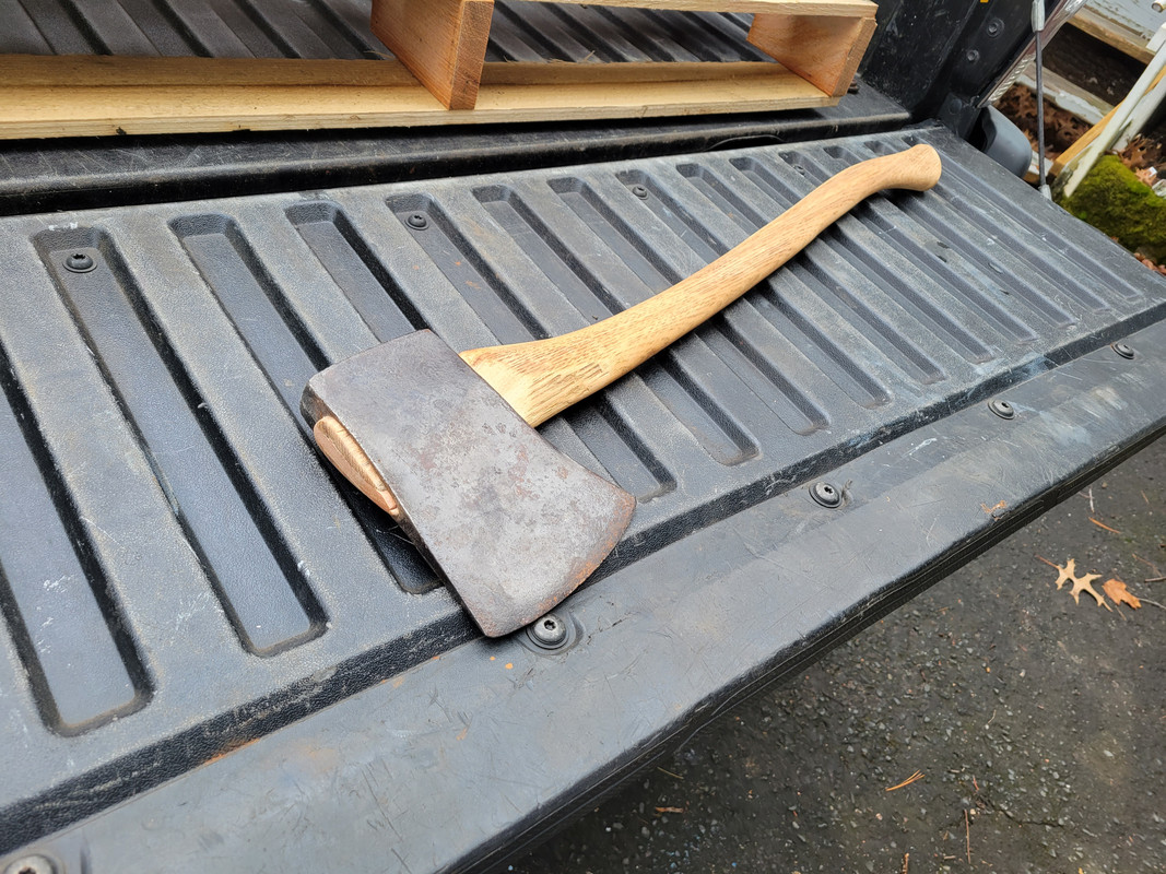

Winchester head on vintage Dunlap haft:
My goal was to preserve as much of the history as possible. I cleaned the head but didn't sharpen it, as I never plan to use it. I love the Dunlap haft, because, while it is a replacement, it's old and beautiful, and it's what came with the head. The patina and the grain orientation are great. Never mind the crack just below the head. I removed the damaged wood at the fawn's foot, shaved the shoulder a bit, and added a little stain to the raw wood. It's a peculiar size, like an oversized hatchet or an undersized boy's axe. I like it, and I hope you do, too. Thanks for watching. T-A
