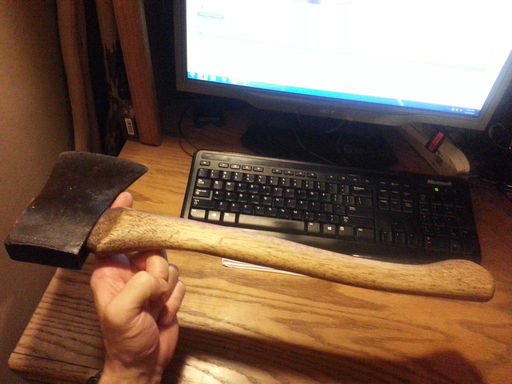

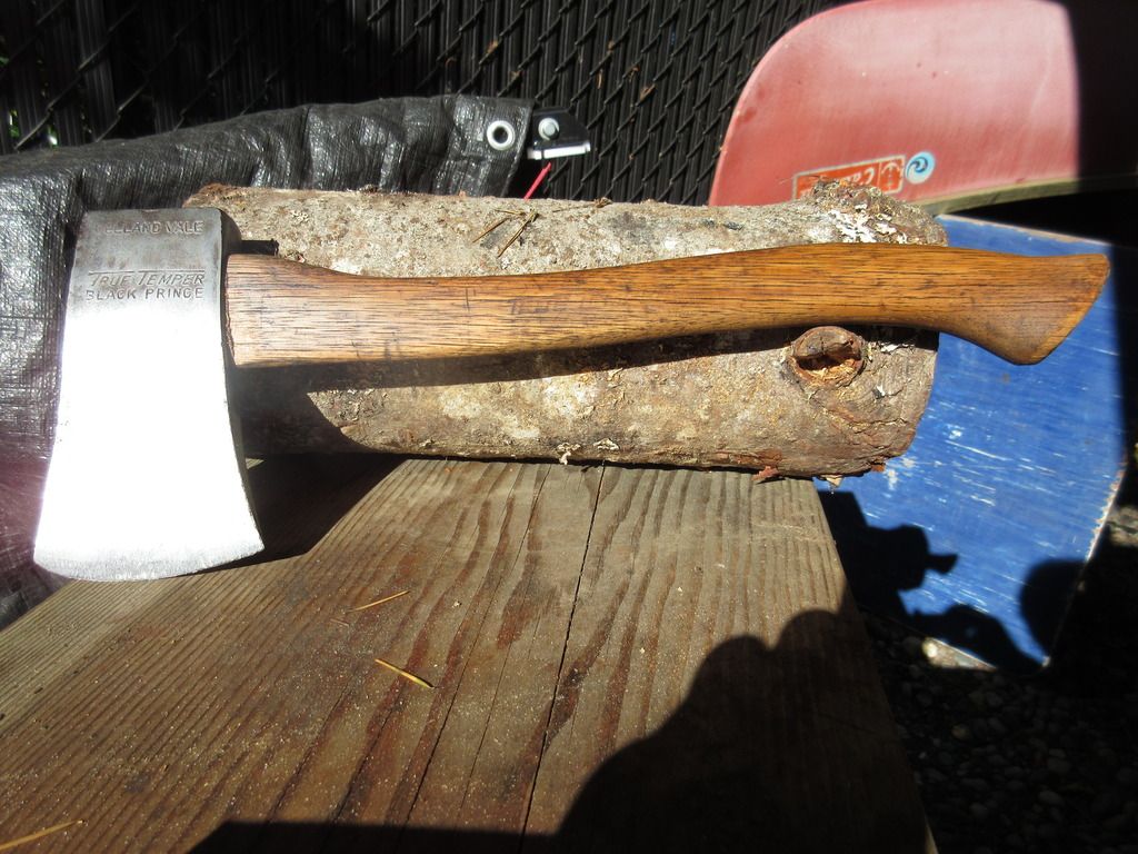

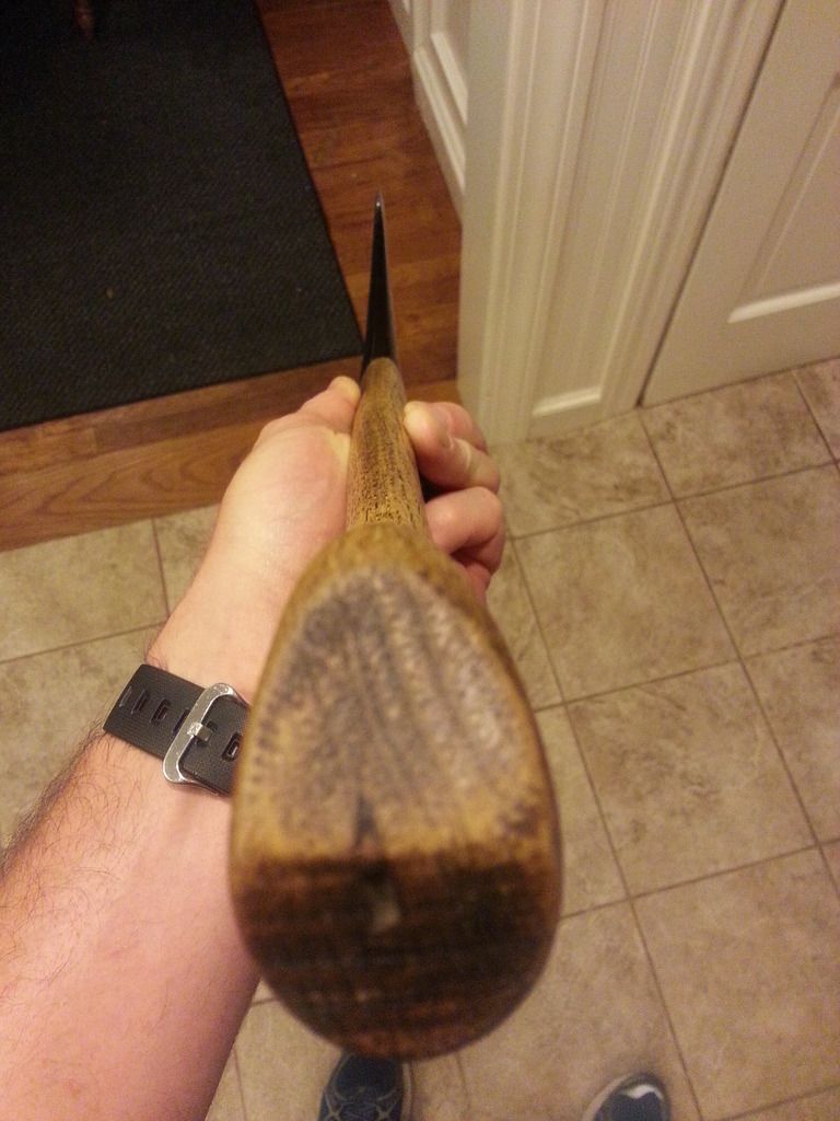

Just finish hanging my little Black Prince on its original handle, still needs a couple coats of Tru-oil and fine tuning the edge.
Funny, I just noticed from the picture that True Temper is written on the handle also.

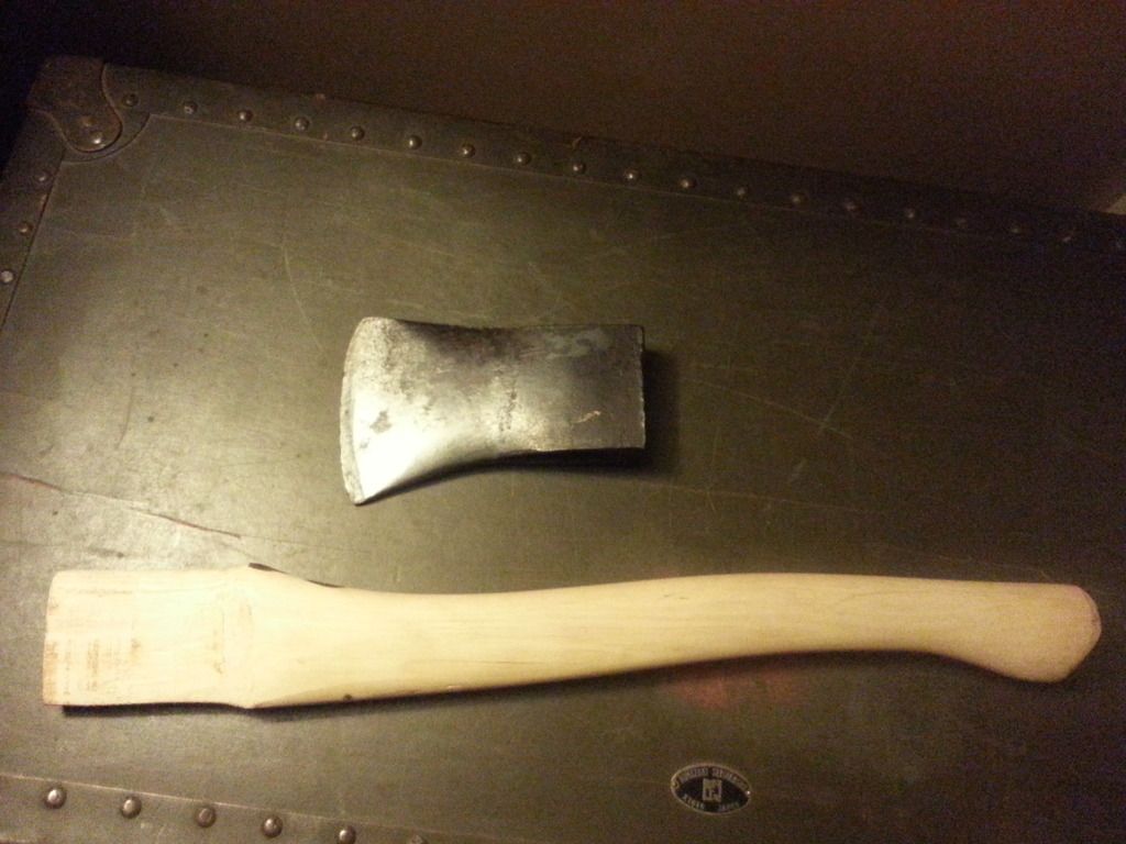

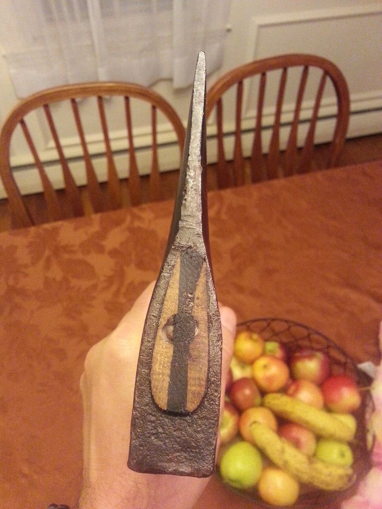

Today I started on an old "broad head" hatchet that was my grandfather's. It's currently in a vinegar bath, and I stripped the worn finish off a proper type NOS handle. It had mostly lost it's finish anyway, and I prefer bare wood. Pics as I make progress...
That is a svelte looking hatchet. The Black Prince.
Great name. Looks hungry. :thumbup:

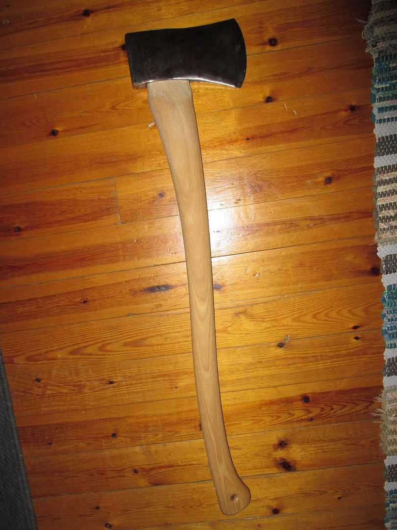

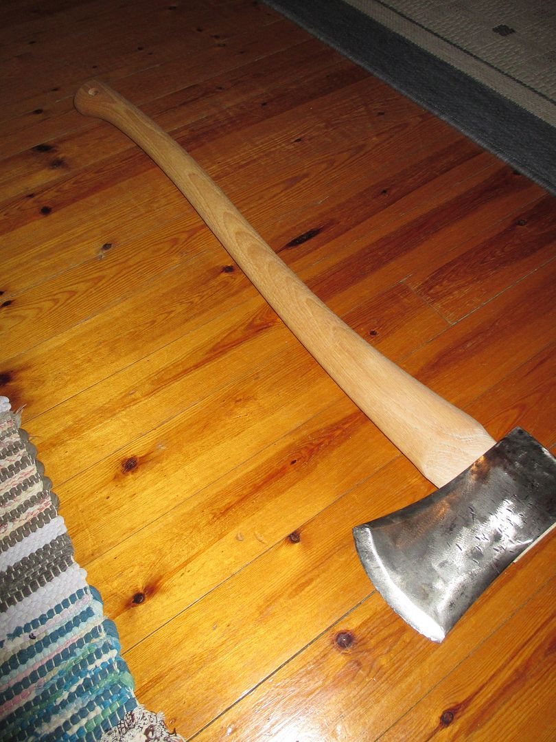

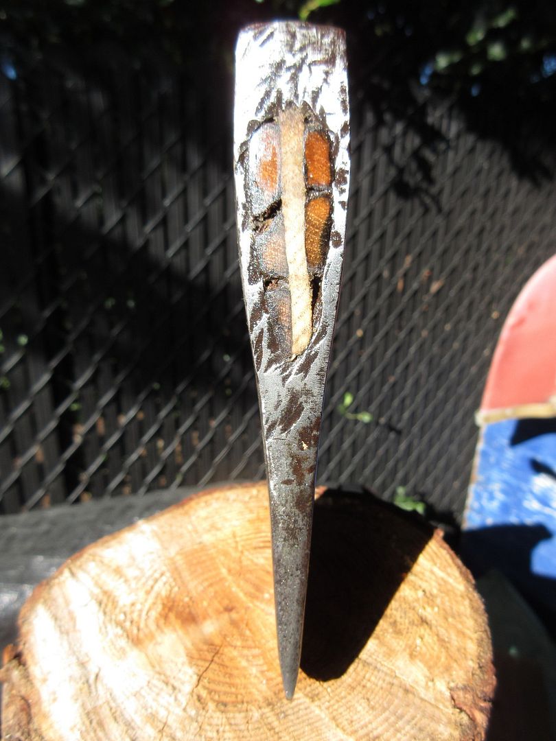

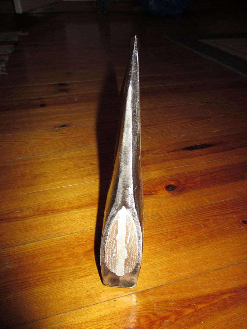

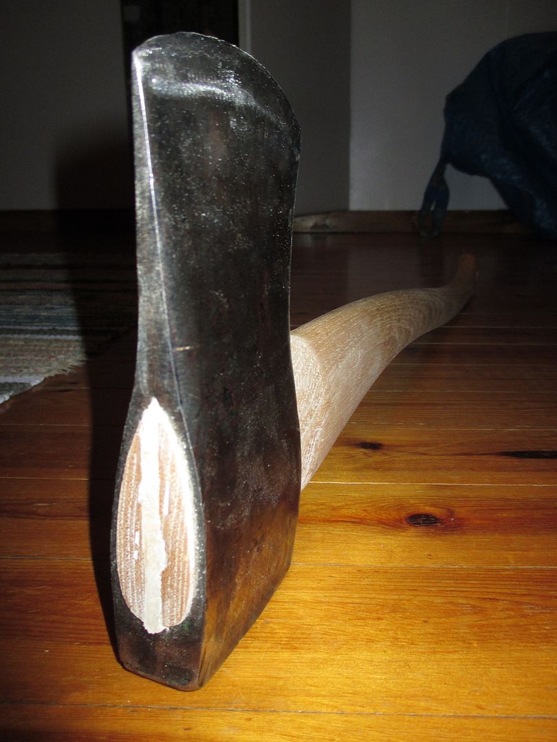

In a previous thread I posted a few pictures of my very old AGDOR.
I have searched high and low for a handle, but not a single handle was found. Well, I actually found many, but none had the right eye dimensions.
I went to my local hardware store and asked if they could get me a handle from Hultafors, which they could, thank god.
The handle measured 63x23mm, 750mm long. I believe they use those handle on their 1.5kgs.
No metal wedge, I'm going full American on this! :cool:
The wedged-end on that Agdor is great looking aikonen.
That is a wide looking eye - at least what I am used to seeing. The belly and back taper into the grip/swell really well.

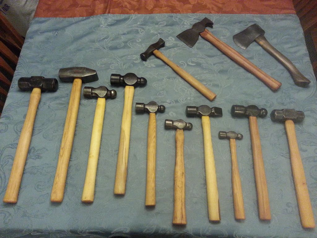

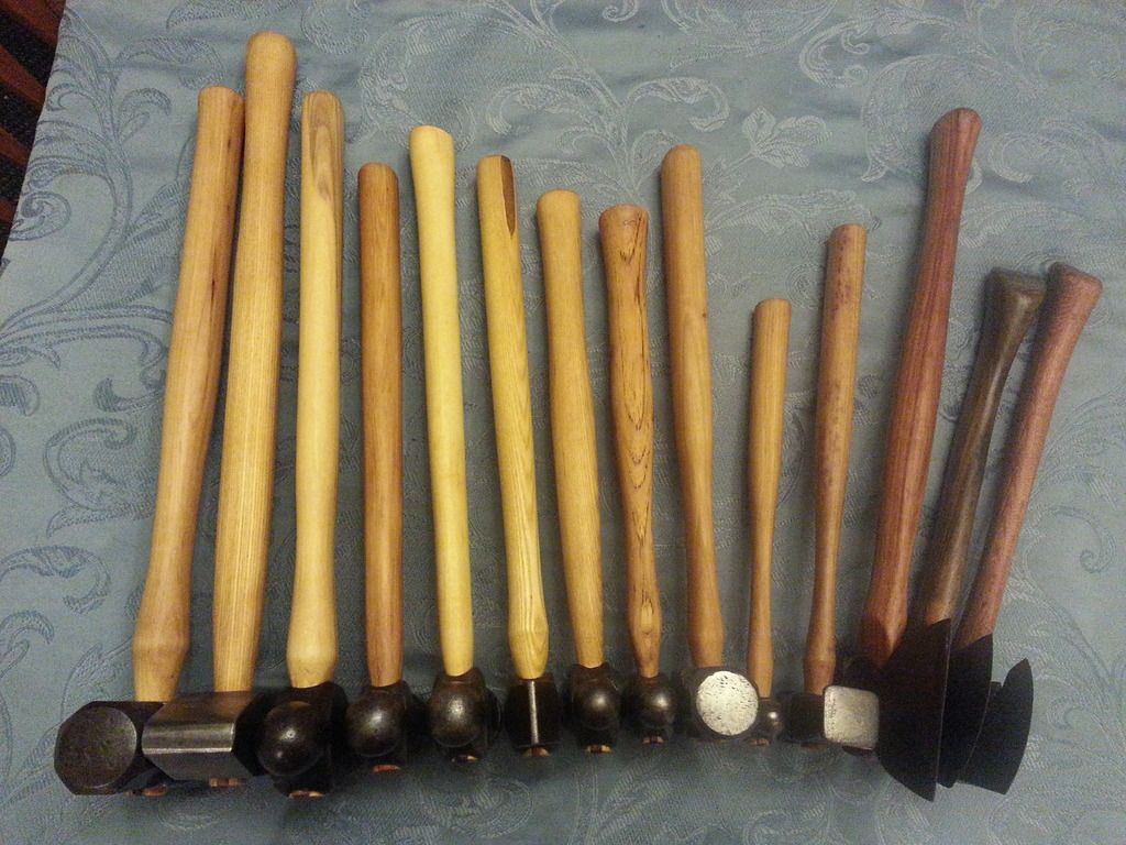

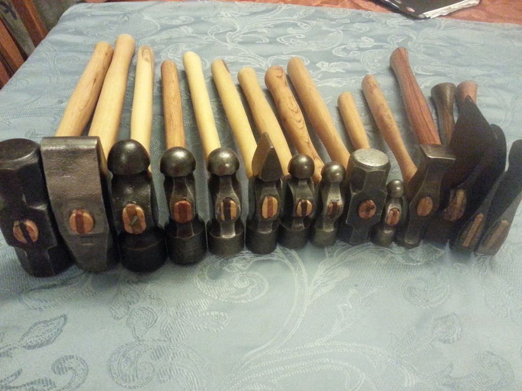

Well, not today for all of them, but lately. Some have been seen recently. Some are new hickory handles, a few ash, a few re-purposed handles, a few cut down old sledge handles and a couple have been hand carved from local maple trees. Most have BLO then BLO/beeswax/turp. Some fake tung, one Minwax followed by BLO then BLO/beeswax/turp. Some hickory wedges, some poplar, some walnut, some cherry, some mahogany. There are sledges up to 4lbs and ballpeins up to 3lbs plus hatchets. I like them all.
I like the straight peen. You don't see as many of those. And I prefer a straight peen to a cross peen at the anvil. I had Larry at Quick and Dirty Tools make one special for me.
Thank you Square_peg, appreciate it. I used the crosspeen to beat the mushrooming into submission on a Lakeside head recently.
In fact, those hammers I set up have seen more use than any sharp tool I have in the last few weeks. The handles are a bit scuffed now - which I think appropriate for what they are.

That is an impressive rack of tools – a shop full, no less. You don’t ever think, “If I only had the right hammer…”
Thinking I need to build a rack of some sort to hold my striking tools - feel bad stacking them head to toe in one drawer. They need to breathe ;)

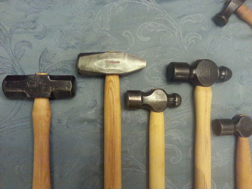

Thanks. I don't need that many ballpeins, but I like the sentiment. The best part is that someone could duplicate what I have done for maybe $30-35 tops for all materials plus effort.
Square Peg, I agree completely, that is my favorite and not for sale as I have never seen another like it. It is a Fayette Plumb anchor logo 1.75lb head, made like a ballpein and such a useful shape.

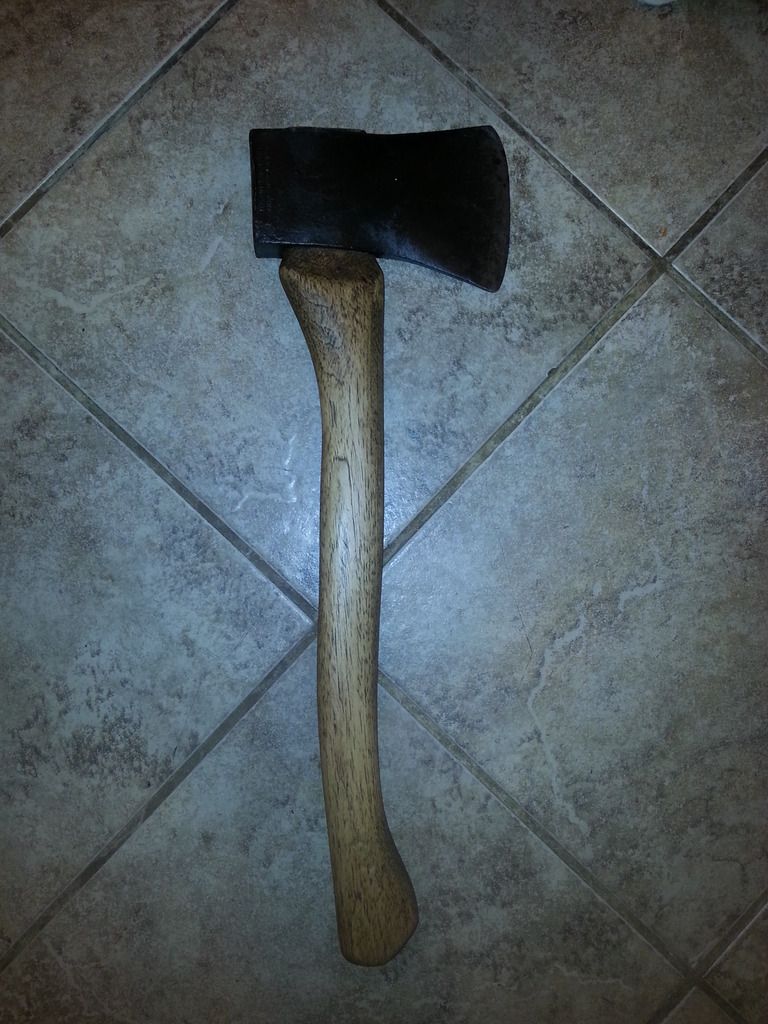

TT Flint Edge Connecticut Pattern, not sure on the weight but it's a big boy. Carved the handle out of ash, hit a few knots so she's not as symmetrical as I'd like and I've still got to decide a palm-swell shape.
