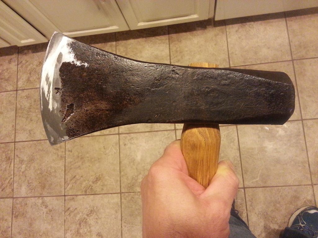

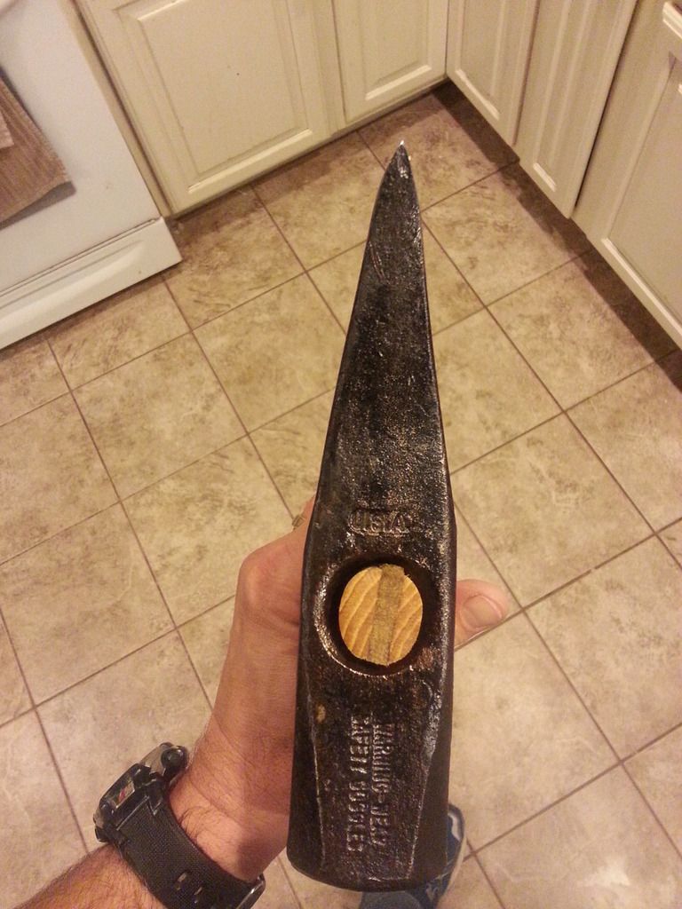

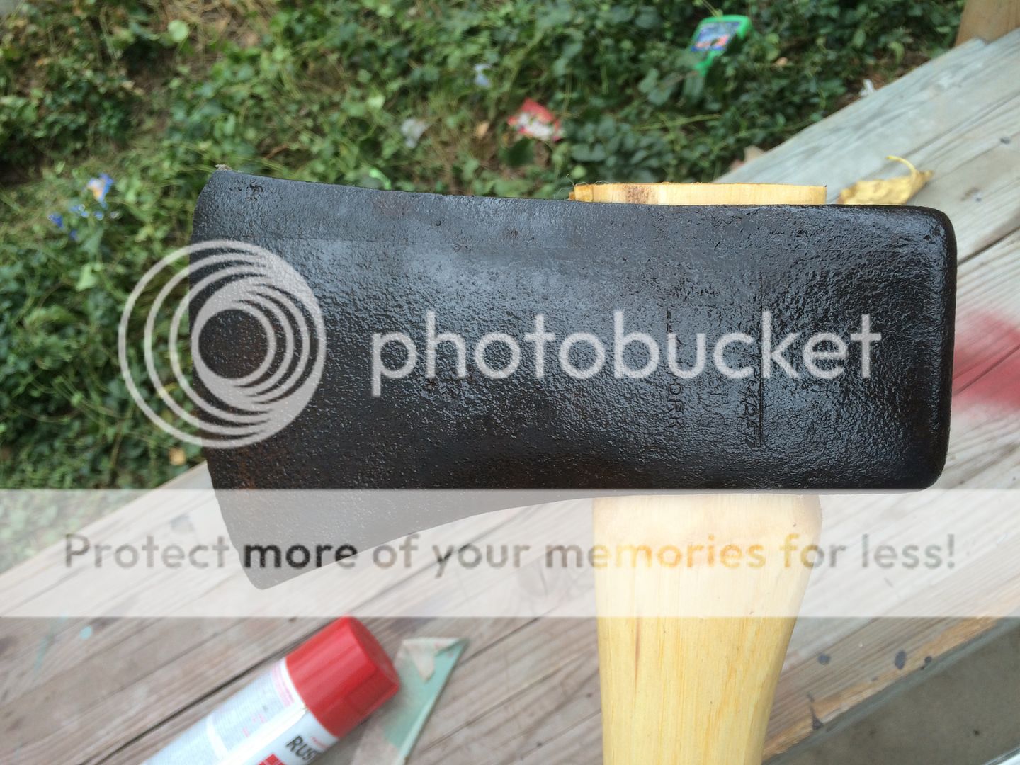

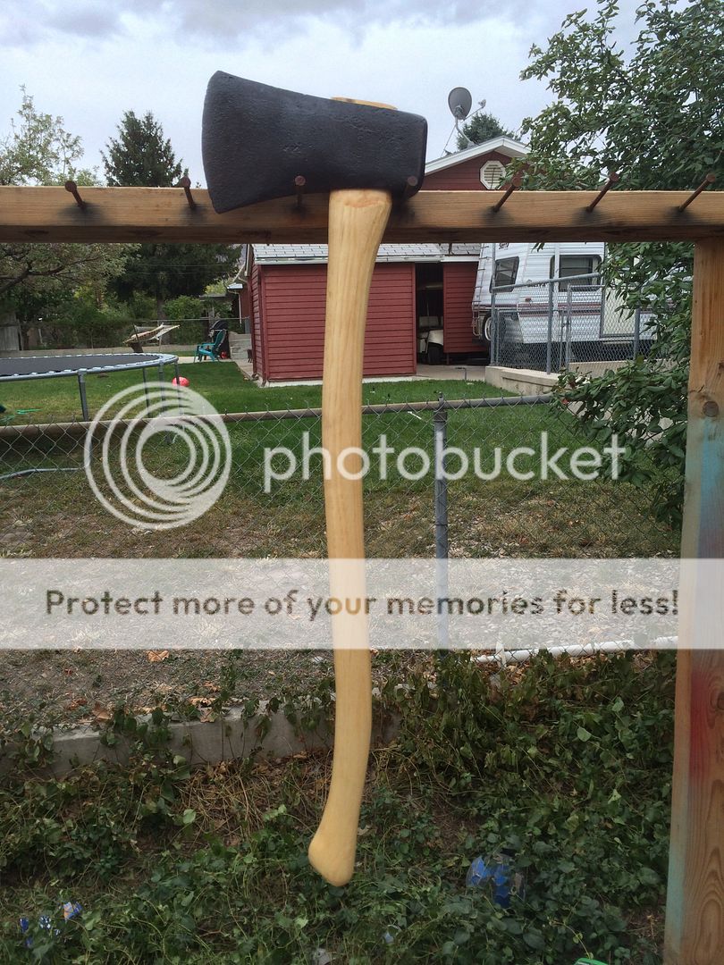

My maul finally broke, so I re-profiled a bit before putting it onto a new to me $1 NOS handle. It's a Stanley (USA) 8lb head on a 28.5" handle. I'm going to try to make no metal wedge work until it doesn't.
It should hold up OK for you. If it does come loose (and you can remove the haft) then next step is a wood cross wedge such as COTS does. Reprofiling blades on splitters is a situation where I am personally thankful that electric angle grinders exist; sometimes you have to remove quite a bit of material going back 2-3 inches in order to come up with some sort of decent tip angle that doesn't routinely 'bounce out' of a strike.

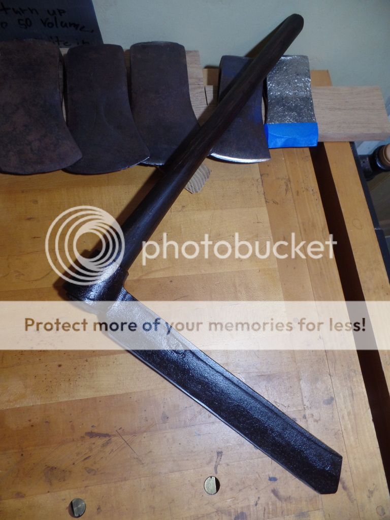

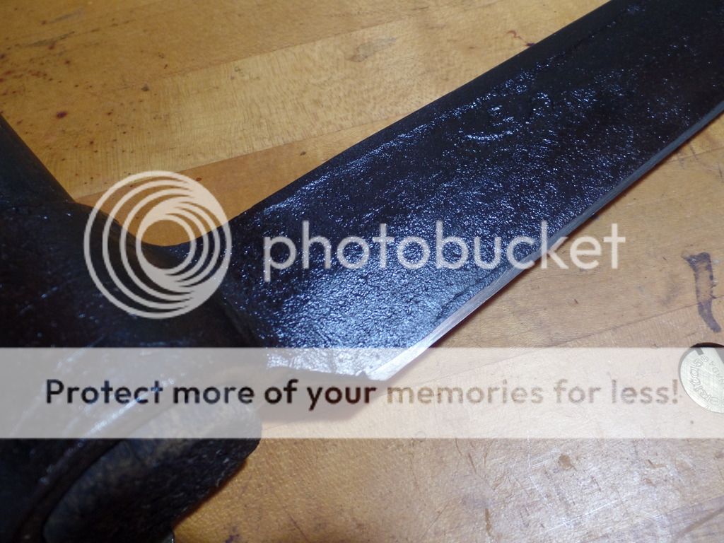

I refurbished my Klein-Logan froe handle with copious amounts of BLO, tuned its edge back up and stuck the handle back in it.
The handle was extremely weathered and I wasn't sure about reusing it. It soaked up so much BLO that it got really heavy and turned black. I love it and am glad I decided to save it.

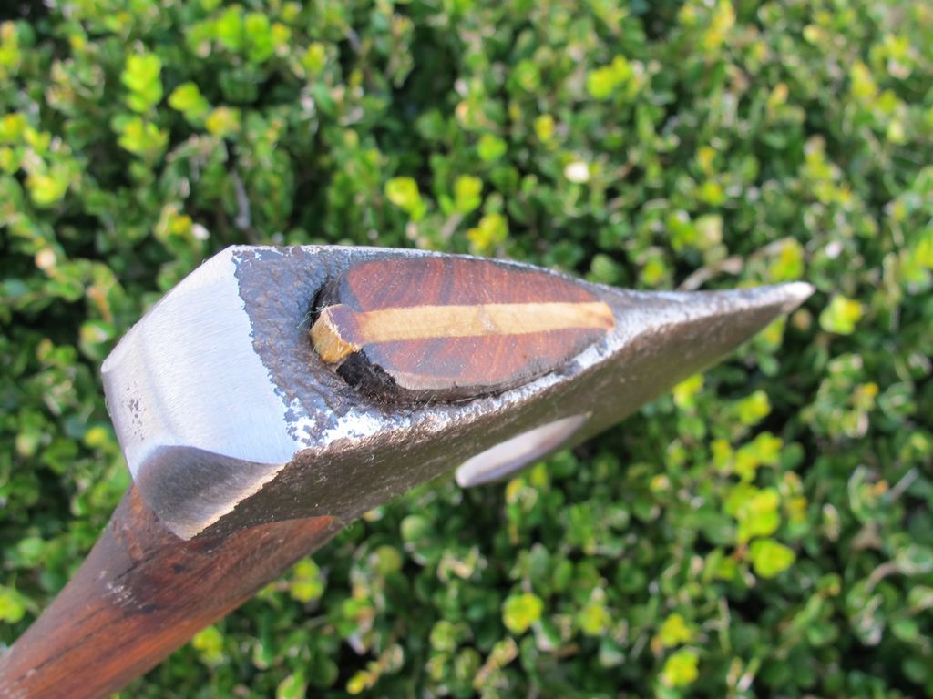

Played around with this rusty old thing,
WTH. Pitted old thing. Might as well have some fun with it. I just cringe when I see people doing that to good axes.
Of course with the very short eye the handle won't stay on it for long. But for a light duty carver that could be a very good axe.
It's amazing what several heavy coats of BLO will do for a badly weathered haft. You can literally feel the strength coming back to the wood with each coat. I brush it on weathered hafts. And slather it on the end grains where it soaks right in.
I just stuck the end of this handle in a bucket of BLO and flipped it to soak the other end every couple days for over a week. I also sanded and slathered the rest of the handle twice a day for a few days, maybe a week, until it would only take once a day for a few more days. It took about 2 weeks before it was fully saturated.

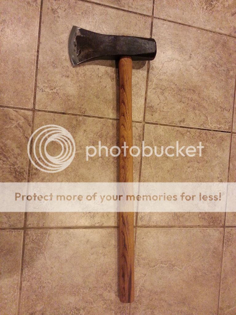

Awesome axe, but I don't think that it's a rafting pattern. It looks like a Dayton that maybe had the poll rounded a bit to repair some minor mushrooming. Whoever did it did a nice job.
The poll is beveled and hardened. The bevels just aren't as pronounced as they are on some others
