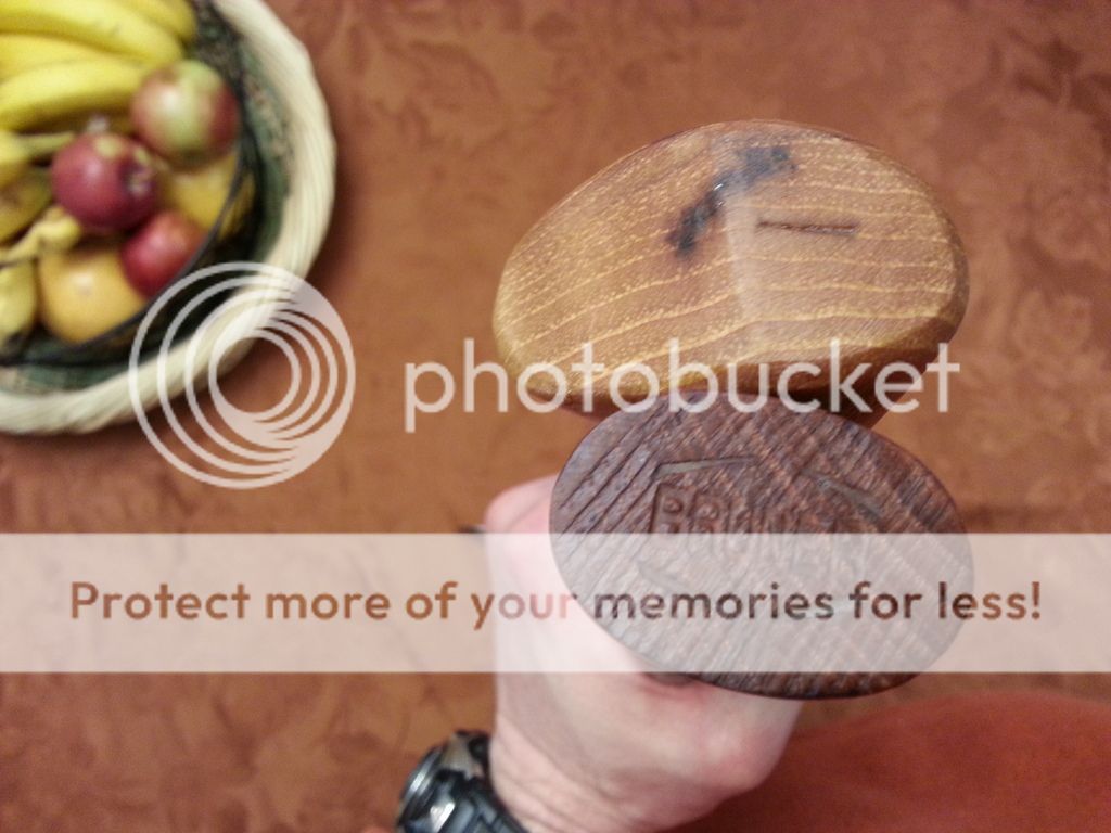

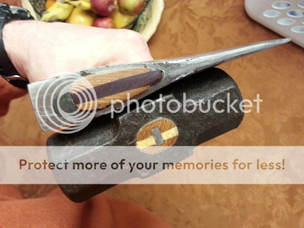

I have not done anything in a while and finally got the urge to do a few again. Here are the first two, an ACME 2.5lb sledge and a Warren 1.75lb large hatchet. Both are on old NOS replacement handles that I sanded, oiled and beeswaxed. The hammer has a poplar wedge, the hatchet has a purpleheart wedge. The hammer is 2.75lbs total and is 15.5" long, the hatchet is a bit under 2.5lbs total and is 17.5" long.
I really like the unusual curly figure in the hatchet handle.

Looks like a million bucks to me! Unless someone tells me softwood wedges remain 'springy' as compared to hardwood I suspect softwood was used because of it's compressibility and void-filling traits.
Something I forgot to mention: use of hardwood wedges and driving them in hard within a factory setting resulted in cracked heads every now and again. Using softwood (apparently Yellow Poplar is favoured for this), by virtue of being much more forgiving, avoided this. Us mere peons without hydraulic presses, or paid by piecework, can be considerably more careful in setting a wedge.

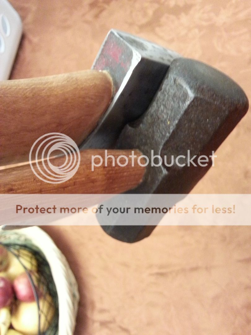

I finished my first rehang - this presumed old woodslasher. I had to shape the handle I bought pretty extensively. Unfortunately it did not quite have the width to fill the eye. I don't chop often, but it seemed to pass the test afterwards though.
I finished my first rehang - this presumed old woodslasher. I had to shape the handle I bought pretty extensively. Unfortunately it did not quite have the width to fill the eye. I don't chop often, and it seemed to pass the test afterwards though.
Your first rehang is excellent.
Heck yeah!
Looks great! I like it.

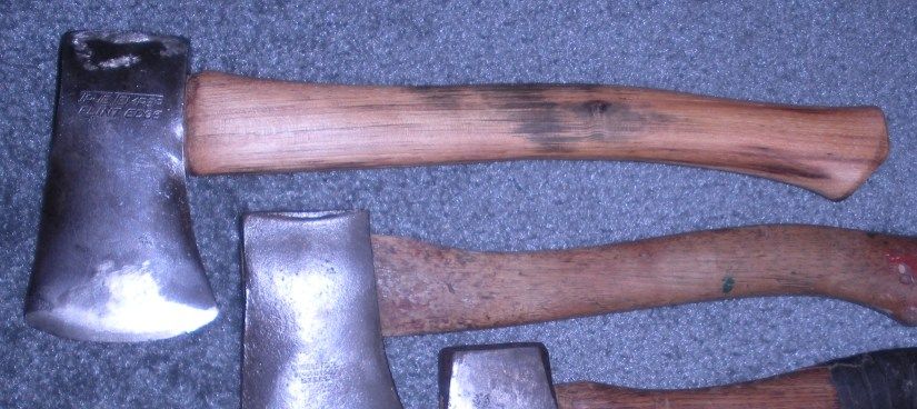

This one came from an estate sale for less than a dollar. Not sure if this would be considered a Jersey pattern head, or something else? The vintage replacement haft was just sorta stuck in the eye, so I carved it down to fit better & rehung it.
I don't think the red paint is original, and it looks pretty bad, but it actually did a good job of protecting the steel.
The bit/edge on this one is much thinner than any other (full sized) axe I own. Not sure if my others are just worn that much, or if there was a particular reason for it. Once I finish polishing & honing the edge, it aughtta cut deep.

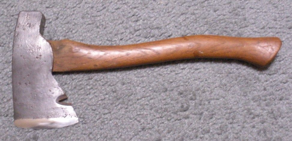

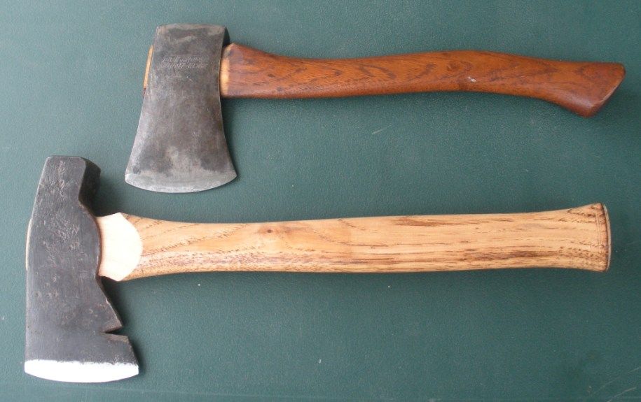

This post concerns two different hatchets I've had for a while, that needed different handles. The fist is a Keen Kutter flooring hatchet that's like the True Temper Dynamics. It came with a curved handle that was really too small for it, but I couldn't pass it up for only a dollar. I asked about it earlier in this thread: http://www.bladeforums.com/forums/showthread.php/1340990-Should-this-Keen-Kutter-tomahawk-have-a-straight-handle?highlight=possum

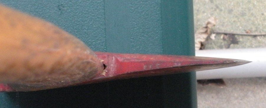

The second one is a small Flint Edge that someone else had rehung. It was hung really open (worse than the picture shows).
The handle was fat and straight, and the perpendicular grain orientation meant I wouldn't be able to put any curves into it without serious grain runout. While this haft was serviceable, it just pissed me off every time I picked it up. The head is really sweet with great geometry, and I thought it deserved better.
So, I finally broke down and ordered a straight 16" haft for the Keen Kutter through my local hardware store. It was the longest they could get, and I didn't like the head enough to go through the effort of carving my own from scratch. I salvaged that slender curvy haft it came with, and put it on the Flint Edge, and now it feels awesome.
