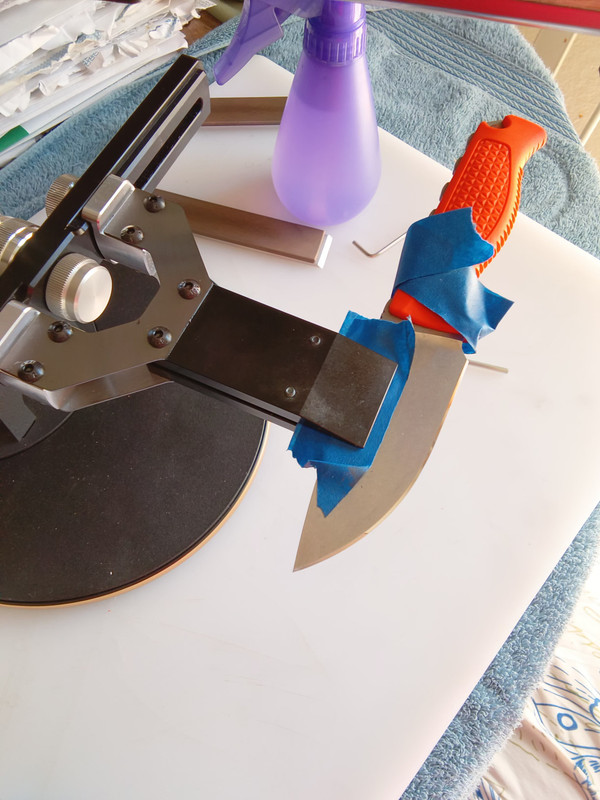

Benchmade something. Their really thin flat ground skinner. s30v.
12.9°, 2000 GBN, 3 micron strop. And I found something that smooths out the higher grit stones. I've been using a tiny spray bottle to wet the blade. Keep the dust down and lube it a little. Plain water is horrible. It'll bead up and I swear I can feel the stone glide on top of the water. So I put a dab of soap in the water to break the surface tension. That was better but I could still feel the stone ride on top of the water and it continued to bead up (surface tension).
Sitting there, cleaning the previous grit slurry off the edge with rubbing alcohol. I noticed if I left the rubbing alcohol on the blade. The stone moved smoother, bit the metal more, and things stayed cleaner. So I poured out my spray bottle and refilled it with 50% rubbing alcohol. No more of that feeling the stone gliding over the water. No more beading up and you can see micro bubbles form as the stone moves across the edge. Plus, wiping the stone off afterwards, it comes out cleaner.
In other words, I found my perfect mix of water. The 50% rubbing alcohol. Now, I need to pick up a couple more bottles to have on hand.

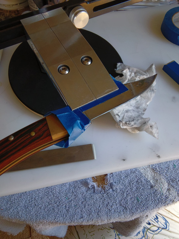

Another friend's knife. Good ole' Buck 110.
When you hear about a particular steel being an absolute pain in the butt to sharpen. It's usually some steel that's a dream to run an edge on. They've never tried Buck's 420hc. It's like grinding glass. There's close to an hour in this knife. I started at 400, refined that with 600. The apex was frustrating, but know, it's true and straight.
I'm not done. Oh No, I'm going to run a 1000 grit over it. Then the strop. If this knife had been M4, I would have been done 20 minutes ago. 420hc sucks to sharpen. But it'll shave a frog after I'm done.

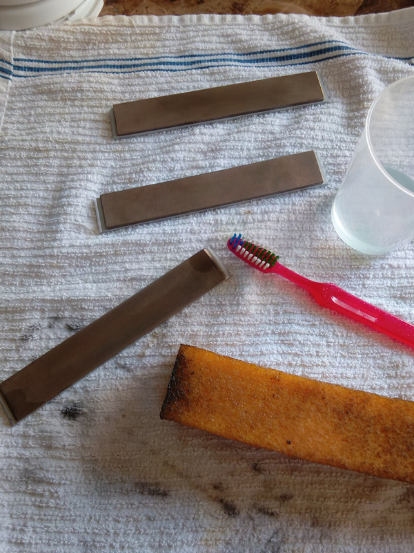

Devised a way to clean GBN.
Make some DIY Dawn Powerwash®. Which is Dawn dish soap with an alcohol added. I'm using 70% rubbing alcohol with some Dawn squirted in it.
Wet the stone with the soap solution and then scrub it around with a stiff toothbrush. Follow that with a sanding belt eraser (I got mine from Harbor Freight). Using more soap solution with the belt cleaner. Scrub the stone, rinse it in the sink, and then dry it off.
Notice the deep black on the edge of the belt eraser,
