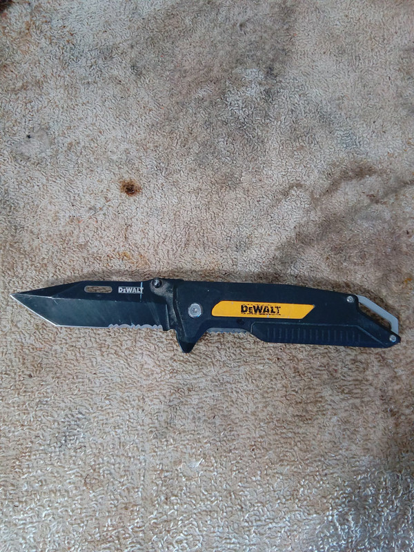

A close friend that does rental house remodeling. Has a couple of the Dewalt knifes from Lowe's he needs sharpening. No idea about the steel used.
I'm going to do a dual grit on one and a 600 grit on the other. Then see which one he brings back to me. The lower shelf Chinese steel seems to enjoy a dual grit edge. But I want to see it after some real world use. Not cutting rope, boxes, or paper. I want to see it with plastics, wood, and whatever else he's going to use it for. Actual tool knife use. By someone who has absolutely no clue as to what a dual edge is. Just as long as it cuts.
240grit with 1000. The 240 side at....maybe 20°. The 1000, 16°-17°. Honed on a ceramic rod, center that micro burr that makes dual grit plausible.

I got an ESEE Xancudo a while ago and sharpened it but realized I didn’t post about it.
Here it is:
I used the usual setup of 400,1000 and 3000 grit vitrified diamond stones followed by 6micron and 1 micron diamond on leather. BESS was something around 120 if I remember correctly
The factory edge is steep on these. I reprofiled it at 20.5°. 600grit finish with a 1000grit hone. No stropping.
It's not a slicer but it is a cutter. Not at 20.5°. What would you expect for a construction knife? This knife isn't bad at all. No blade wobble and it locks up tight and firm. The only thing loose is the pocket clip. Which says something for being a hard use tool.
Anyway, it'll be the sharpest thing my friend has held in his hand since a while.
