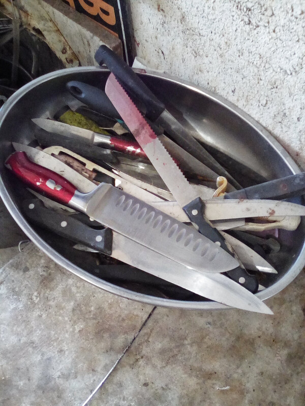

I'm kinda tired of sharpening the junk kitchen knives. I mean, they work just fine. Rarely get dull from chopping jalapenos and onions. The occasional chicken breast. Potatoes.
I want something nice. The Global is $100 and the equivalent in Wusthof is $143.
As for the cheap knives. I got my fill,
