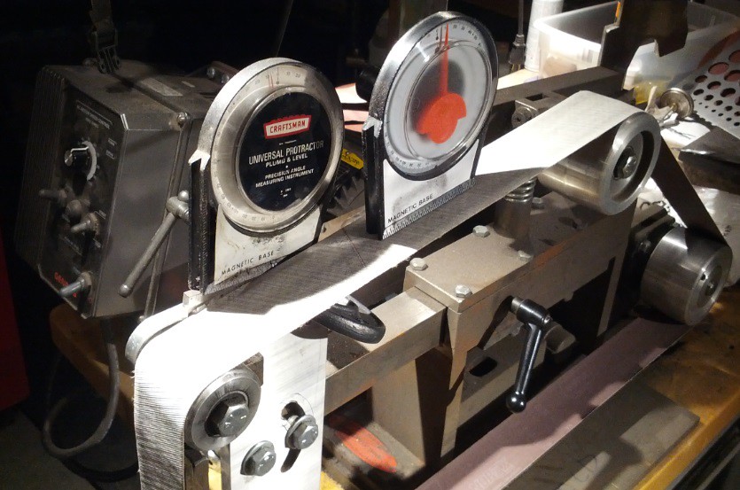

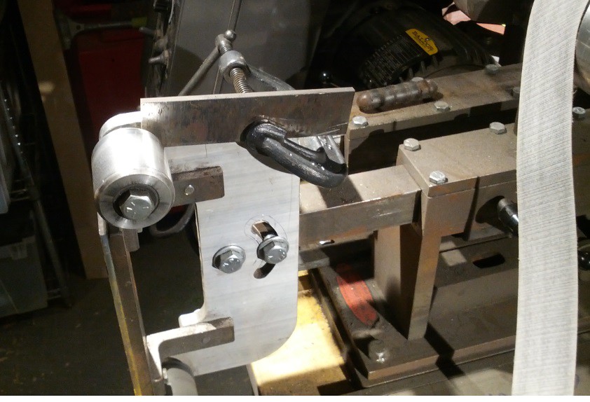

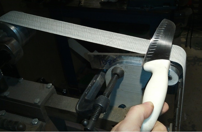

I use a jig to sharpen with my KMG. It is likely the simplest/cheapest jig ever made (C-clamp and a flat piece of steel), but it works for me. It is quick and easy, but it does require a variable speed as well as a reversing switch on the VFD controller. This technique produces a convex edge.
I use three belts: 220 Jflex, 400 Jflex followed by 16x NORAX. I run the belts at the slowest speed possible (a couple feet per sec) IN REVERSE and sharpen above the top wheel of the platen arm. Pics will help.
A simple piece of 0.25 blade stock (any steel with a flat edge will do)

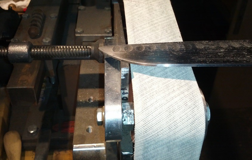

The jig is used more as an angle reference rather than a guide. If I start with the correct angle, it is much easier to hold it fairly accurately. Once I have the angle, I move the blade maybe a half inch up the belt to sharpen, so the side of blade does not get scuffed on jig. I have thought of making it out of bronze/brass, but steel works.
My view as I sharpen.
I use a magnetic protractor to measure angle on jig and angle of belt. Edge bevel is the sum of the two.
After the NORAX (Thanks to Butch for introducing me to them), I strop with green chrome on leather strop.
Yes, it is a crappy commercial knife. I have lots of them. Can't let the kids or wife use my Harners or my Ealy petty; somebody might get hurt. -Doug
