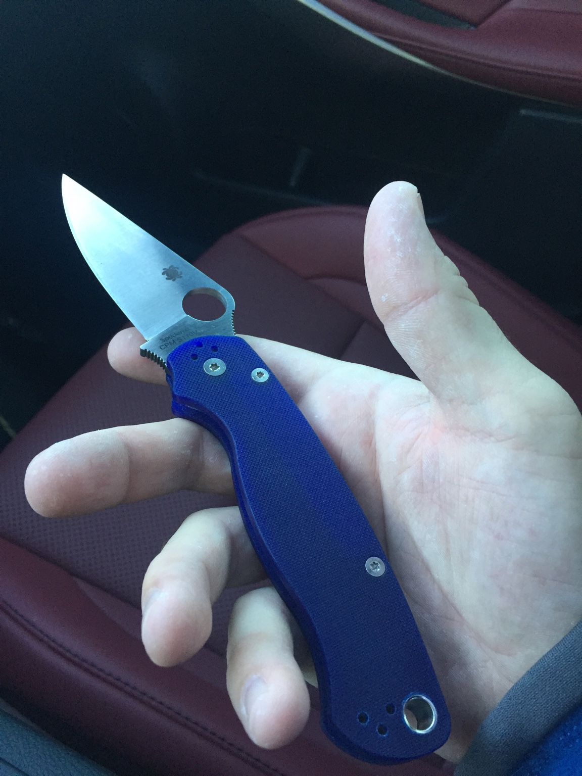

What do you guys think of the S110V PM2 Blurple knives?
I don't like the color at all. Aside from that, I'm sure it's great.
Waiting for red frn handles. ;)
I'm not sure why but I didn't like the PM2 in this color but I do like the Manix 2. So maybe I just prefer the Manix 2. I still want one of the new PM2 M4 exclusives.

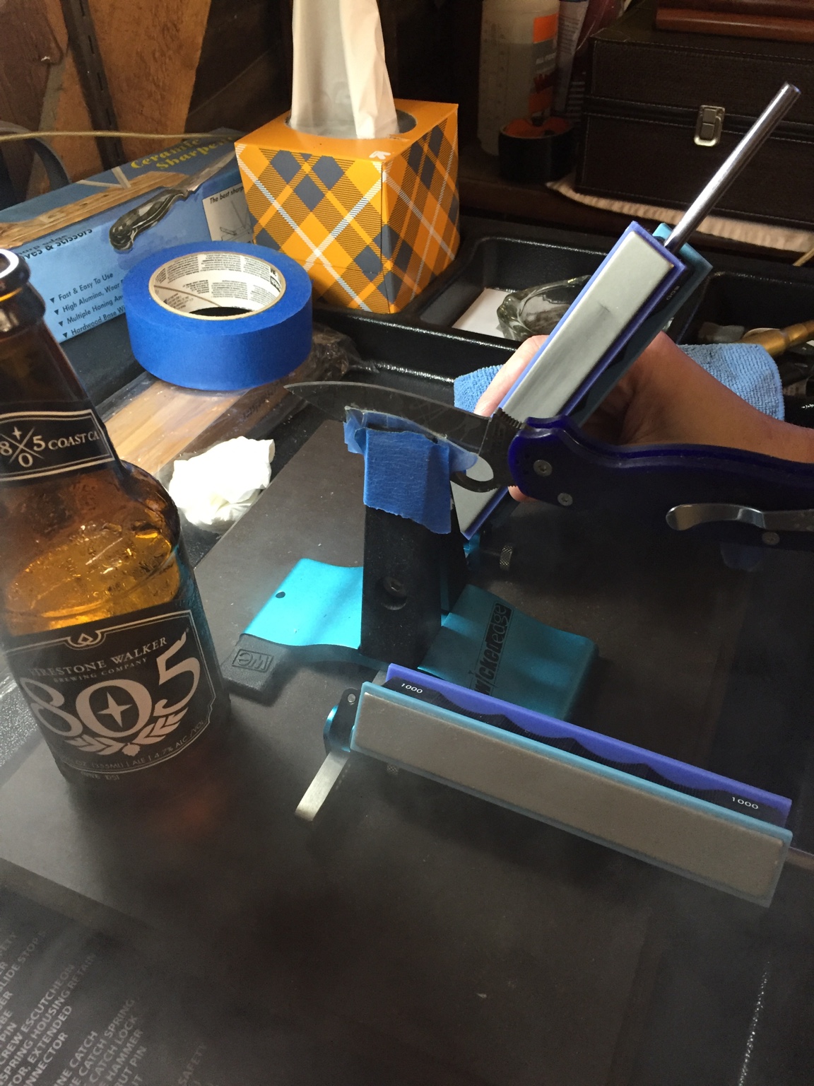

I had my S110V Para 2 reground by Tom Krein to .006"-.007" behind the bevel. With the edge that Tom put on it it could catch some hairs above the skin and pop hairs nicely. I EDC'd it for about a week and a half, then decided to cut up a decent sized double thick cardboard box into a bunch of tiny strips. By the end of the box it was pretty much dead dull, and cutting by the very thin grind more than by being sharp. That performance didn't blow me away, but it wasn't terrible, either. I usually give a knife 4-5 sharpenings before making any conclusions about its edge retention, as many times the edges get burned in production, and you need to get to some fresh steel to see the true performance of the steel.
I just resharpened it at about 11 degrees per side, up to a Shapton Glasstone 500, then did about 8 passes per side on a 16000 grit Glasstone at 15 degrees per side for a toothy edge with a microbevel that slightly polished it. It's catches hair above the skin, pops hairs, and easily push cuts phone book paper at a true 90/90/90 (cut straight down into the paper, perpendicular on all planes), so it has good push cutting sharpness along with very good slicing aggression. This edge is actually very comparable to what Tom Krein put on it, and he is well known for very sharp, toothy edges, so I am liking the grit combination for this edge. I'll have to see how it holds up for me.

That's pretty much the total opposite result from what Ankerson saw on a .005 regrind on, I think the Manix 2 LW...
S110V with a grind that thin should slice cardboard for days and days before it even starts to lose it's edge.

I'm aware of Ankerson's results. I'm just reporting the performance I saw with my knife, with the cutting that I did. I usually sharpen my knives several times before trying to draw conclusions about how they perform, as it isn't uncommon to get a knife that had the edge burned leaving the factory. Usually 4-5 sharpenings get you to good steel if the edge was overheated. Also, that cardboard box was a double thick box for a computer, and some cardboard I've cut can quickly blunt even the best blades if it is full of impurities. It is much different than cutting just new, clean rope. I cut that box into a lot of tiny strips, possibly 100' of cutting. If I was cutting that same box side by side with another blade of known performance it could have helped see the comparative performance. Also, after the cutting it was roughly slicing printer paper, with some catching. To me that is very dull. To many others that is more than acceptable. I'm sure the blade would continue to cut effectively at that reduced sharpness for a very long time, mega carbide steels like S110V are known for that. I'd rather touch it up or grab another knife that is sharp rather that cut with a blade at that vastly reduced sharpness, but that is just my personal preference.
Edit to add: I don't care what steel you use, you will never cut "days and days" before starting to lose the edge on a blade. Initial sharpness falls off very fast, then it starts to level off and drop off much more slowly. This is what people are referring to when they talk about holding a working edge. The working edge isn't close to the hair popping, or hair whittling edge that you initially start off with.
