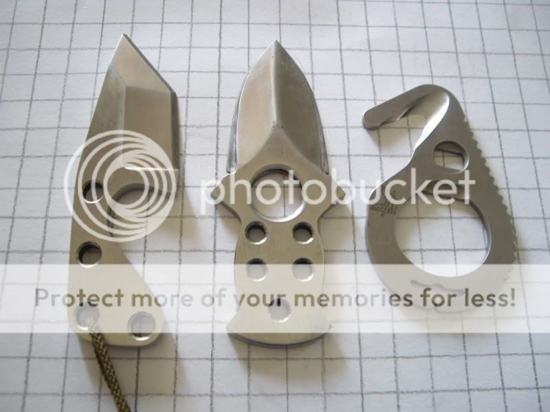

Have any of you blokes seen the Leilira and minitan?
The Leilira is based on the traditional stone knife of the Indigenous Australians A spear shaped blade of stone gummed onto a short handle.
This version was made at the request of Bob Cooper a West Australian survival instructor ( I think he did do some guest work with David Alloway.) Bob wanted a small fixed blade double edged knife to fit in his MkIII survival kit. He wanted two edges one ground steep for heavy work and the other thin for skinning and fine work. a curved pommel for crushing fibers or seeds, softer steel chisel ground to make it a bit easier for the inexperienced to sharpen, plenty of lashing holes to extend the reach of the knife for cutting fruit, vines or leaves ( palm fronds?). The large hole make it surprisingly solid grip considering. The sheath is designed to hand around your neck but you have to take it off from around your neck cumbersome, but very secure.
http://www.equipped.org/cooperkit.htm
But an over enthusiastic customs agent seized a consignment of these knives ( they were being manufactured off shore to keep the cost down) even though they were being sent immediately to troops serving in East Timor at the time.
So Keith Spencer ( long time knife Advocate here in OZ) who designed the original redesigned the leilira to keep the original requirements and still pass customs. Ta-daaaaa the minitan ( mini tanto).
I just searched Keiths site
http://www.knivesaustralia.com.au/akc-homepage.html But there is no listing for either the Leilira or minitan on his site he is a couple hours behind me I'll ring later and post here as to whether they are still available.
A pic with a Benchmade rescue hook for size the back ground is a 10mm grid ( around 3/8ths of an inch)

Warrigal, yea I have seen them knives like Cooper had. I think they are a great back up and they really do work as seen in this pic I processed a turkey with my Final Option Knife last spring just to see how well it would work. Is it the best for the job NO lol but it did work and it is way better than a razor blade. Well lol I think so.
Those smaller knives really have there place in the survivors pack. again it is advantage. One knife it great but having several of them and in the layer of your survival kit will great inhance the over all survival situation.
I like the pic of the left one over the double blade one in the middle. I am going to make one of them up like that but with out the tanto point. I am not a big tanto point lover lol
