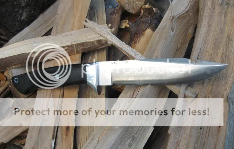

Hi all, just for fun I drew up a design and mixed a couple of other knives that I have made into one.
the sheath will be something like this with a pouch for a sharpener and then a either a firesteel or a spyacapsule with a firesteel rod and tinder all in one package and I am thinking with a pouch for a smaller fixed blade with either tin scales or even no handles on it like this pic. all shiny steel and chicago srews can be darkened.
Mistwalker and I have been talking about a Sojourner blade shape with a One Zero handle. The spine on this one has the bevel like the Sojourner knife.
It really has a sharp point when you grind the spine like that.
I also did not draw out the slanted guard with as long of tines like the Warthorns or the One Zero knives.
I made a pattern already and the more I hold that pattern I am like yep this would work. I love the slanted guard it really makes holding and doing the 5 Grips that Ray Mears talks about in his book when doing woodcraft projects. I have never used a design yet that made them 5 grips to comfy as the slanted guard design does.
I know some have said that they would only need a SAK or a Multi tool and that is ok but I tell you this. If you ever were to fall through some ice, reaching into your pocket and then tring to open that SAK or Multi tool up and then jabbing that thin stock SAK knife into the ice to you can hopefully pull / crawl your now very heavy WET weight out of that situation I would like to see that done. Oh and since it is a folder it is possible that it will fold on your fingers YIKES. One other thing if you really had to defend or even attack a 2 or 4 footed creature do you really want a SAK or a Multi tool for that type of situation? Now I sopose you could have sharped up a stick with a nice point on it for that type of situation with your SAK or Multi. That is a thought. ;)
I know for myself I want to have as many ADVANTAGES as I can get. I think most of us even the pilots could carry a 4" to 6" fixed blade day in, day out, everyday and then a SAK or multi tool, plus a couple of What the United States Rescue and Special Operations Group says to carry as a final back up peace of sharpened steel.
When all else has been lost. Like Final Option knives.
with your First line / Final Option kit.
The more advantages that you can give yourself the better:D.
If we get rain on Wednesday of this week like the weather man says I will be in the shop all day and this knife in the drawing will get started on.
Well what do you think?
Bryan

Agreed. And I think you'd better get grinding! That's a good looking design Bryan. A 5.5" blade seems excellent and there are some standard jump sheaths that will accept that blade length. I like the blade shape and versatility. I might make the tines of the guard a little shorter even, but I really like the fact that you have an integral guard. I like the exposed pommel too. It could be used as a scraper or struck when using the knife as a chisel.
Your sheath could probably work if a retention thong were added. Remember, in this situation the knife has to stay with you! Being throw from a rotary wing or ejected from a fixed wing will impart big G-forces. That knife has to be there when you regain consciousness. Security will be paramount.

Rotte, Yep I think the more advantages you can have on your side the better. And it does not have to be with just knives, It is ALL of it, like
harpoon41 said on page 3 of the thread. Comm., Food and water( speaking of food if you really want to put some great food bars in your kit get some of the Met RX bars, I learned about them from the US RSOG forum they will beat out a Nature valley granola bar any day of the week), Heck having a great pair of boots for the enviorment you are going to be in can sure make life alot easyer.
ADVANTAGES the more the better right? I love multi tools and paired with a fixed blade and there really is not alot that combination could not do in helping you get out of a possible SERE situation.
Speaking of harpoon41, Rotte you mentioned the retention of the knife in the pic I posted.
1. If you noticed the retention strap is on the SIDE of the sheath where the spine will slide out, NOT on the Cutting edge of the sheath ( that was a request by mistwalker when I made the sheath up for his Warthorn and One Zero knife. I liked that idea so much that I now do that for all the Warthorns and One zero knives and soon to be the SERE 5.5 ;) LIKE MOST knives sheaths seem to have. The retention strap is on the cutting edge side or even wrapped around the knife handle.
Being able to keep from cutting the Retention strap seems like a good idea to me. Again any advantage is better.
2. the actual retention peice in not a snap for Steath resons ( remember steath can mean the difference between life and death how many tactical knife sheaths have you seen with Velcro I have seen a few, that does not sound to stealthy to me).

3. This type of retention strap is great incase you were to be in a cold climate and some how get your knife sheath wet say like falling in to water or falling through ice. If you happen to have a knife sheath with snap for the closer. fill the sink up in your kitchen and then put your sheath down into the water for a couple of minutes like if you were in the water for real and then put that knife and sheath into the deep freeze for a couple of hours.
The point I am makingis the SNAP freezes and is hard to get UNSNAPED. Try it and see. This is why Grohman knives has this type of retetion ( button stud) on there #4 survival knives. The Canadain hunters that have fallen through the ice and then got them selves out of the water by the time they reach the place to get a fire going and then reach for there knives the snaps were froze shut. In cold weather it really does not take a very long time to have water freeze on you or you gear if you have gotten wet for some reason.
Again I think this is just another advantage.
Rotte, I tell ya if I did not belive in this retention set up I would not have it on my personal knife sheaths. if they can go through what I put them through with my work then I do not know what to tell ya. If I thought there was a better retention then I would have it. Rember I want every and any ADVANTAGE for me. Scew the rest of you guys lol You know I am just kidding with ya LOL LOL.
Thanks, Gald you like the pic.
When it is done do you want to test it out?????????
I am going to see about making this jump proof with some kydex and some leather. I have an idea on how I am going to do this. anyways let me know.
I hope that kind of answers your ?s on the retention part of the sheath.
