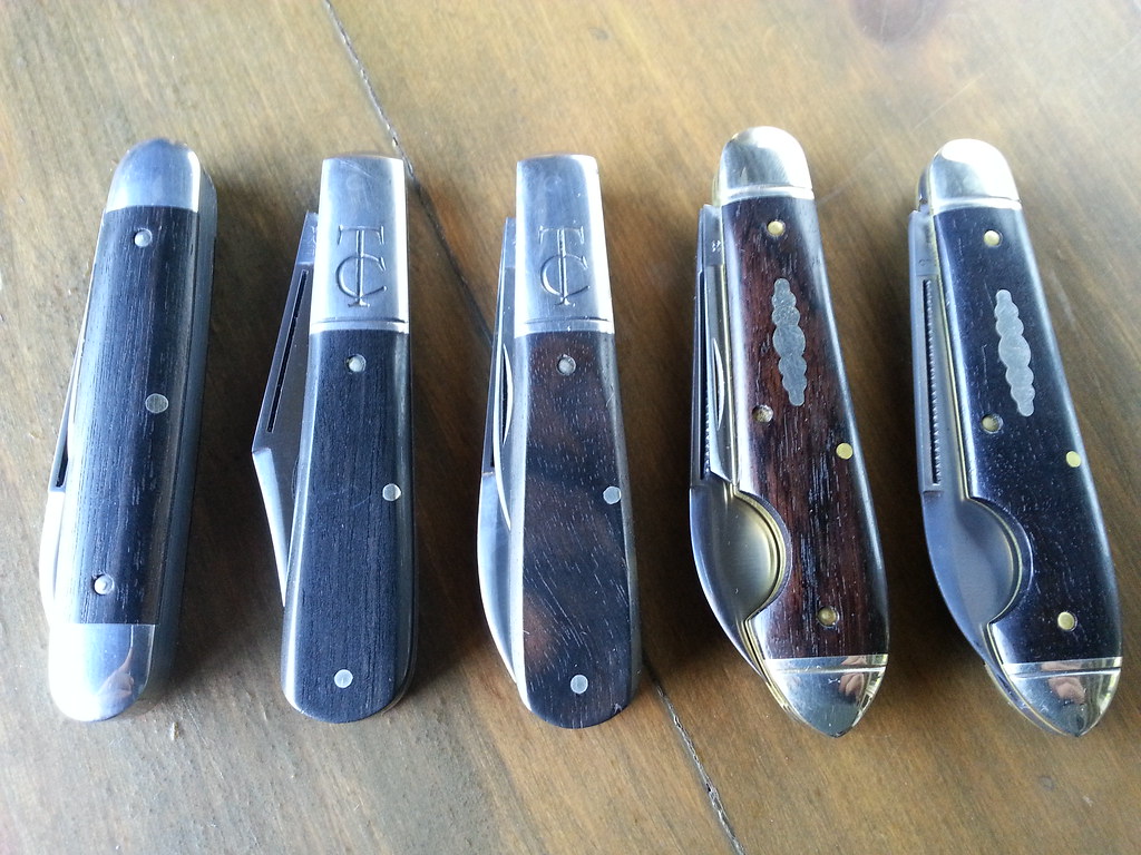

left to right, stabilized Walnut, Macassar Ebony, Gabon Ebony, African Blackwood

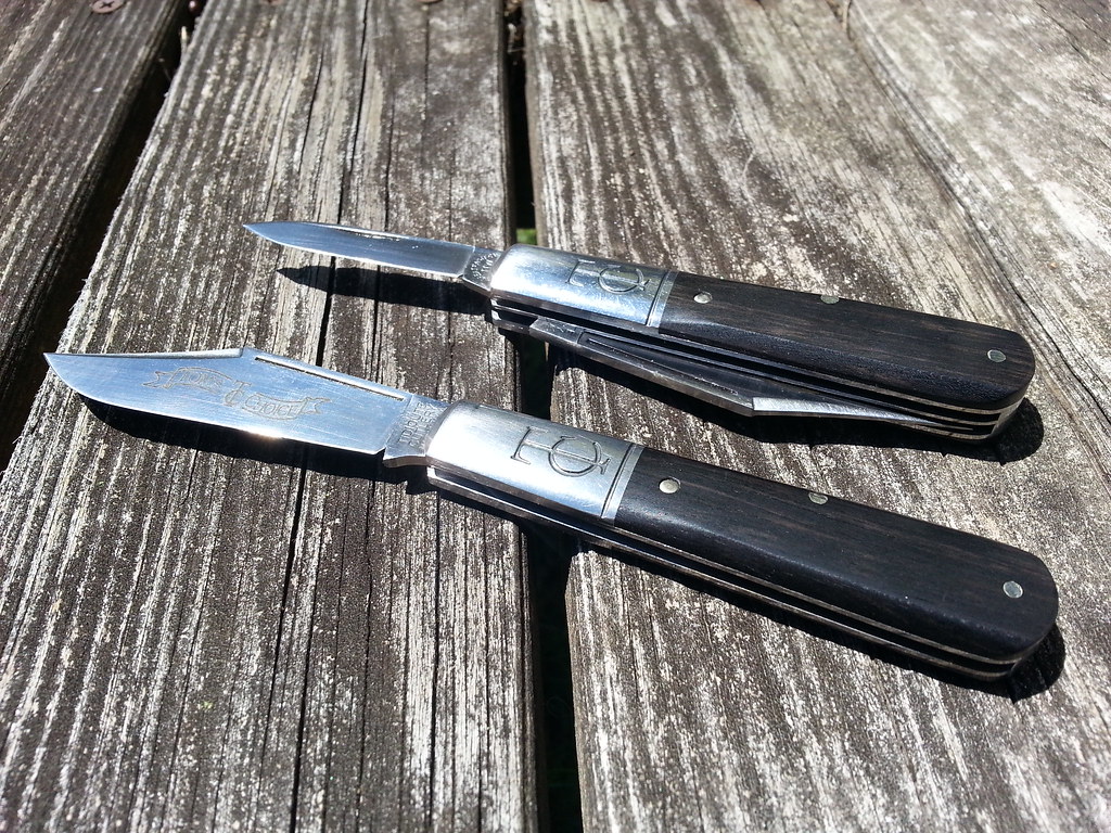

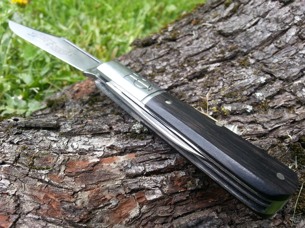

and a picture of course, sun setting behind me as I was coming up the steps of my deck :thumbup:
Then one against the sun---I like how it highlights the needle like tip on the Clip ;)
Paul

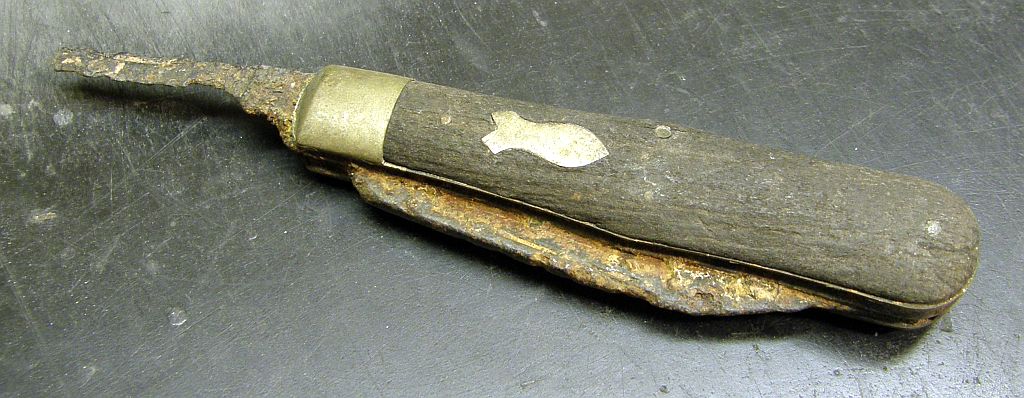

I have a bench sat outside my house made 100 years ago from teak taken from a ship which was captured at the Battle of Trafalgar (1805). The teak is hundreds of years old, and apart from being sunk at least once when it was part of a ship, it's been sat out in the elements, in a British climate, as a bench for the past century. It seems to be getting on OK, and teak is hardly the toughest of woods.
Wood doesn't need to be a hardwood species to be resistant to water. I believe much of the Australian red cedar that was chopped out of the Sydney area and also down here in "the gong" was made into piers and piles for the London docks. Its a softwood but water resistant. Much of it is probably still there.or so I read.

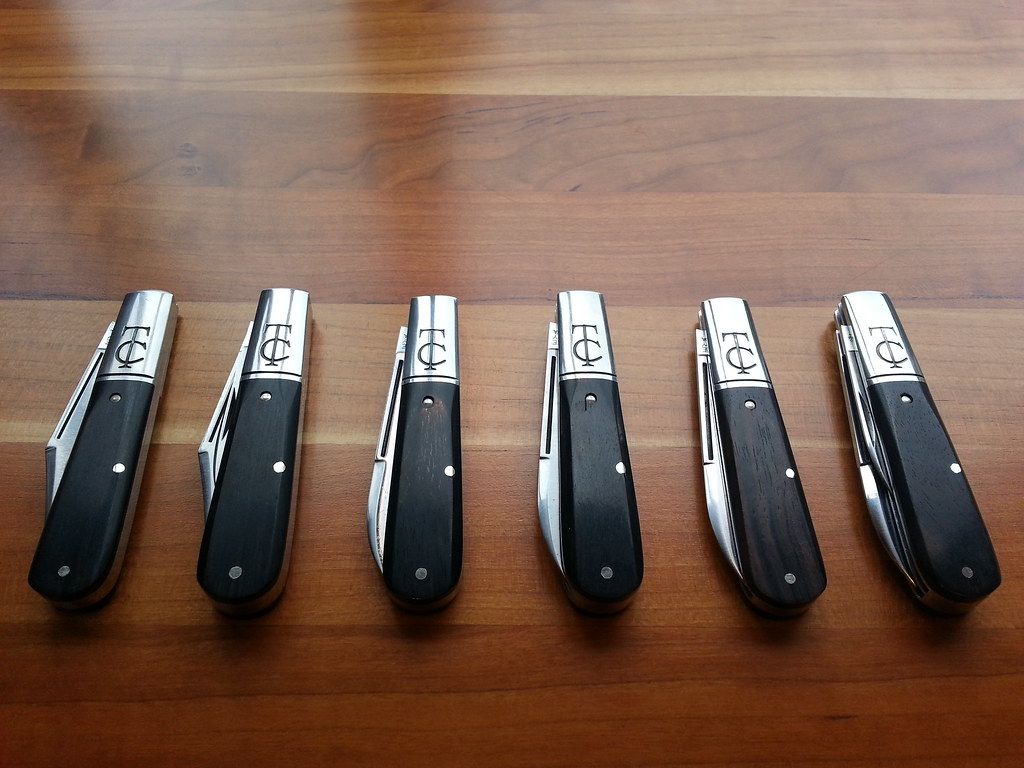

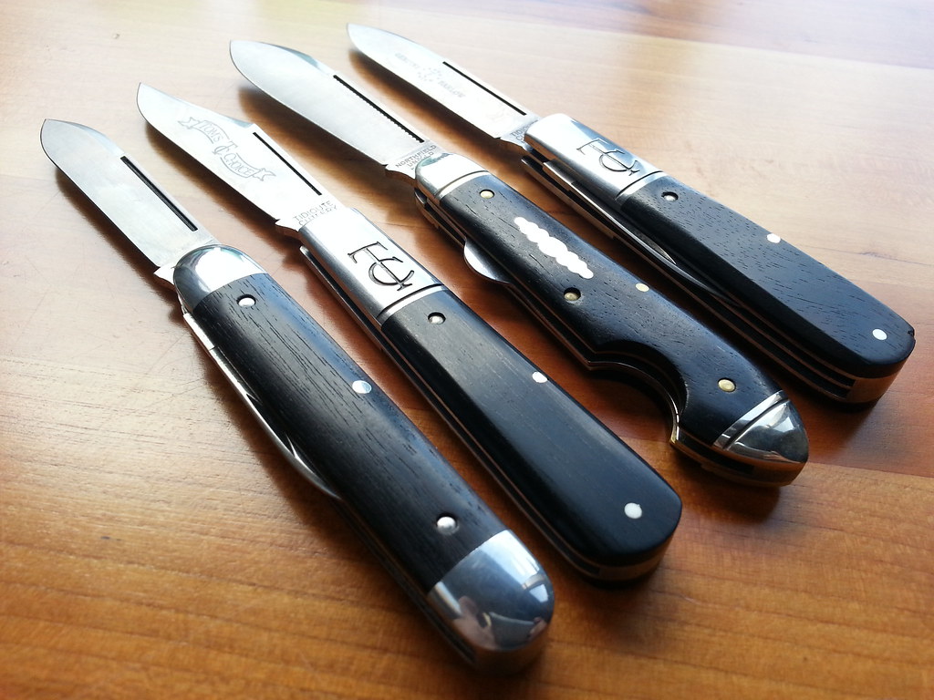

This page calls for some more comparison photos of the blackwoods...
From left to right in the following photo: Macassar Ebony, Gabon Ebony, African Blackwood, and Macassar ebony woods.
Gabon ebony on top, Macassar ebony on bottom...
From left to right: Macassar, Gabon, Macassar, and two African Blackwood 85s...
From left to right: Four Gabon ebony, and two Macassar Ebony (I only have the single gabon clip and two blade macassar ebony left. The rest all went to good homes)...

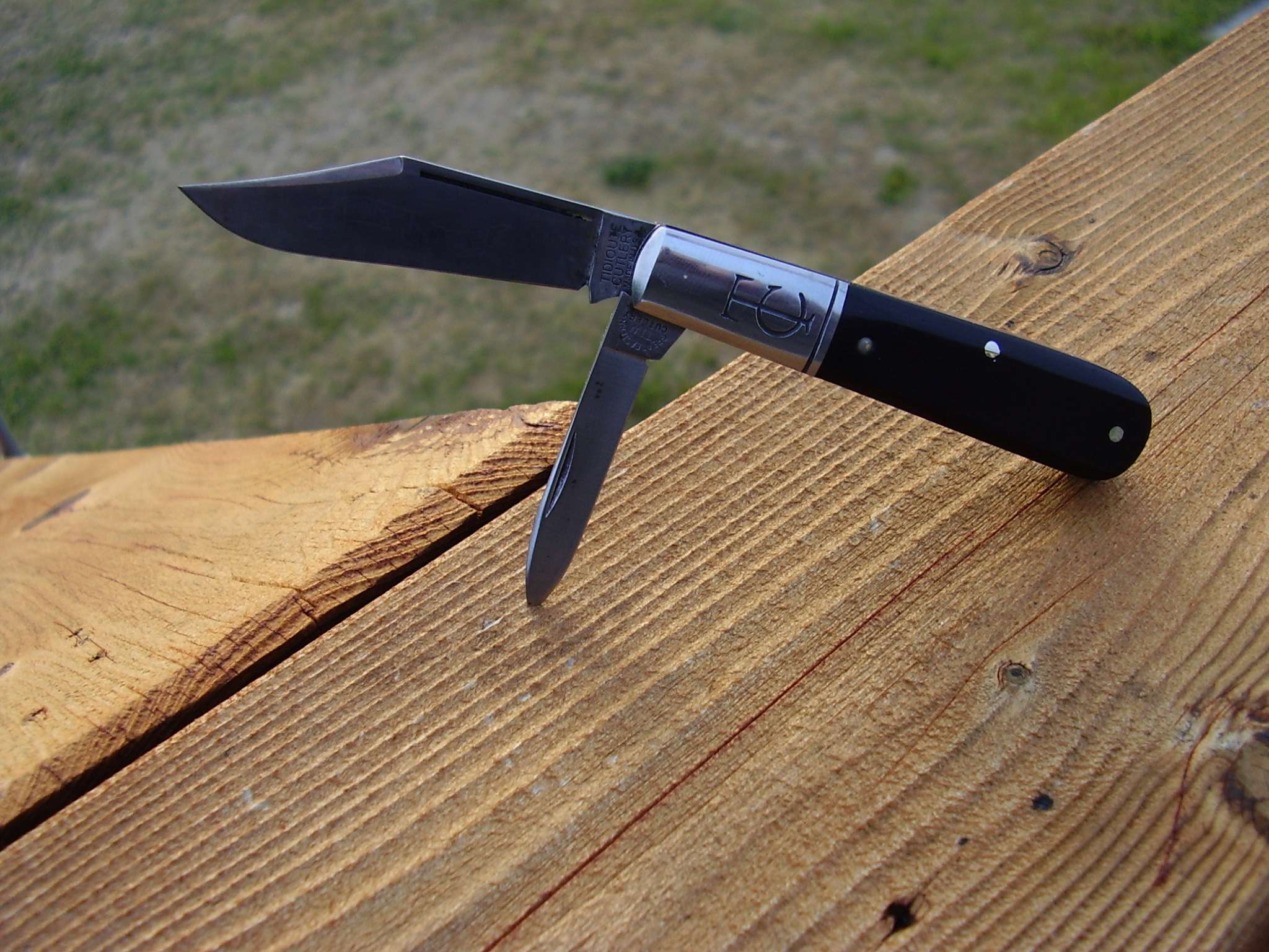

Both African Blackwood...
The following two photos are of the same knife in Macassar Ebony but in different light displaying the variances of character within the grain...
Gabon Ebony...
Both Gabon Ebony...
Gabon Ebony on the bottom left, Macassar Ebony in the middle...

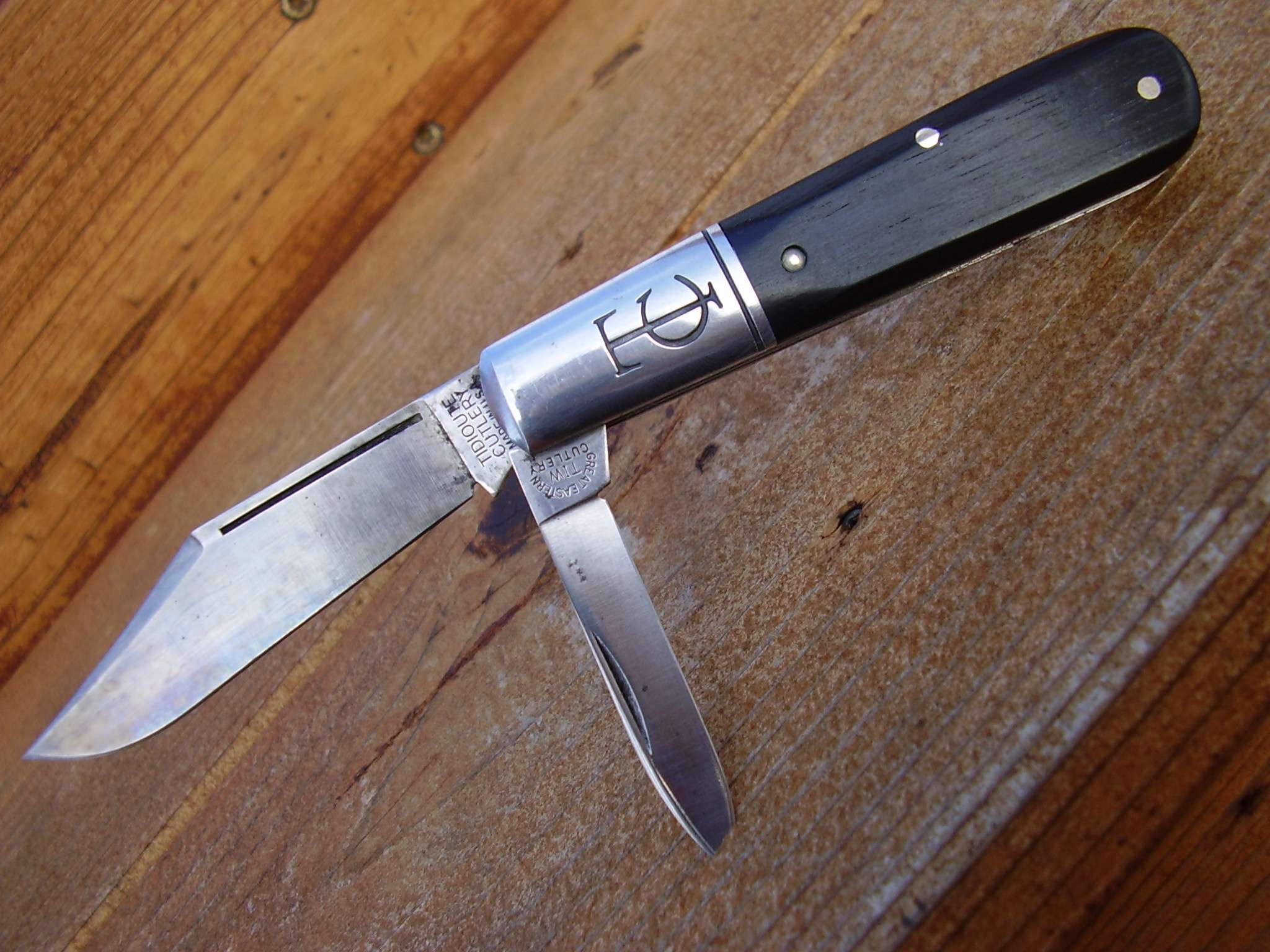

My favorite blackwood as of right now is the African. I really like how dense it feels. It feels slicker than the gabon and macassar. It can also have a lot of character in the grain depending on the sample you get. MY 85 has an almost burled wavey grain pattern on one side that gives it a rippling effect in certain light.

Thanks for the fantastic photos. I agree the Blackwood is the slickest. But, looking at your photo of the EO Bullet End Jack, I would have guessed it was Macassar Ebony. When I looked it up on GEC, I could not find it in Blackwood, only Ebony, and the Ebony Gec uses is Macassar (Except the Gabon sourced by Charlie for the 2nd run TC's). I suppose you have better info that the EO is indeed Blackwood, I just could not confirm it.
