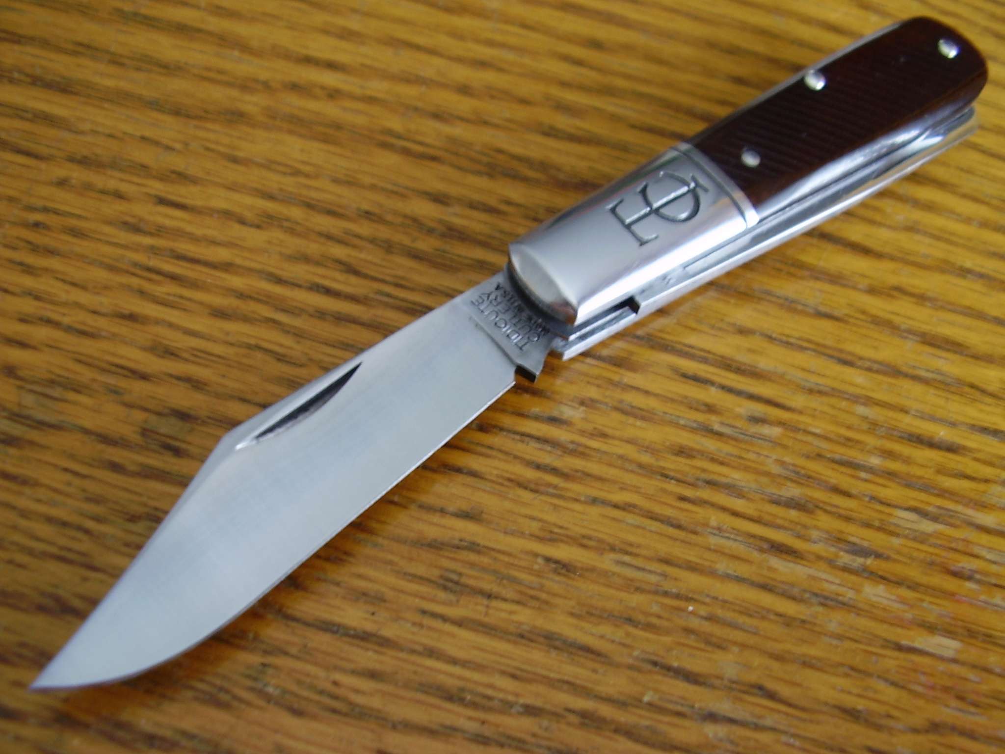

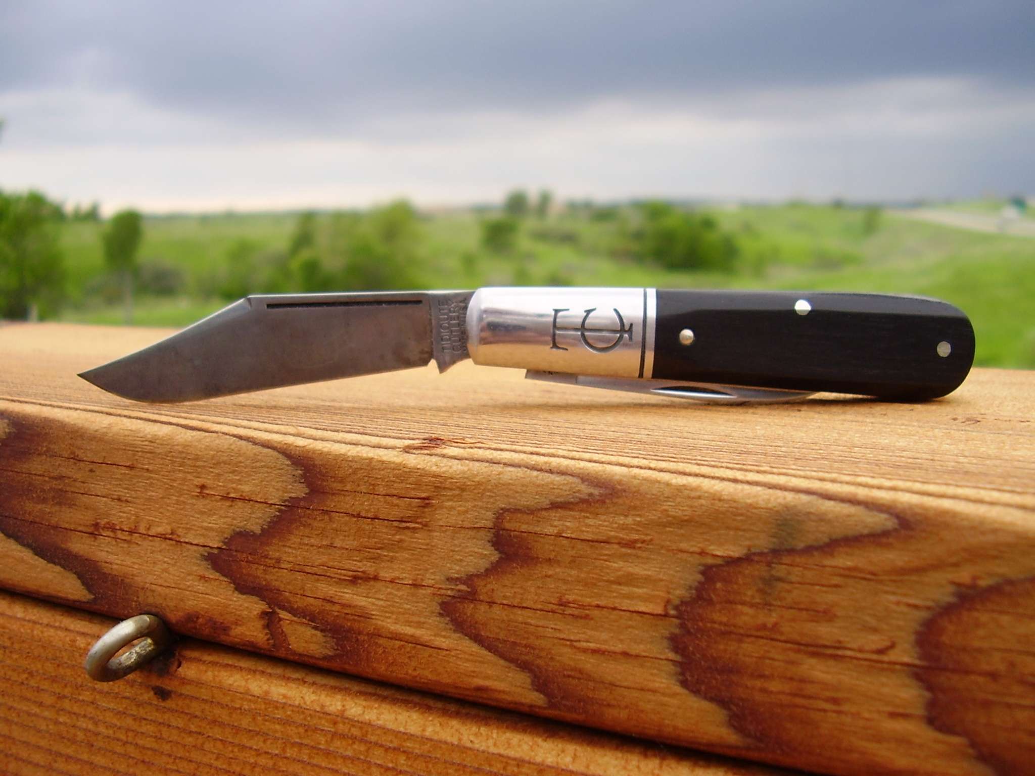

Correct! Sunshine cloth contains not only aluminum oxide, it also contains wax. So a blade with zero patina is more protected, if oiled or treated with wax, than a blade with unoiled patina. The exercise is about debunking the myth that patina protects, when in fact it is oil, or wax, that protects. More info on the importance of oil for blade protection in this thread http://www.bladeforums.com/forums/showthread.php/1148885-Patina-it-s-not-just-for-looks/page2 pay particular attention to Codger_64 comments on that page.
here is another photo of the Sunshine blade, better lighting as far as showing the lack of patina. I often remove all patina from my carry Charlow. It is very easy to build it back up, since I use it for food. The Sunshine cloth also works wonders on the handle covers. I learned about Sunshine thanks to Stich2442

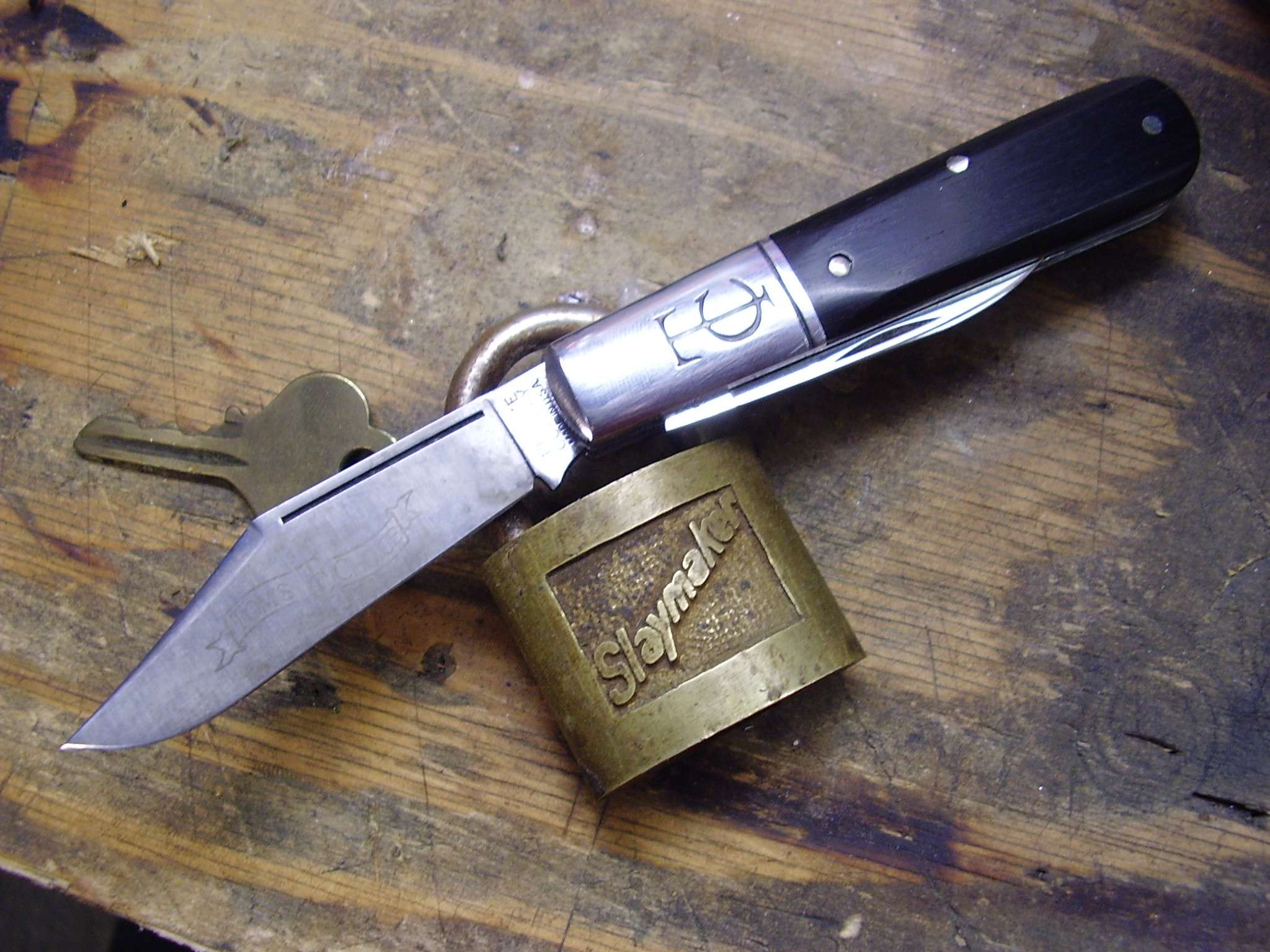

Your ebony spear Charlow is the most beautiful I've seen - always looks great!

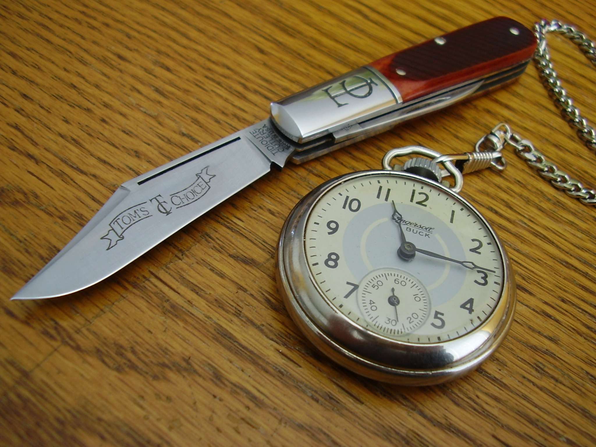

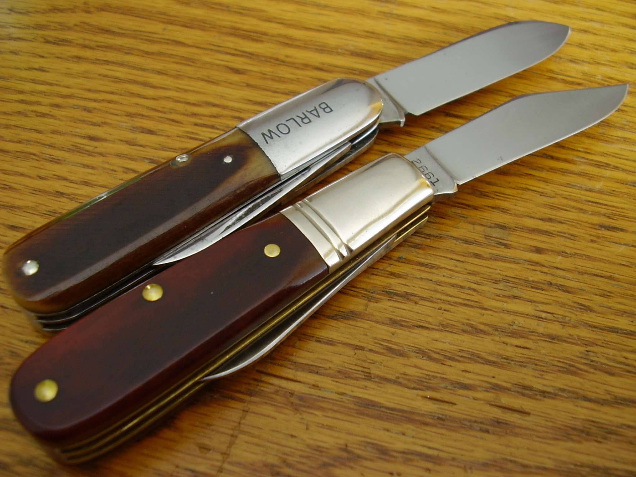

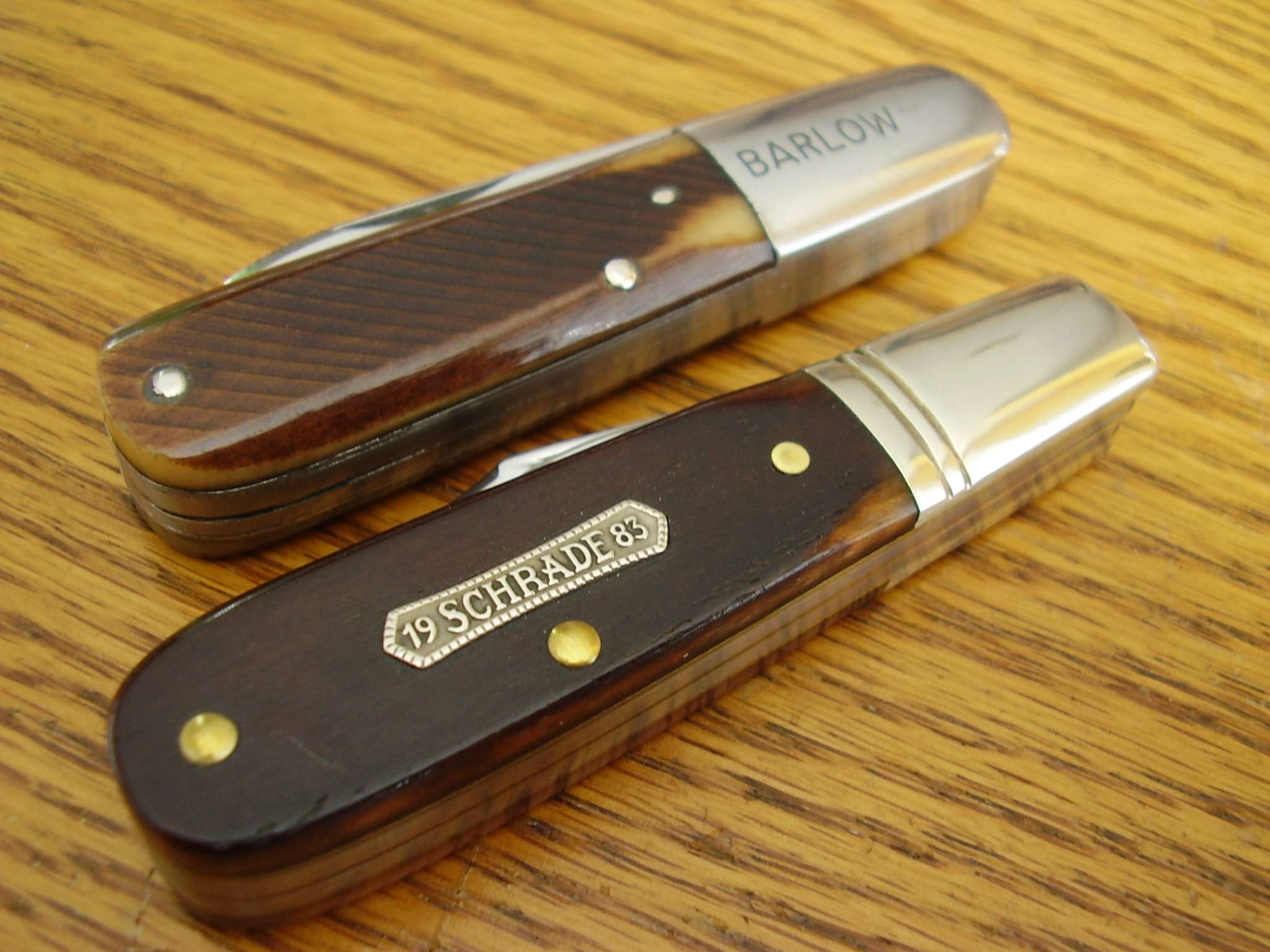

Great Barlow Gallery, Paul!

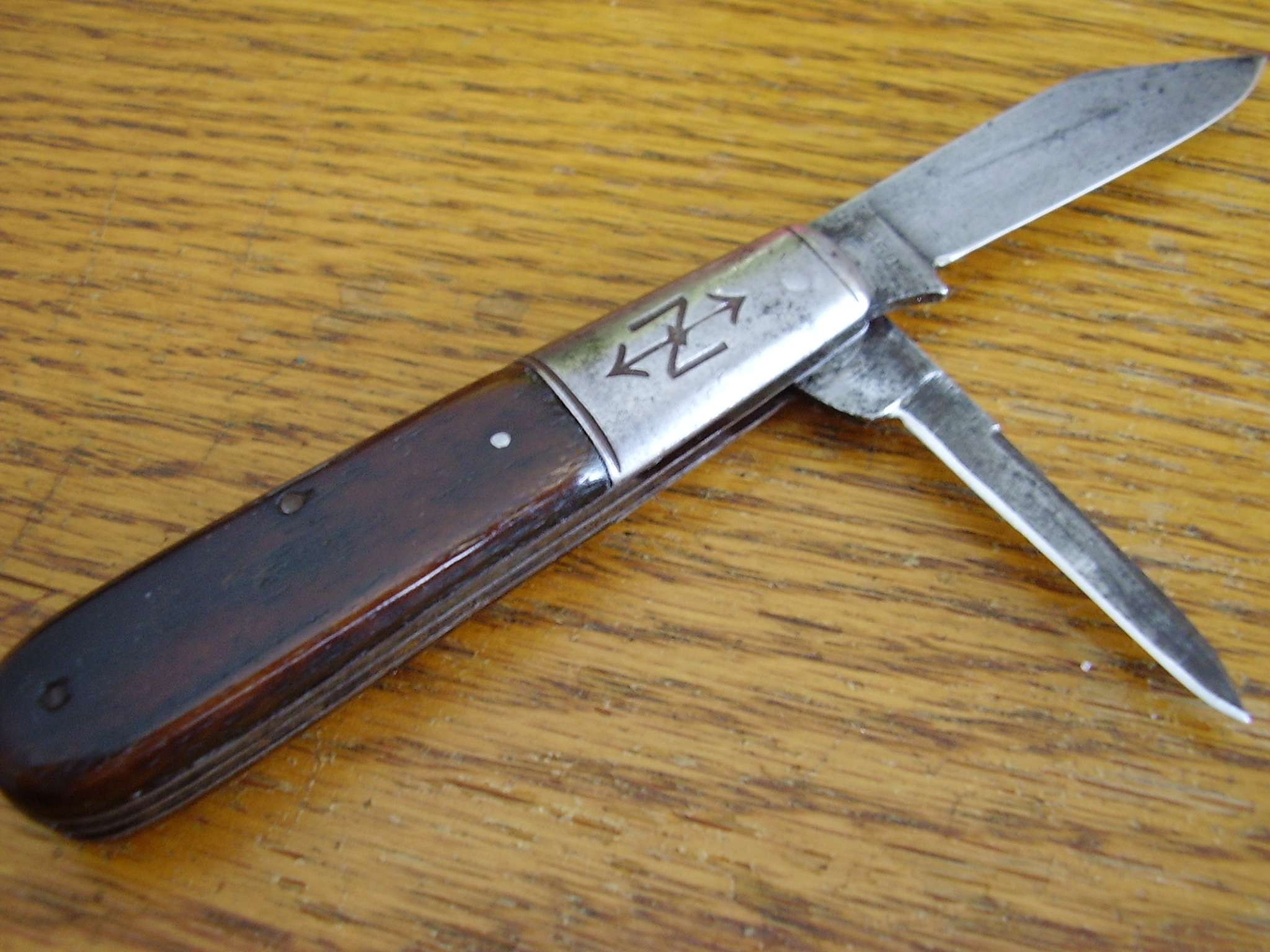

That NYK is the first I have seen with a clip blade! The two I have are both spears. You must have acquired that recently??
Wait a minute! I'm busy for a couple days and not on the Forum quite as much and what's this Radio Jack?? It must have slipped by me?? (off to the Search now to see!)
Nice Barlows you have Paul! Beautiful samples you have there!
I'm pretty sure it's a boys knife with spear main and cap lifter / flat head. :)
I agree Sarah, its a wee beaut, Paul - I love your photography, I search my new property for great places to take photos of knives, as I am scared people are getting a bit sick & tired on my knives on wood, but somehow you can place a knife on a desk - and make a great photo from it - and Sarah - when are you going out on another hike - or even your classic inside looking out window shots?
Paul....that Schrade ,83 Barlow is a beauty - lovely Bolsters & Bone &....... , I bought a older one last night - hopefully it gets here nice and safe - instead of me Queening that one, she will be right into my edc lot!
