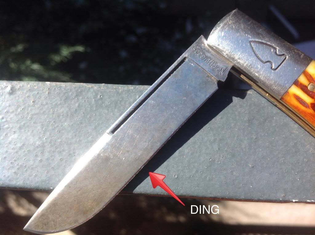

In response to the depth-of-blade seating question, it is indeed an interesting one! I have thought about it often. I know that blade-rapping is always a danger in the final setting of the blade resting depth. This is where the blade raps the spring, with consequent damage to the sharp edge!:eek:
When the blade snaps shut it often goes past the rest point, very slightly of course. Also, if you set the blade too deep, sometimes the spring will drop below flush at rest. And it is harder to raise the blade at rest once it goes past the optimum point. Finally, the peening that happens to the kick over time can also lower the blade.
Every knife will have a thousandth of an inch variance here and there. So with all these possibilities of the fitting going wrong, it has become evident to me that stopping at a functional point is far better than going too far, making it harder to fix. Of course, as the owner, I can take the risks, and file the kick as far as I want!:D
Makes sense. The recent run of the Northwoods Barlow is a good example of what can happen if the blade is slightly too low. As far as I've picked up, many knives off that run hit the back spring when snapped shut. I have one and the tell tale dimple in the center of the blade is evident. Doesn't really bother me, as there is a lot of blade to use on the knife and the ding is negligible but I can see how it could bug people. Two different arguments on this one, if a blade rides high eventually the tip will poke out the top and you have to file the kick, if the blade is low and hits the spring you've got a ding to deal with until you've ground enough steel off. I assume most people would want their new knife in perfect condition and deal with the aging process along the way rather than have to lose fresh steel to solve a problem. So yeah, makes sense, thanks Charlie.

One must be careful but I didn't need to cut much out of the backspring, maybe 15 or 20 thousands.
At first I tried to add to the kick, with a welder! :eek: Epic fail!! :grumpy: And I didn't see any other solution.

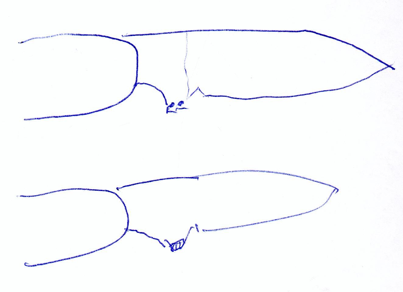

The safer way is to peen the kick! You can easily add several thou with a punch, or by direct peening.
My crapulent kick drawings! The dots represent strikes with an obtusely sharpened center punch (both sides).
Alternately, the "striped" area represents an area peened (both sides).
Of course you have to be firmly on an anvil for either.
