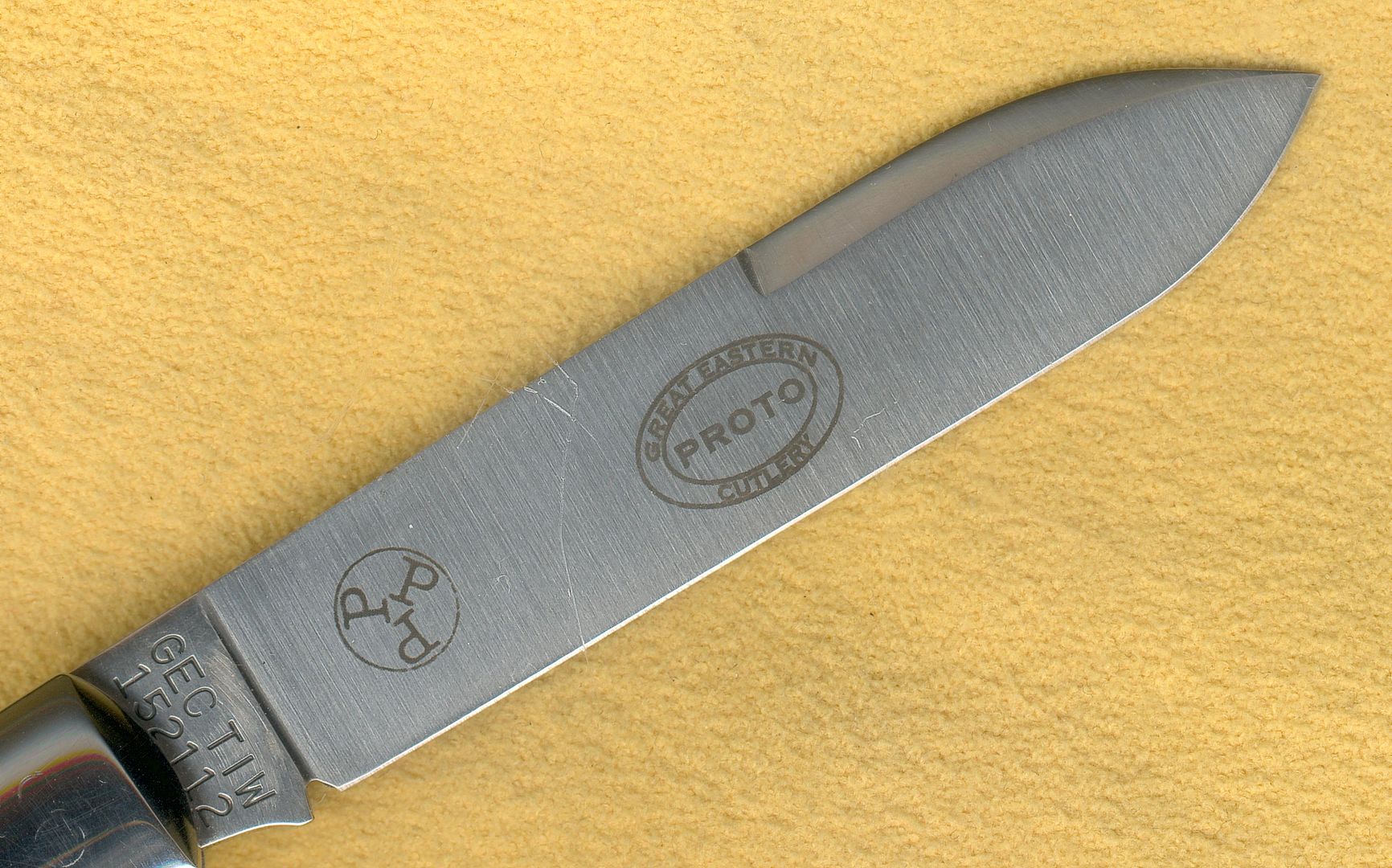

Researching Charlow tang stamps I came across some variations. This knife has the Titusville Iron Works stamp, TIW, on the pile side (fwiw, I believe only 21 Single blade Ebony Spears were made in the first spear run)

Jon, I can see a very faint hint of the PPP etch on that sawcut bone '12.
excellent! Thanks. That answers my first question
1. Were ALL batches of 1st run spears 152X12 tang stamp, marked PPP on the pile side of the blade? So far, Yes.

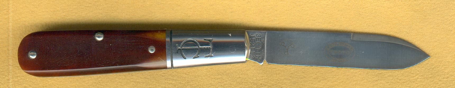

Here's another marking for you, Jon! I completely forgot about this one. I just found it while looking for TIWs and PPPs for you! The first one finished, Bill sent it to confirm details. On subsequent batches of Bone, the sawcut is slightly deeper. I think the first "copperheads" were the only ones (like this one) with the more shallow sawcut.
A real, no BS prototype!!

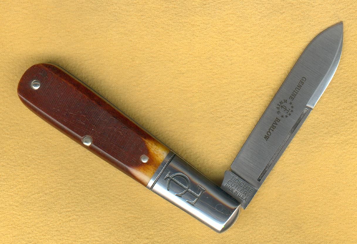

Good honest use makes for a traditional Barlow...
attachment.php
so in that vein, this one has been freed from its tube...
attachment.php
and is riding in my pocket, soon to hit the sharpening stone...
attachment.php
...then get some honest carry and use ;)
