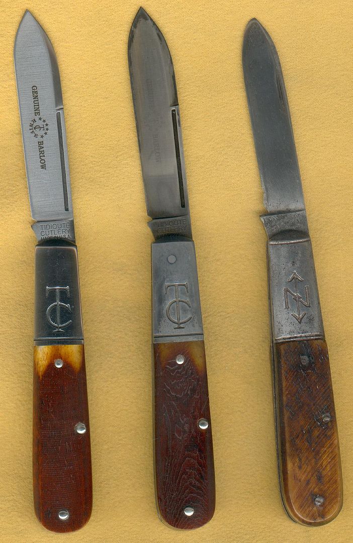

First check out the results:
Left, new out of the Tube. Middle, the Acid Trip. Right, the Real Thing!
The "new" bolster looks dark because that's how the scanner reads "real shiny".
I strongly recommend NOT doing what I did! I soaked the entire knife in vinegar (acid!).
I flushed it well in hot water, and saturated it with mineral oil when I was done, but I raised some grain on the bone, and Lord knows what I've done to the hidden surfaces of the steel, joints etc.
I have proven that the bolsters will patina, however!
The blade is irregularly coated. I just remembered I had to fine sand the blades first to get a real even patina. How easily old Geezers forget.:grumpy:
Interesting, I was thinking when I was observing your photo's of their Patina, that you would have to handle the knife very carefully - as in not to get finger oils etc on the Bolster and Blade to create unevenness.
When you mention sanding-I agree, sanding is what you term as "mechanical keying" and what you are doing is using Cider Vinegar as an Chemical Key, "key" being the etch.
Mechanical, combined with the Chemical Keying qualities of the Vinegar will provide maximum "keying".
You* DO have to handle it carefully. But also, when GEC applied the various etches, they changed the "keys".
There are different lines and "haloes" around those etches that don't show up in the scan. Anyway, a pretty crude job.
I will doctor the knife a little, maybe sand the bone slightly to get rid of the grain, and carry it for a while, and get some genuine patina on it!

Nice Charlie! I'm not usually a fan of forced patina but as an experiment and showing what mine will eventually evolve to, it's a wonderful exerciese. Thanks for doing this.
