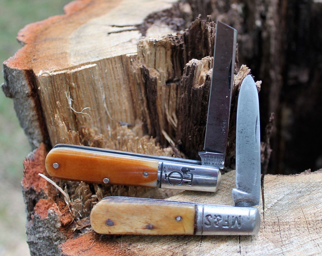

I was doing some yard work this weekend and....
...while digging a hole for a sapling, I discovered a large cave that runs underneath the property. After a Day's Work, I was able to clear the entrance. It was late and I was exhausted so I went to sleep and dreamed of what hidden treasures awaited me.
I awoke early to a New Day full of anticipation and excitement. I headed down into the cave and followed the twists and turns... sometimes needing to wriggle my way through. At the end of the tunnels, I found a mysterious tube with ancient writing on it.
I carefully opened the tube and found what must be the world's oldest barlow. The handle was made out of some old bone, probably dinosaur, and had an eleborate pattern scratched into the surface. There were spots of heavy oxidation on the metal surfaces. Based on what I've learned from reading BRL's forum, I know that "condition is only a sign of condition". So I know this knife is old. Most likely from the days of the cave man. Passed down from generation to generation and used during the Civil War.

I used 400 and then some 800 paper to knock the shine off of my bolsters and blade. I wanted some lines still so that's why I didn't go to a higher grit. Being "ancient" I figured it needed to look like it still had some texture to it. Plus as it patinas from use, it should allow it to form unevenly like the scaling is.
