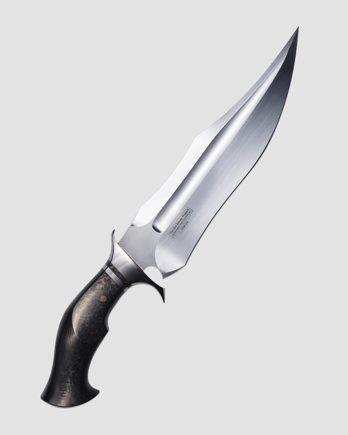

Modern version would be similar to this…
IMG_4011.jpeg…with a large guard. Modern materials. Clip point. Micarta or polished g10 for the scales.
Similarities of both knives:
SIZE- at least 9 inch blade, .187-.250 thick, distal taper.
USE- apple peeler
STEEL- modern tool steel, your choice
CONSTRUCTION- full tang
