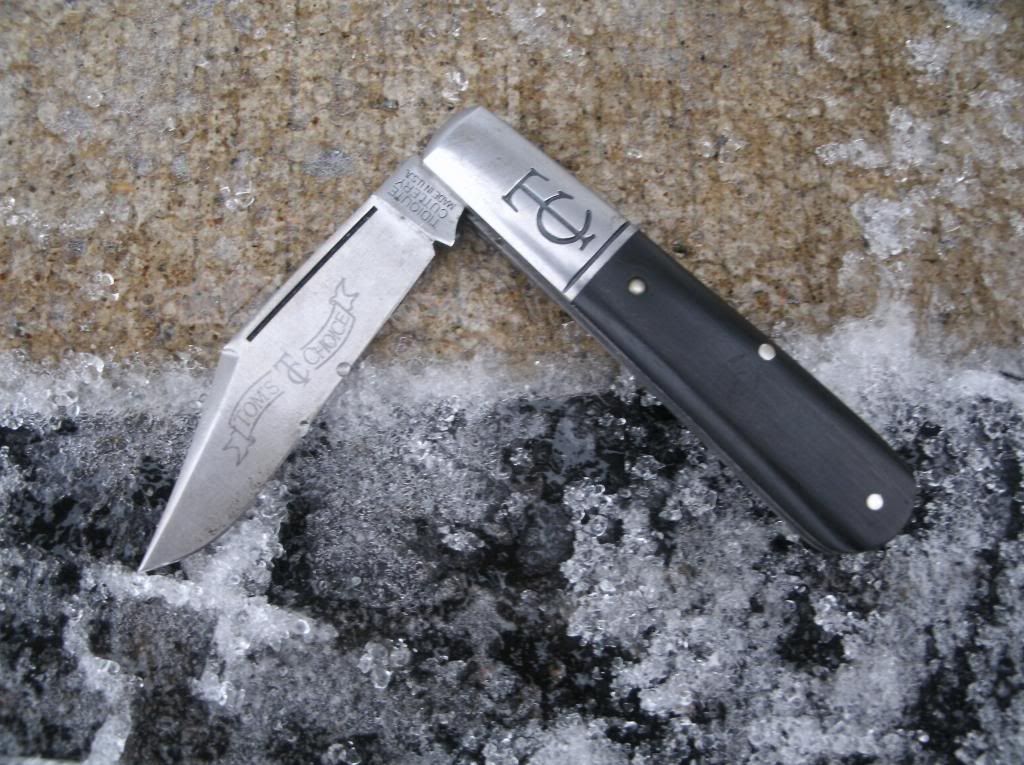

Nice :thumbup:
Thank you sir, awesome little knife by Lon Humphrey..
