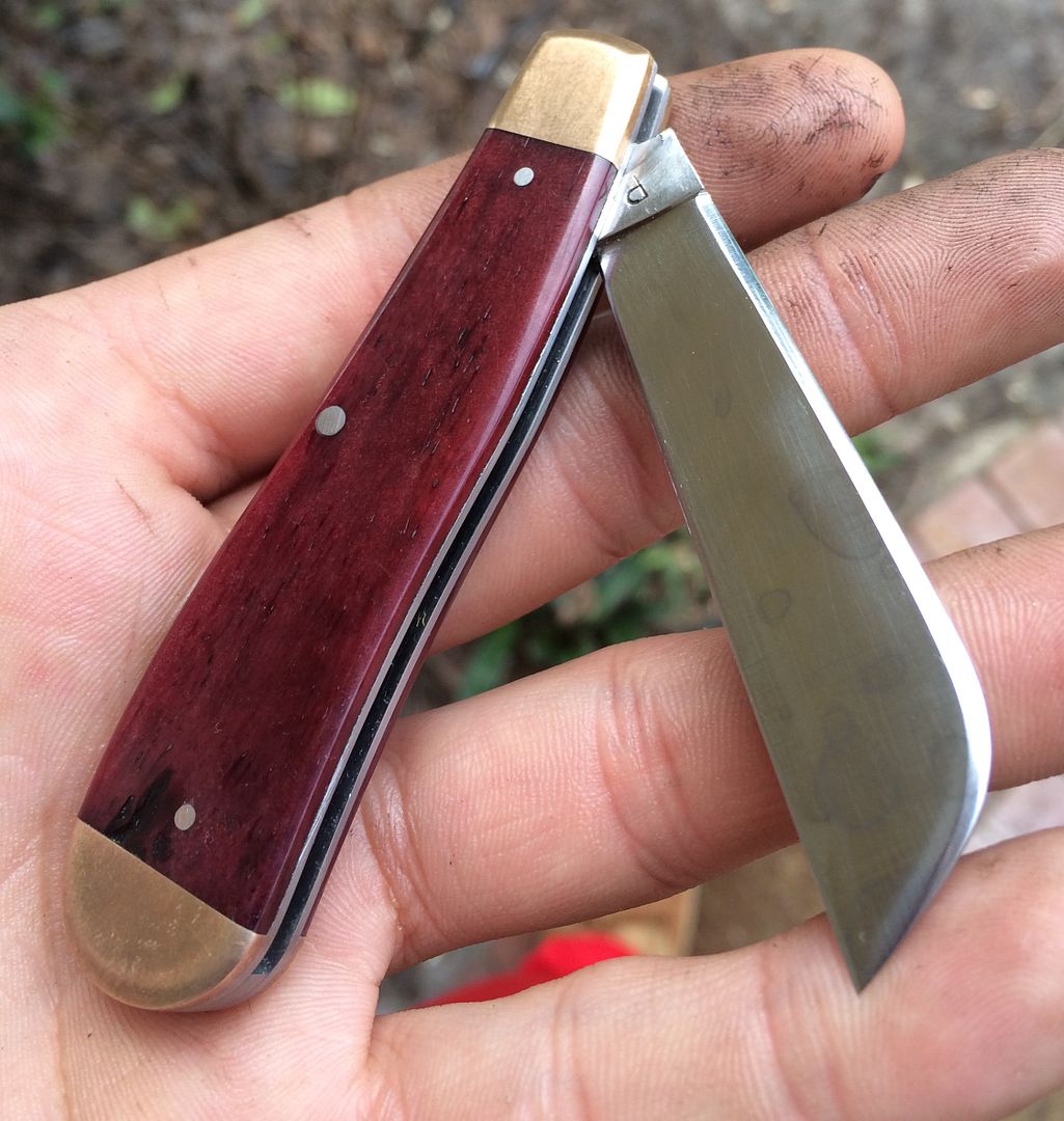

I am still on my TL-29 modding horse. I have a small pile of them at this point, and it is really teaching me a lot of knife building skills.
Here is my latest mod. I took out the screwdriver blade, and ground the blade tang so the liner lock would work with the spear blade. I got a hold of some snakewood and made some new scales for the knife. Once it was all together, I decided to partially serrate the blade. It has turned into a super nice knife. The snakewood polishes up like glass and is super hard, but cracks easily. There are some cracks at the pins, which I have hidden, but it taught me to be more careful with super hard woods.
Very nicely done!! You keep getting better and better! Careful now, you just might get addicted!

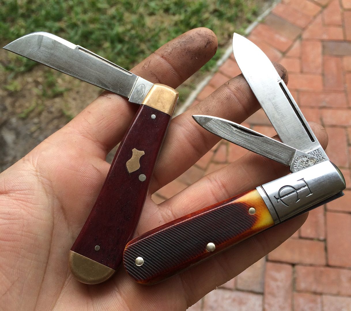

These two are accompanying me today. Man, do I love how bronze patinas.
Two real beauties Evan !!! Number one is outstanding now! :eek::thumbup:;):D
Nice Radio knife JRTodd46. :thumbup::)
