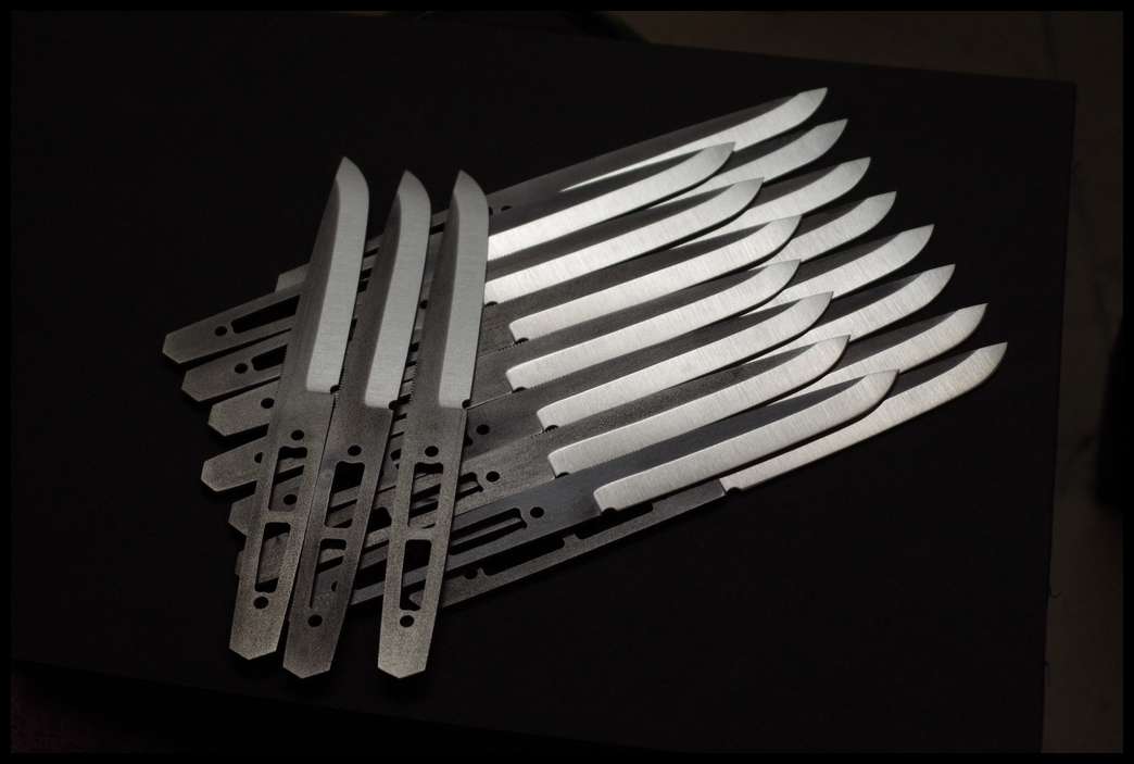

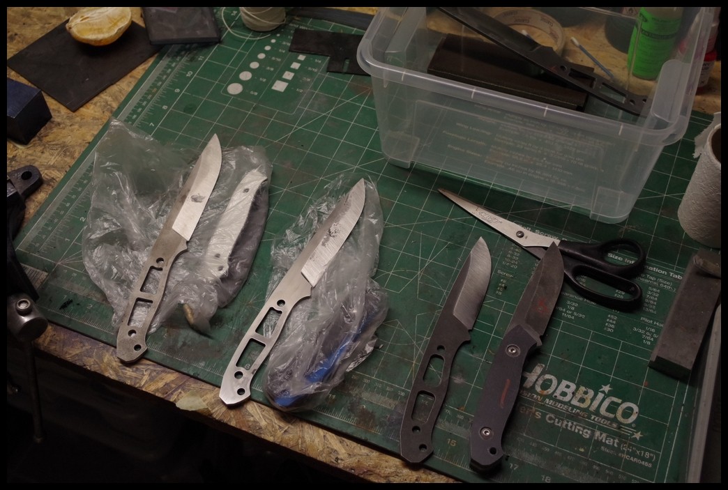

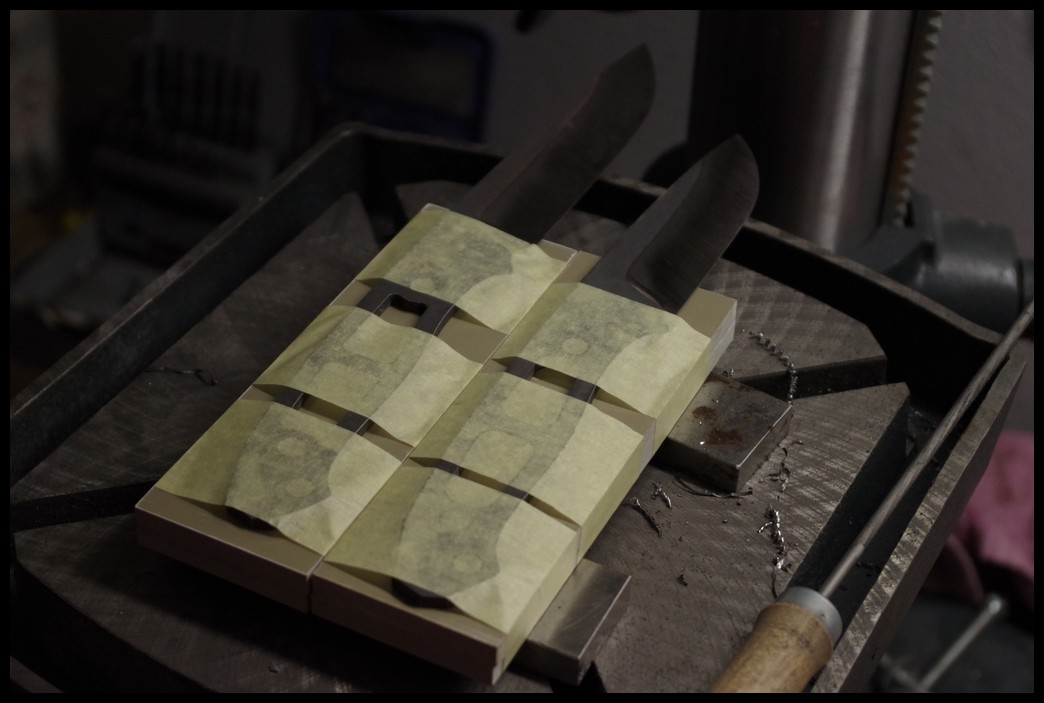

18x Garmr Elmax 2,5mm mentioned above, primary hardness and cryo, should be around 60HRC.
Now time to mark them (and clean marks) and get ready to epoxy scales to them :)
Red, Olive, Goblin Green, Black :)
And one black/green ( I ordered 2 scales, and they are to small for Sphinx ;( )

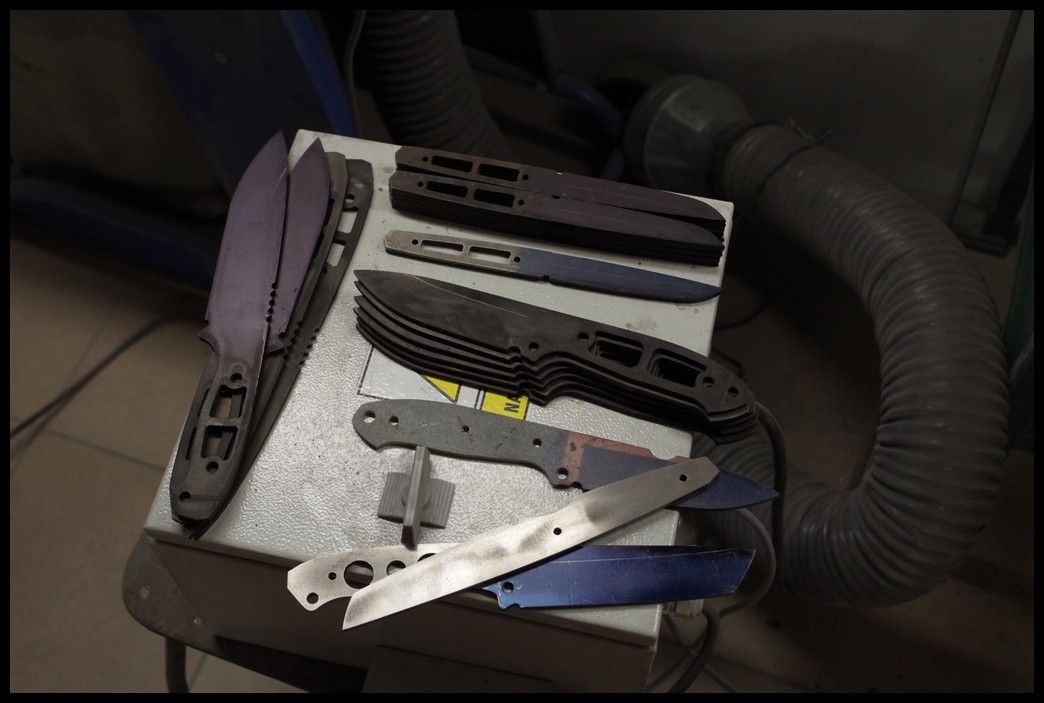

Also today time to grind 19x Tengu-C knives. But 5 I think to make with Nightmare grind ( 3cm on front flat, rest hollow 270mm radius)
And 4 Hephaestus + 6 manticore knives from Elmax 3,78mm.
Next week I will receive 300x1000mm 3,78mm VANADIS 4 EXTRA, and again 2,5mm 300x1000mm ELMAX :D ( This will be a lot of Tengu, Garmr and GREMLIN!)

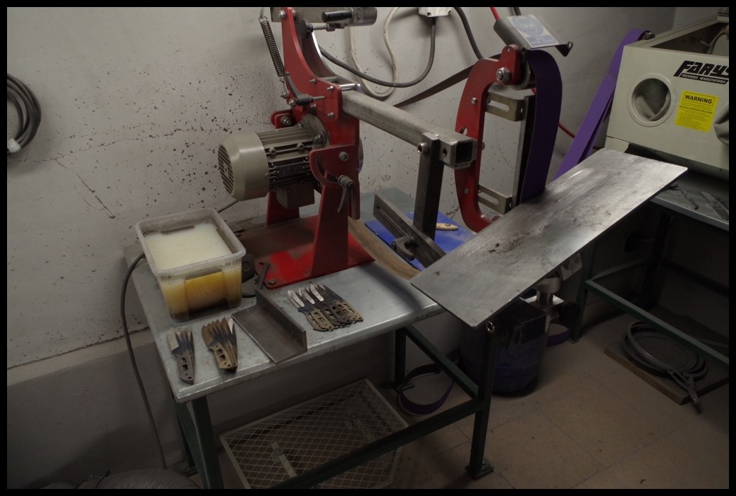

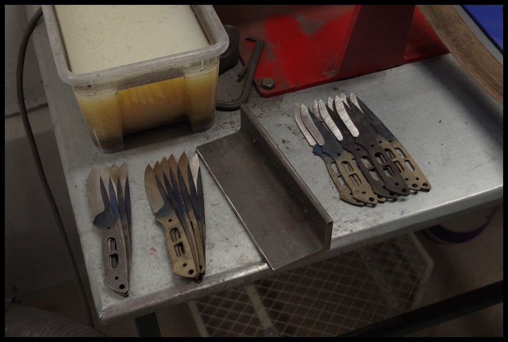

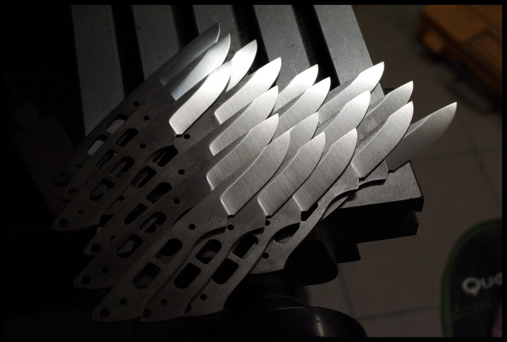

Next bath of Tengu-C knives...
How I will sharp so much amount of knives !?
( Time to think about belt sharpener...)
