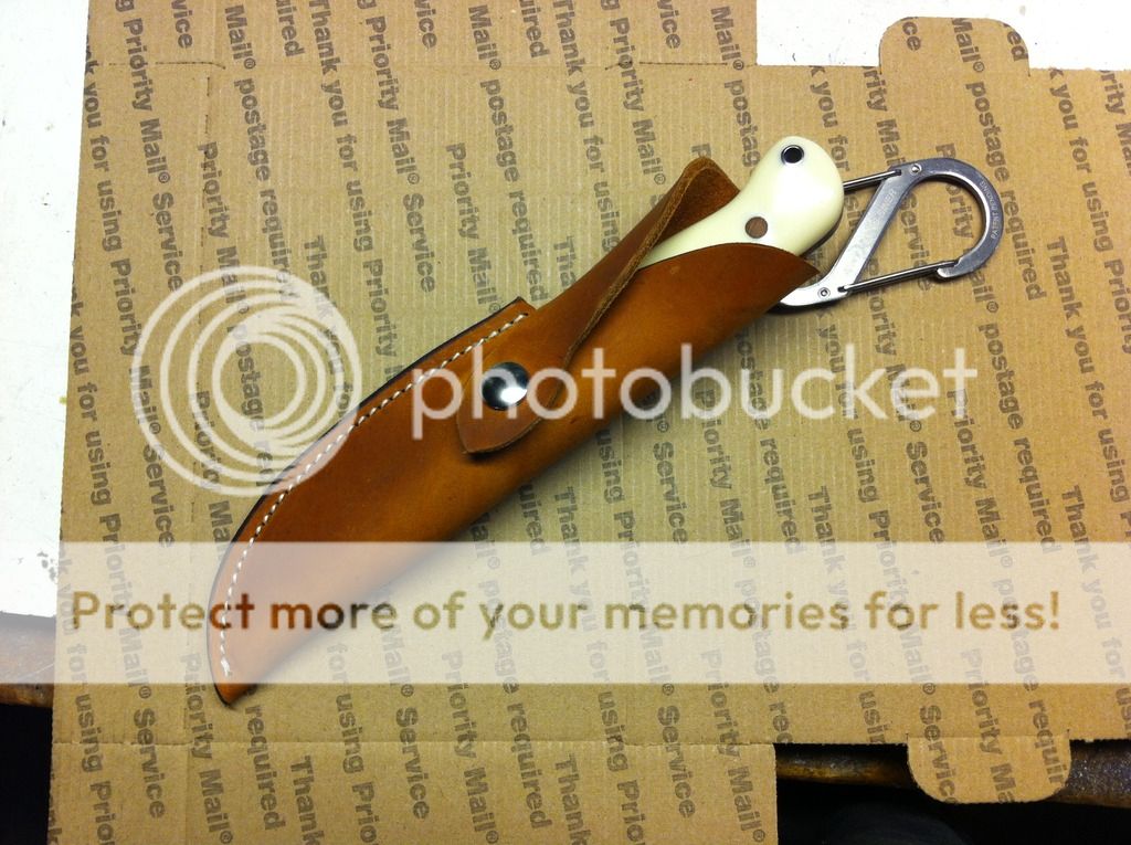

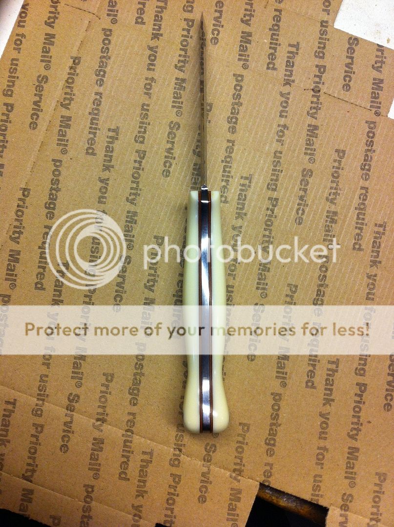

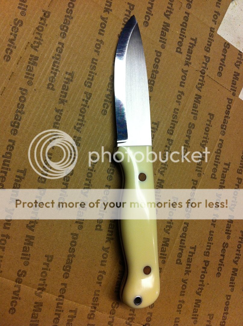

Just finished this bushcrafter model
8.5in overall length
4in blade
1084 High Carbon Steel
Heat treated to 59-60
Scandi grind 11.5 degrees per side
Artificial Ivory handle
Micarta liners and pins
Stainless steel lanyard tube
Leather sheath with S clip dangler
