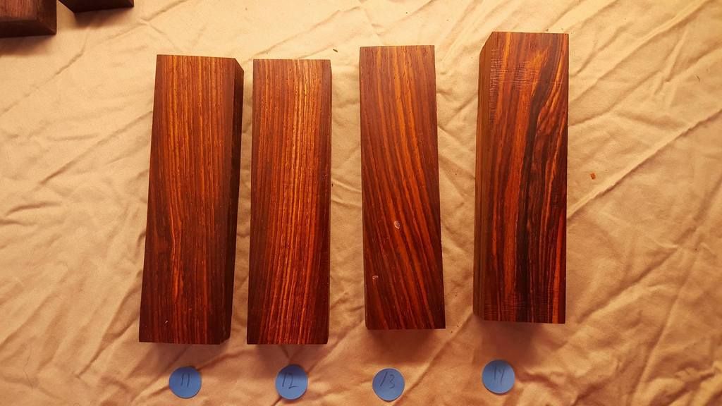

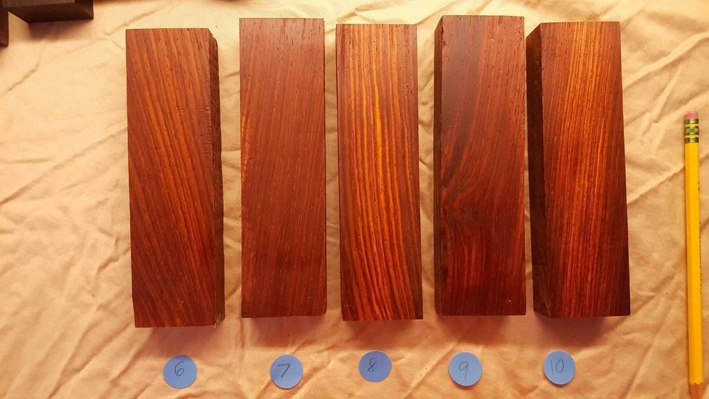

Woods have been posted! Im a dealer! Redwood burl and black palm to come tomorrow!
Can you say Cocobolo?

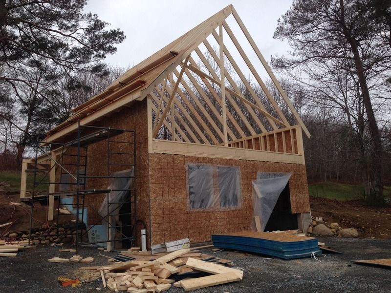

Maybe Rick, but its still moving, thats what counts. You need to be done by the summer so we can all come over.

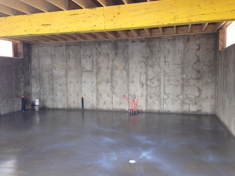

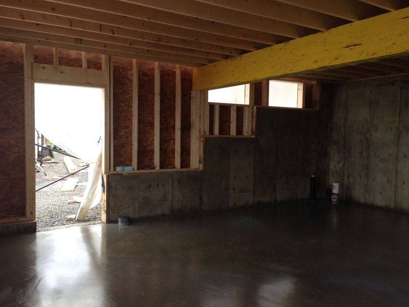

Nice looking shop. Looks like it's plumbed for a bathroom. I put one in my garage and it was one of the best decisions I made when I built my house.
Yes it is. A wheelchair accessible bathroom is commercial code around here. I will be teaching as well as having an employee or two. You may have also noticed the in floor heating lines. The pad and walls are completely insulated from the ground with 4" of SM foam.
