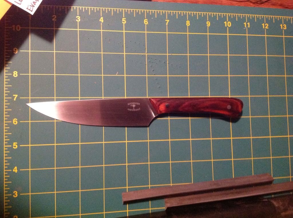

My first try at a design using small wheels and Micarta. There are some finishing work left to do.
It's made of O1 hardened to 61 HRC with SS pins and black/red Micarta. The blade is taken up to A45 and then Scotch Brite.

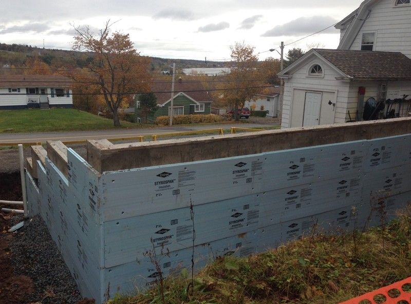

Pardon my ignorance (I know very little about this stuff but am very interested), but are the walls poured? And does the pad just sit on the foam? It doesn't squish it?
Sorry bud... I missed this one. The foundation is completely poured. The back wall is 9ft+, sitting on a 2ft wide concrete footing that is 1ft thick. The side walls are stepped down to follow the contour of the hill. The foam you see is applied to the entire wall before it is back-filled. The inside floor starts with a few feet of packed gravel, then 3-4 inches of foam, plastic vapor barrier, then 5 inches of concrete. There is a web of rebar in the slab to keep it from cracking. The foam is rigid enough to easily support the slab because the weight is spread across the entire surface.(they build entire houses on floating slabs... my walls are separate from the slab) What you end up with is a floor slab that is essentially floating and walls insulated from the ground. I added in floor heating lines that were embedded into the floor when it was poured. I'll run hot water through then to heat the pad. That way I can avoid have a heat source which requires nothing that'll blow dust around the shop or compete with my dust elimination system.

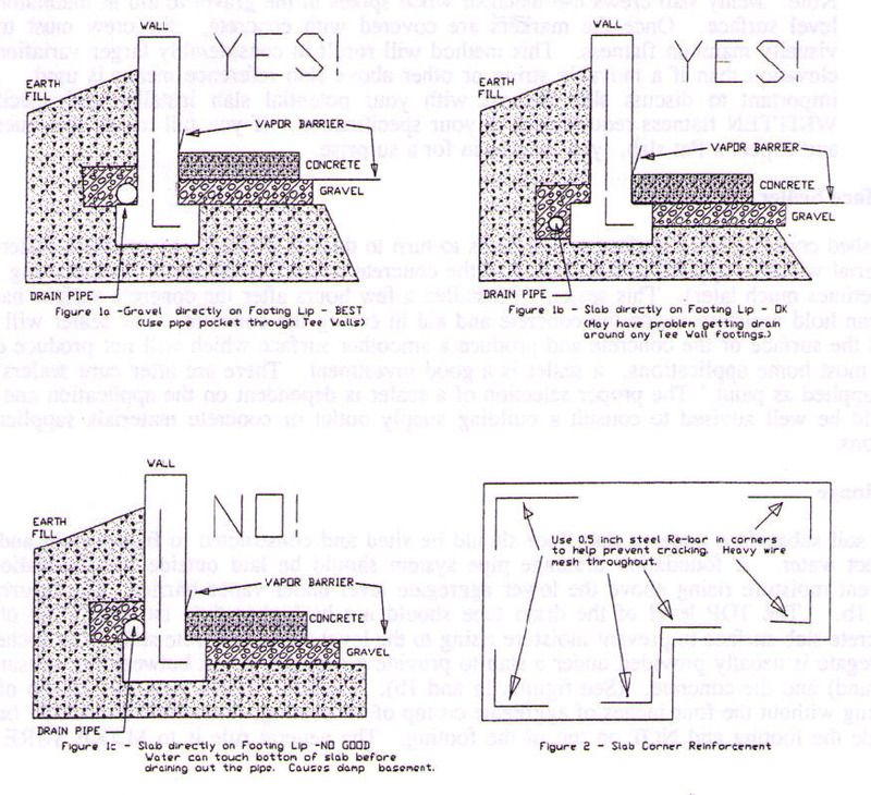

Mine is the top right configuration... but with foam under and around the edges of the slab to isolate it for heating.

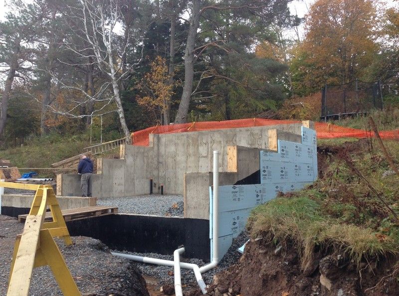

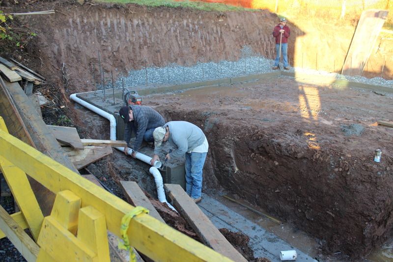

Here, the footings are dry and we're putting in the drainage tiles for the outside perimeter of the building.

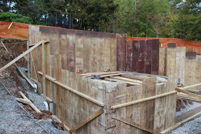

The forms for the foundation are being made. They will pour the concrete walls after this.
The forms were removed after the wall set. Then we painted a membrane on and installed the foam insulation.
After that, they trucked in a certain type of soil that would allow for drainage without being mucky. There was a high sand, low clay content to it.
Does that help get your head wrapped around it?
