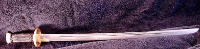

Ya know, I have never actually made, or even used a khukuri- so I was a bit nervous about making one, but it's a fantastic opportunity for me to make something I've always wanted to try.... so I'll give it hell and see how it goes. :)

I'm gonna go out on a limb here, and say both your customers saw my good friend Jason Knight's gorgeous damascus Khukri at Blade, and/or his recent run of it's carbon steel brothers. The next level of Khukri madness has hit, and it's an epidemic.

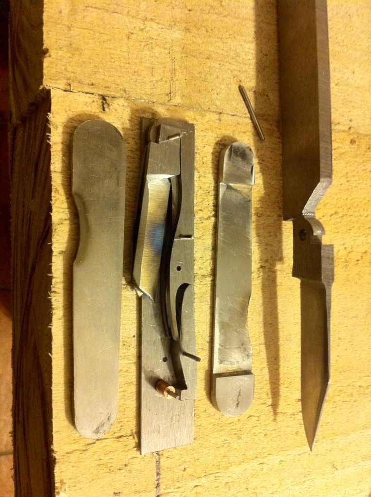

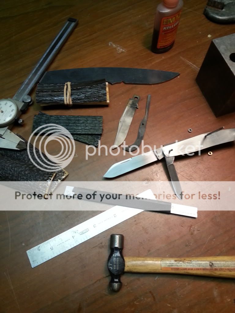

Been working on a 4* Diamond Edge jack. Just got thr blades ground and now have a couple more to get done for gifts. I'll try to keep posting progress on these if anyone's interested
