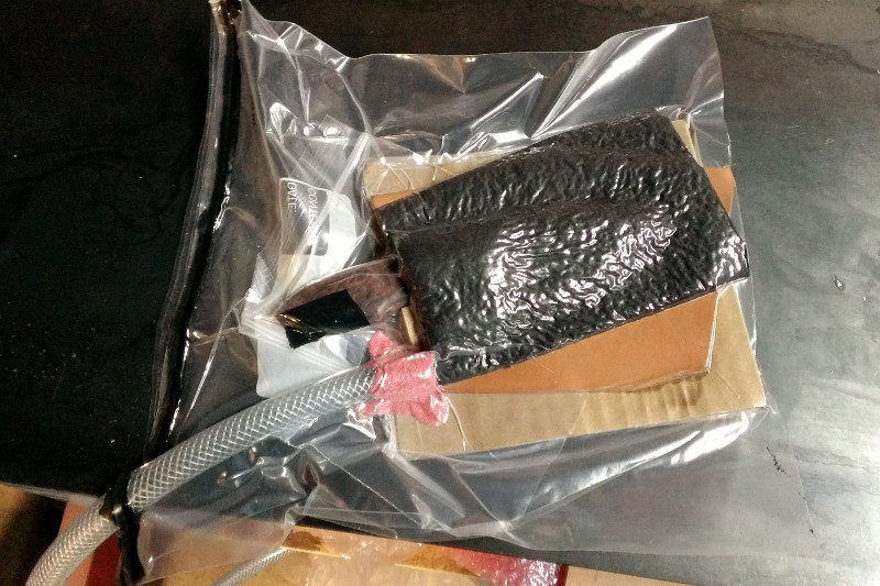

Playing with the vacuum pump again. :)
This time I put in a wood spacer at the handle and under the blade, to see if I could get a final form right out of the bag instead of having to go back and reform after vacuum molding to make sure the edge doesn't rub on the way in and out.
I finally got the correct stuff to seal the bag as well, now I don't have to create a tape monster every time I make a sheath.

Hall that is the same thing we do with making holsters. I take a wood dowl long enough to go between the sites and tape that to the gun. When vacuum sealing the holster it creates a channel for the sites to not catch on. Ofcourse this is only one method. Works really well though. Should work for your knives once you get the thickness required.

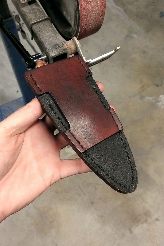

It ended up working pretty well. I also cut out a thin slice of wood as a spacer under the blade, so the knife doesn't tilt as much under vacuum, and it gives the mold a bit of extra definition in the blade area.

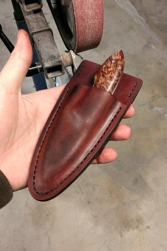

This sheath was a horizontal/vertical carry for one of the three XHP EDCs I just sold on the exchange. I was going for a bit more even brown, but I dampened the leather too much before dying it, so I ended up with a bit more antiqued look. Oh well.
(lol not the greatest job ever lining the stuff up in the bag, got the important alignment correct at least)

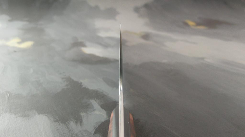

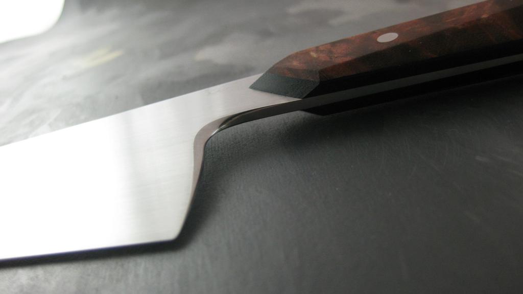

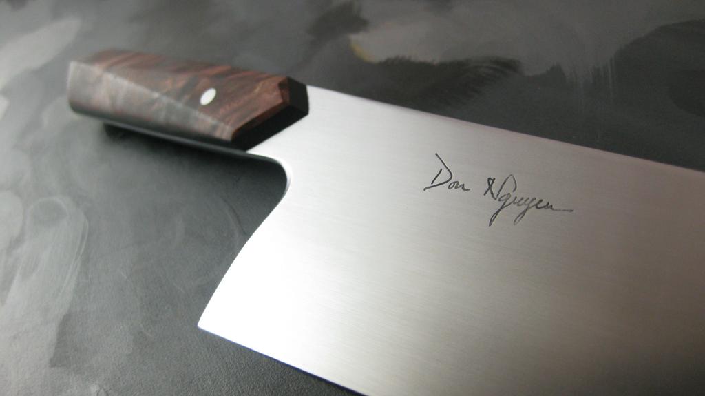

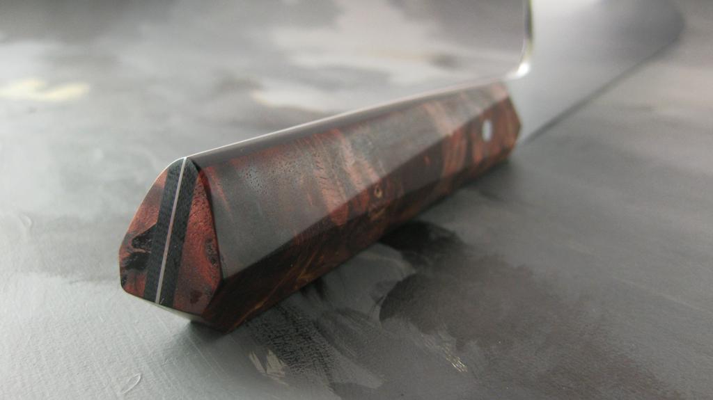

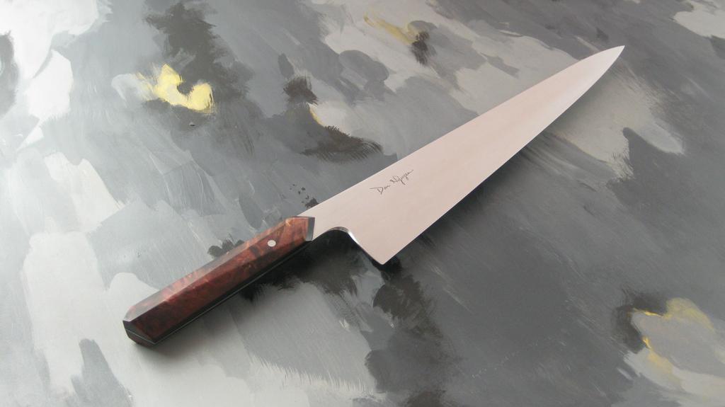

Holy cow Don. I know I commented on your handles already but *man* those are nuts. I think someone said they are stealth fighter like and I have to agree.
Not sure I've ever seen a taper like that either.
Outstanding. I'd love to slice up some fish just for the experience.

One thing I think I mentioned before, once you have it vacuume sealed, I use a piece of cocobolo that I normally form the leather with and run it around the edges and what not. Can do it after you take it out but I usually like to do it while in the bag. I just go around the edges where I want more definition. Doesnt take but a minute or two literally. Then I take it out of the vacuum after about a couple of hours (not sure yet of the best time required to be in there) and I take the wood forming tool to it one more time really quick. This gives it the look of a nicely formed piece but only takes a few minutes tops.
For even color I have not found anything that works better then an airbrush (sure you already know that, I cant remember), it doesnt penetrate as much but the color is great. Not to mention you can get alot of cool effects with the airbrush as far as shading and having darker borders and what not.
I have scene some guys that will use the dauber or brush method to get full penetration of the dye then after its dry come back over with the airbrush to get the nice even texture/look but I have not really tried this yet. Usually dont need to.

Forgot to add, sometimes if you oil the piece then let it sit overnight, then dye it you can get a more even dye coloring when using the brush or dauber method. I have had good results with this as well but usually want to get it dyed right away or am just impatient (whatever you wanna call it).
One more thing, Ive also mixed the pro oil dyes with turpentine which not sure if its the best for the leather and it does smell for a while. It seems to apply more evenly. If you try that test it on some scrap first. Usually you wanna keep fossil fuels away from leather however turpentine has been used for various leather working chores for a long time. I just dont like the smell all that much.
