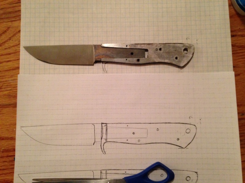

I'm working on a frame handled hunter. CM154 blade, blued mild steel guard and fileworked frame. Stainless liners for contrast. Sambar. Gonna be sweet :) I'm taking pictures as I go for a WIP, but I'm not going to stop and process most of the pics until I'm done with the whole sequence, so y'all have to wait. Sorry :) Here's a teaser pic. Blade is ground and ready for hand sanding. Frame is roughed in fairly close with holes drilled for guide pins. Some pins are 1/16 mostly for alignment, while a few others are 1/8, mostly for hidden pin strength in the stag. I left the tips of the frame a little long until final fitup. There will be a guard in there like the drawing.
One legitimate tip that you can see from this pic. If you are into drawing good scale plans, or even if you're not, make a few copies on a copy machine. That way you can cut out parts and superglue them to your flat stock as a template.
What I have also figured out tonight is that variable speed with fine grit belts is frickin awesome. Take a 220 then 400 AO belt down to a crawl and you can get a ricasso that looks hand sanded but stays square.
