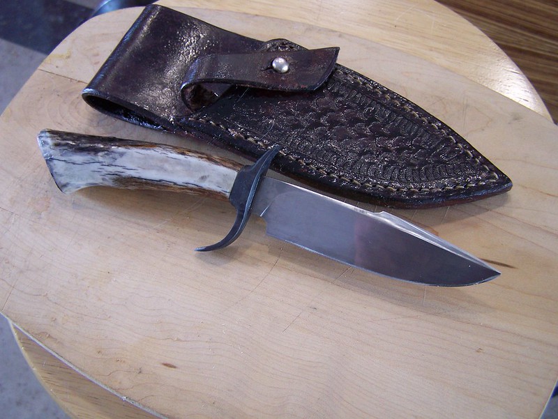

Here's the little fighter I had glued up when I posted the picture of my profiled blades.

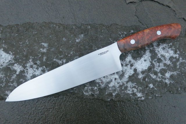

As an update to my previous post... I finally finished the Western Gyuto I had been working on on and off for 2 months. Was waiting on some major upgrades to my shop and really taking my time with it. It's largest knife yet, and I think it marks #10 for me if I'm counting properly.
Kind of a miserable day, but the rain managed to stop long enough for me to take some pictures.

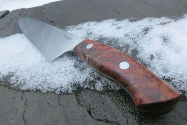

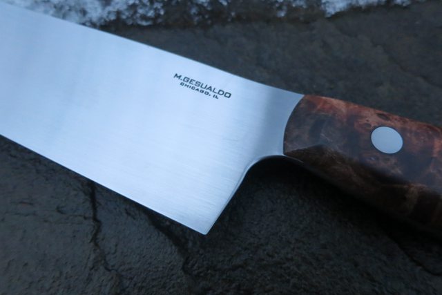

There were a lot of "firsts" for me on this one, which is part of why I dragged it out over the course of 2 months. My first two attempts at chef knives were pretty huge failures, so I took a step back and really studied what made a good one. So far in the small amount of testing I've done, it cuts beautifully.
Blade is about 9" long (I made a typo in my original post), OAL is around 14"... so it's my largest yet. Ground the distal taper, full flat, then lightly convexed to try and help with food release, 0.005" at the edge before sharpening. Hand rubbed 800 on the blade, 2000 on the spine and heel.
Steel is 52100 at 61rc. This was actually the first knife victim of both my new kiln and new hardness tester. Came out spot on where I wanted it, which was pretty exciting/relieving. Really didn't want to have to send it out for HT right after purchasing those, haha.

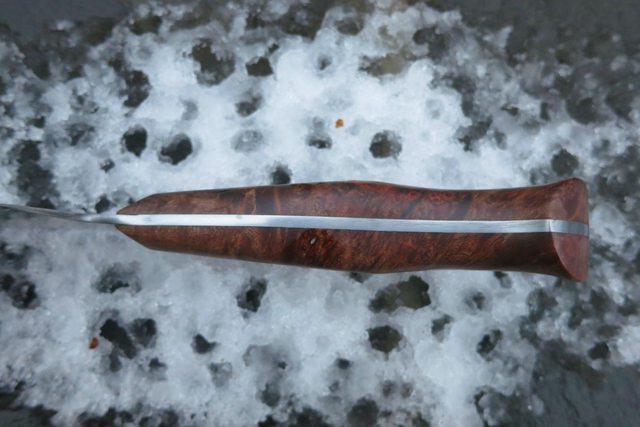

Handle is Maple from Mark at Burl Source. Was one of the blocks from this burl. REALLY pretty stuff... I kinda wish I bought more of it. I sanded it up to around 2000 grit, then gave it a few coats of Tung oil. Still experimenting with finishes on it that don't require a buffer, as I don't have one of those. Wouldn't mind a little more shine to it.
This one is going to travel down to Florida with me for the holidays where it'll be a gift from my Cousin to his girlfriend. Should be making its debut at Christmas dinner :)
