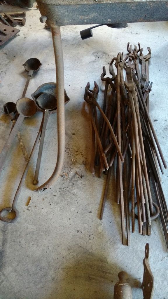

I have been a little slow in the getting anything accomplished department for the last month or so but I made a huge tool purchase.
Thanks for looking
Mike

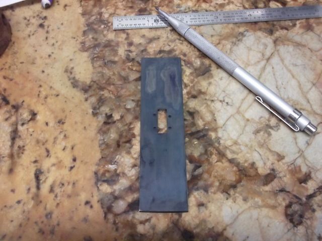

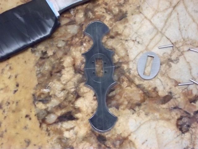

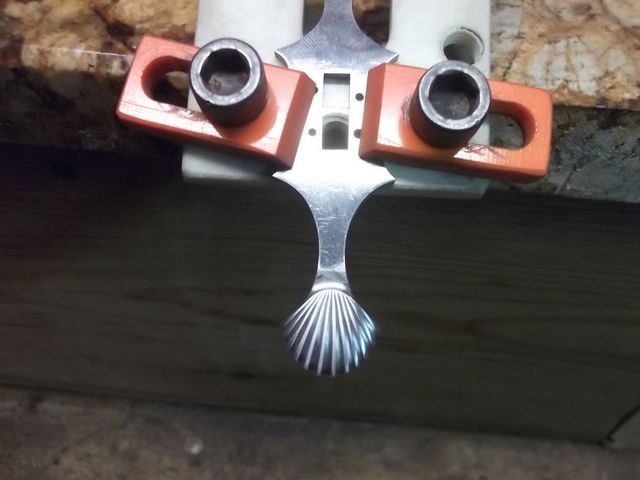

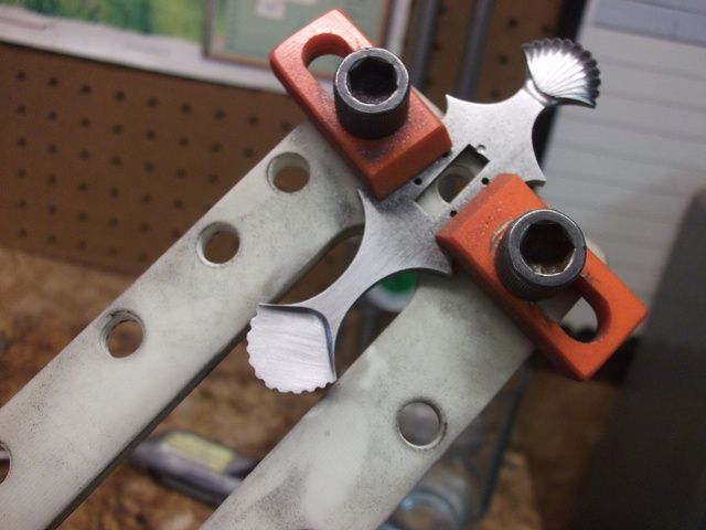

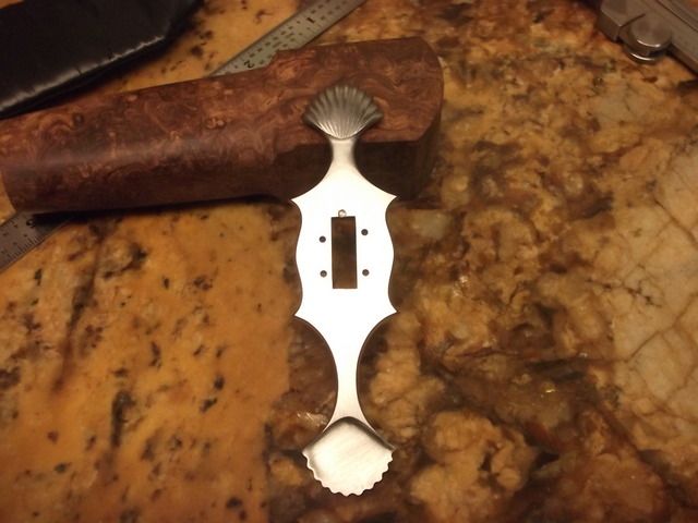

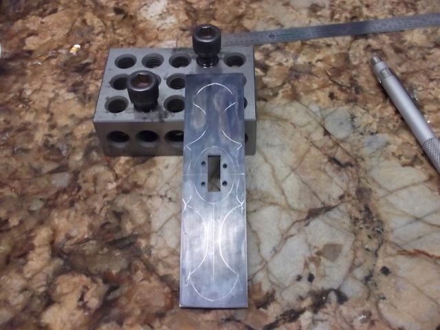

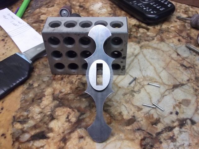

Here's a few shots along the way of making a double shell guard for a bowie I'm finishing.
Looks great John. I have a question. How did you thin out your stock behind the clam shells? Did you use a mill or do it by hand? Also what are your orange hold downs made out of? Thanks
-Clint
-Clint
HI Clint. The shells are dished out by hand. They're concave...just like a real shell. I start with a carbide cone shaped burr and rought it out, then it's just a WHOLE LOT of hand work to smooth it all out. I utilize files I've ground and bent to suit me, sanding sticks, cratex points......whatever I need to fit the shape I'm going for.
The orange clamps are made from g-10.
Excellent work, detail work like that takes a lot of skill!

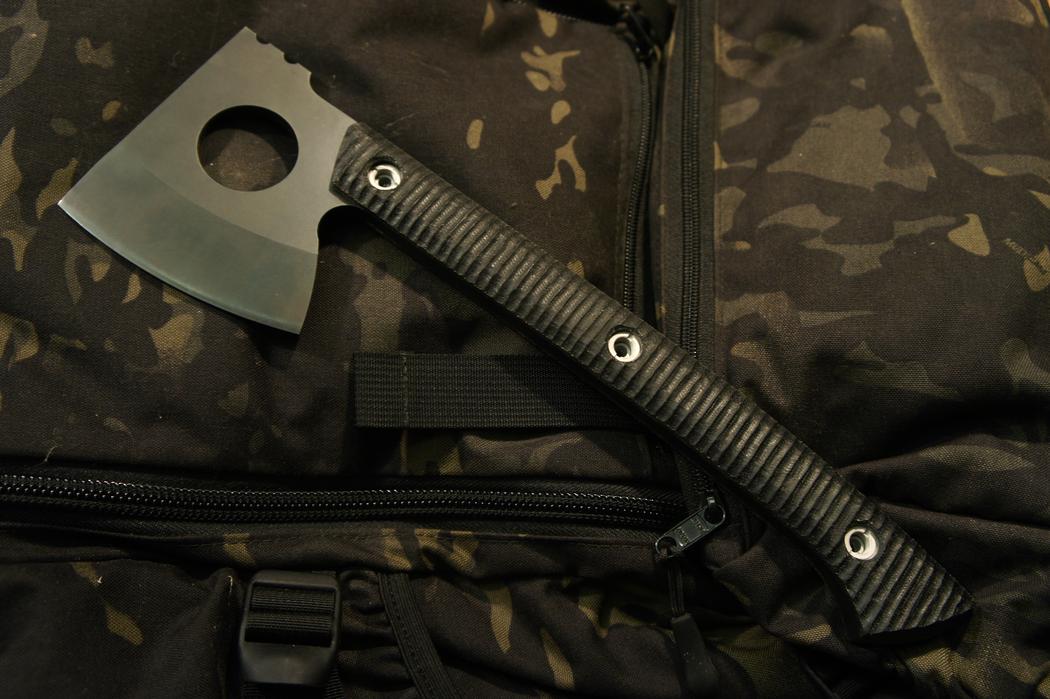

The silver twill texalium is super grippy with the sandblasted finish. I usually polish it to a gloss but really like the feel.
