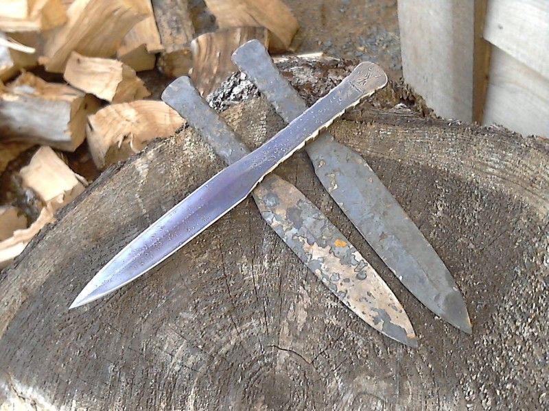

I have been getting a head of my self an end up doing to mucheck post forge work. So now its back to basic, banging out some blades to 80% complete to better my hammer skills.
A smal hunter, two pairing knives and a smal sailors spike.
