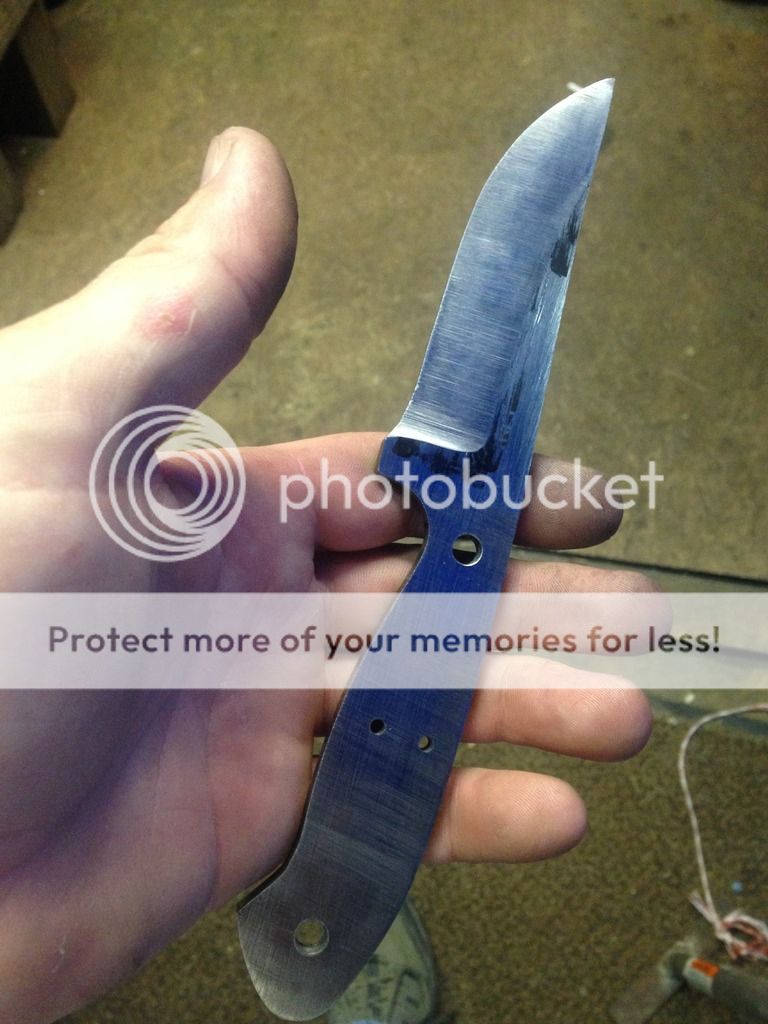

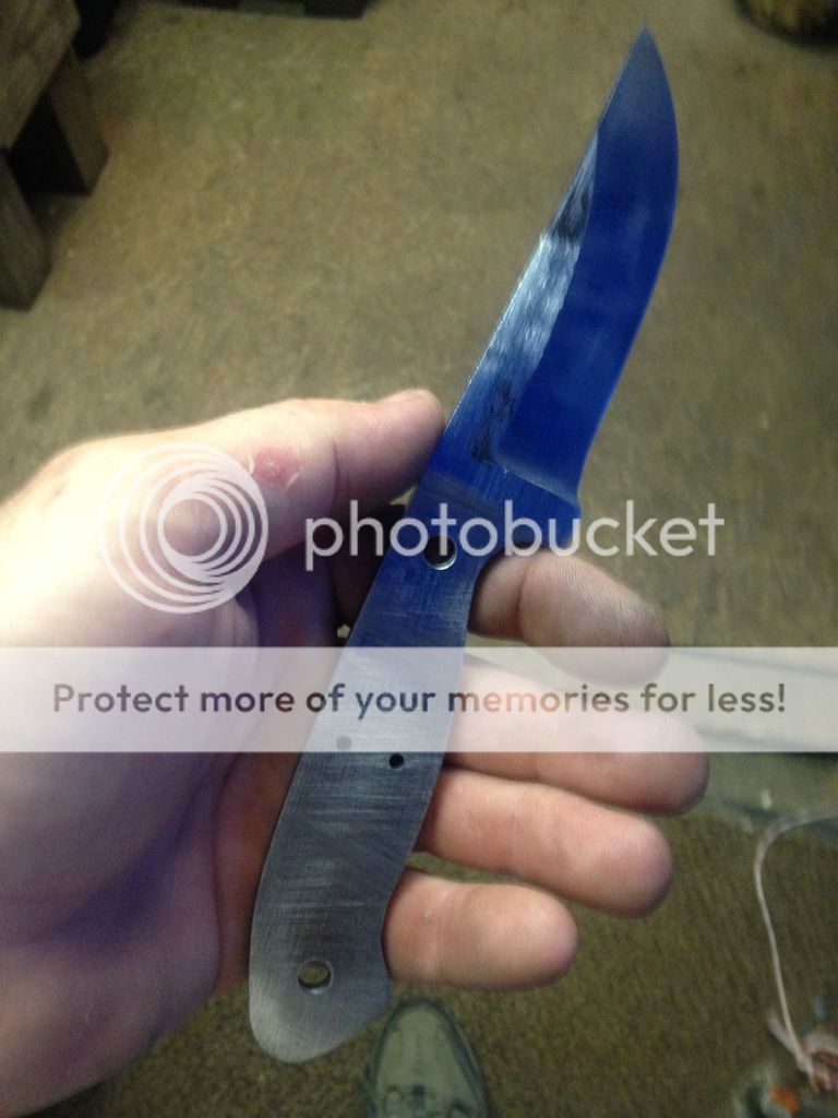

No offense taken guys. I appreciate the honest feedback. I got so caught up in doing it this way I didn't stop to think that it would look anything but intentional. Now that you guys point it out I agree. Guess I should ask questions before I grind next time lol. Into the scrap pile....

Offset grinds are common in kitchen knives. I do a lot of them.
I'm gonna finish it out anyway. It is still functional. I was just curious if it was used by anybody and if it was advantageous at all.

try slicing stuff with a 70/30 grind , you just might prefer it ;)
Convex the right side, and full flat on the left. Helps with food stiction. About 1/3 to 1/2 of the kitchen knives I do are ground like that. :thumbup:
Convex the right side, and full flat on the left. Helps with food stiction. About 1/3 to 1/2 of the kitchen knives I do are ground like that. [emoji106]
I'm already full flat on both sides but I'll keep that in mind for the next one. Thanks for the tip!

Don't scrap it. Grind the short side until the plunge matches and make it a paring.

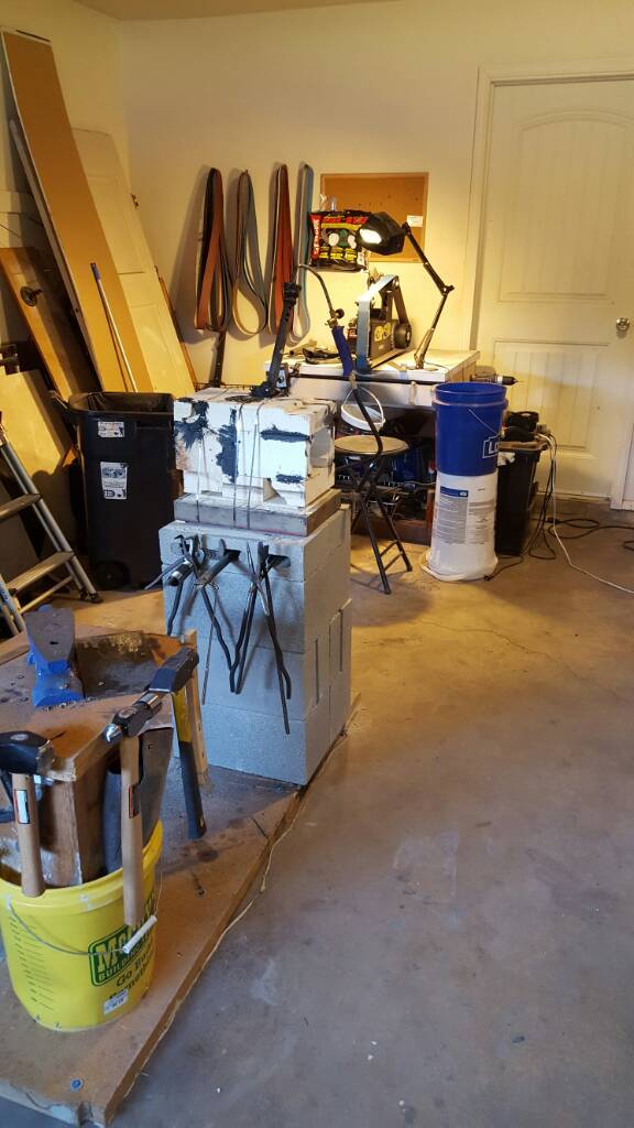

I've been working on forging blades lately and my homemade forge just isn't going to do anymore. I'm considering one of the Devils Forge models from ebay. Does anyone have any experience with them?
