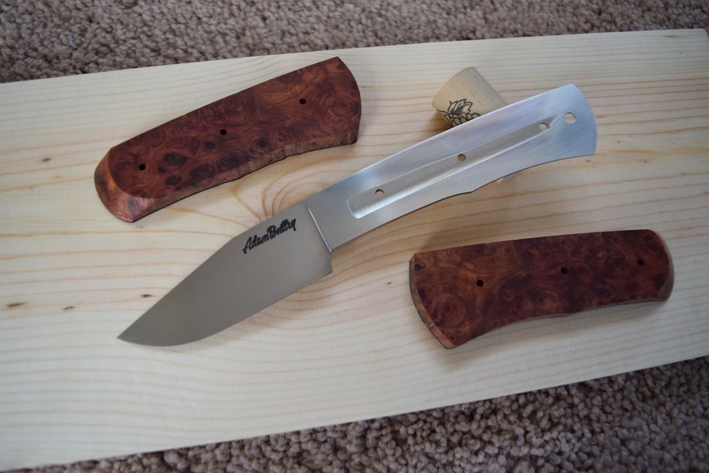

.125" CTS-XHP @ 61.5 Rc w/ Amboyna Burl. Tapered tang and hand finished.

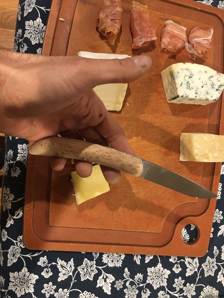

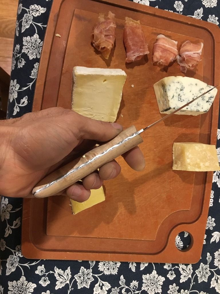

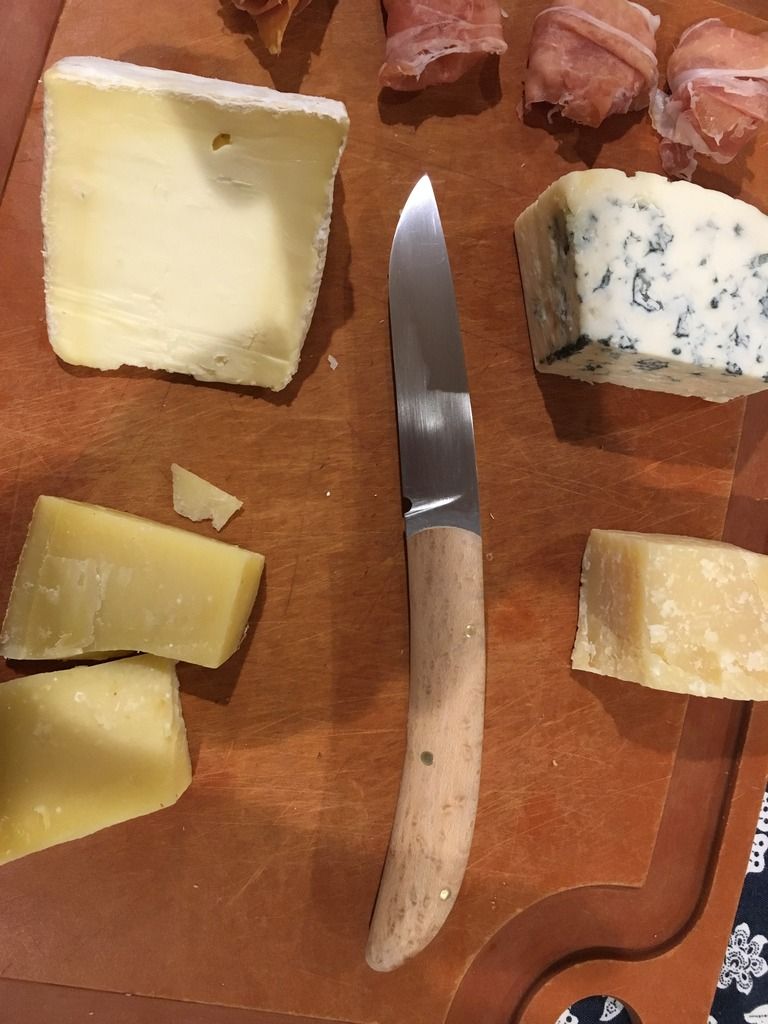

My first knife using stock removal. O1 tool steel and birds eye mapple. It is almost done, I will do the handle finish (dye + oil) this WE. Pretty happy to how it turned out with one exception:
The practice knife I had made with mild steel looked great thanks to the dark handle and dark tinted epoxy which was blending well with the handle. It made the filework looks really nice. On this one with light wood, I haven't managed to make the color of the epoxy match (it is white) and when sanding the filework te epoxy got tinted grey by metal dust.
I had to resand the filework after assembly as I did the final shaping of the handle after gluing. Not sure what I should have done differently.
Your pins are rather wonky. Besides not being centered thy come out in different places then where thy start on the opposite side. How did you heat treat it?
For your first knife it looks good, we all have to start somewhere.
