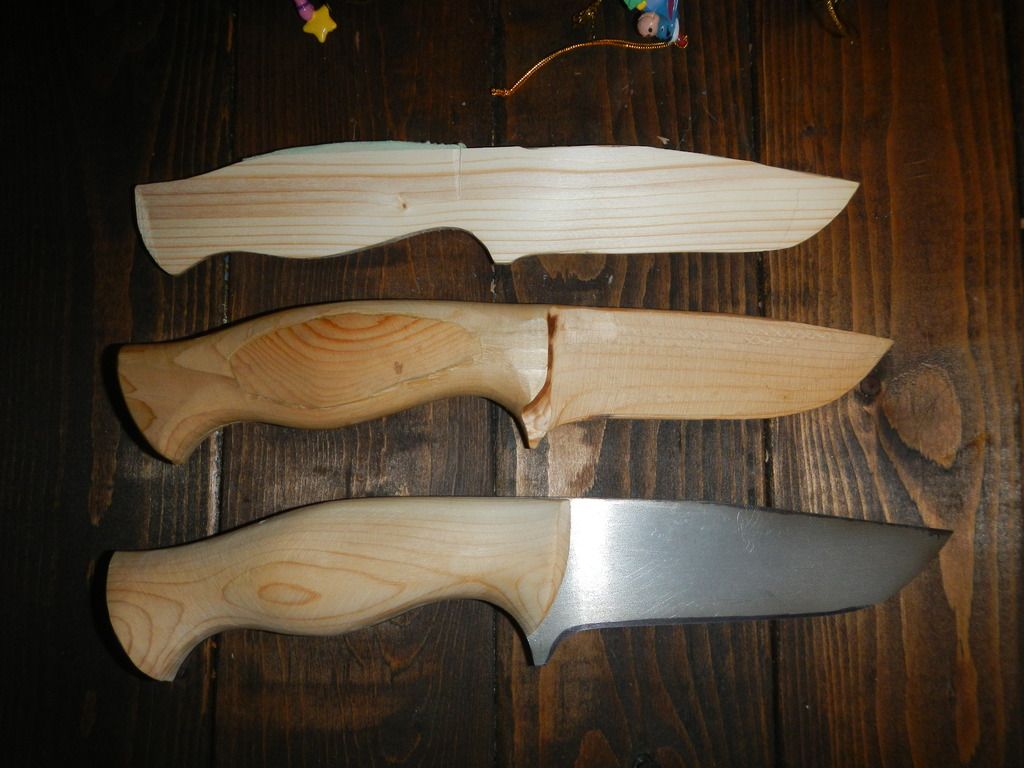

trying something new in the last few months... wooden models. R&D only obviously, but theyre allowing me to work on new designs in 3d and get the fit and feel right without having to make 10 prototypes. top was the original and the bottom is the first i did with a roughed out metal profile. you can see i added wood shims to the handle in the middle one to see how it felt with a bit thicker handle
Smart!
Thanks Daniel. best part about this process is that i can have 5-10 handles done up to compare different characteristics in the same time it takes me to make one full up steel prototype.

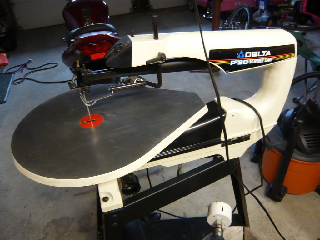

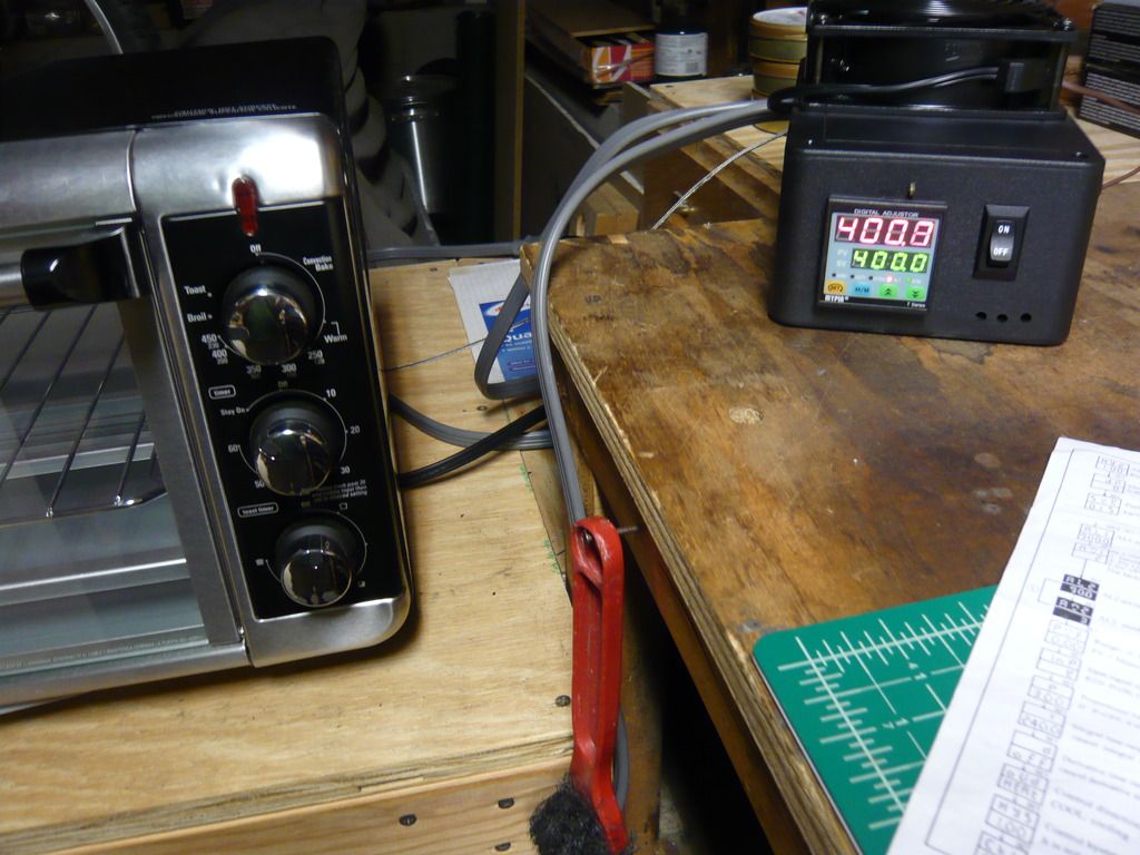

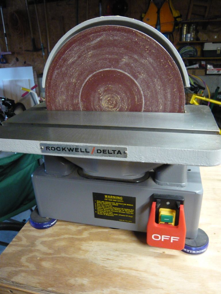

Here's the equipment I've acquired in the last month or so. A used scroll saw, disc sander(really nice find), and portable hardness tester. I also built a tempering oven. Also, my first attempt at making/heat treating my own blades/knives. It took me a few times to get the hardness I wanted. I guess I wasn't soaking them long enough in my Atlas forge. Used 1/8" 01 tool steel. A Japanese inspired petty knife and Kiradashi.
We do the same thing! Makes the initial prototyping much faster and cheaper too!

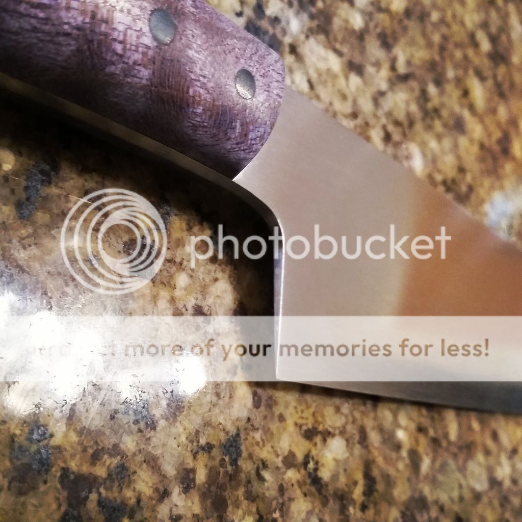

Cpm S35vn petty knife. Dyed and stabilized curly maple handle, with carbon fiber pins.
The handle looks blue or purple depending on which angle you hold the knife at :cool:
