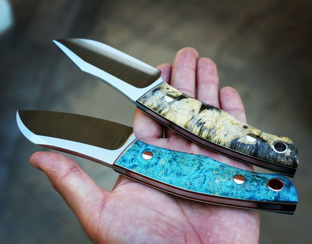

Finally finishing up some designs I've been working on for what feels like forever. Very excited to see the final product.

I'm digin' that copper! Nice clean stuff as always!
