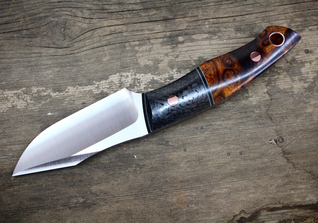

Just cranking away on some more blades this week. This one is from a while back but I had to post it. Probably my favorite knife I've made to date. :D

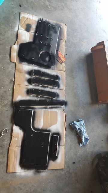

Man you guts make some beauties. Can't wait to finally get up and running. I could be attempting knives with a 2x42 and a hand drill but it's just WAY too frustrating. So got myself a big boy grinder. Here it is all painted. Just gotta weld it together and get the rest of the parts.
Mknife that checkering is outstanding! Did you use some kind of guide with a checkering file? Are you going to point them up a bit with a triangle file or leave as is? 30 LPI?
Grazie. I use a Grobet Swiss Pattern File Checkerings Hand 6 Inch Cut 00, 20 lines per inch.
I do not use guides, but with a pen make a sign for the inclination that must have the file (angle of 35 ° respect to the knife length).
normally we paint after welding
