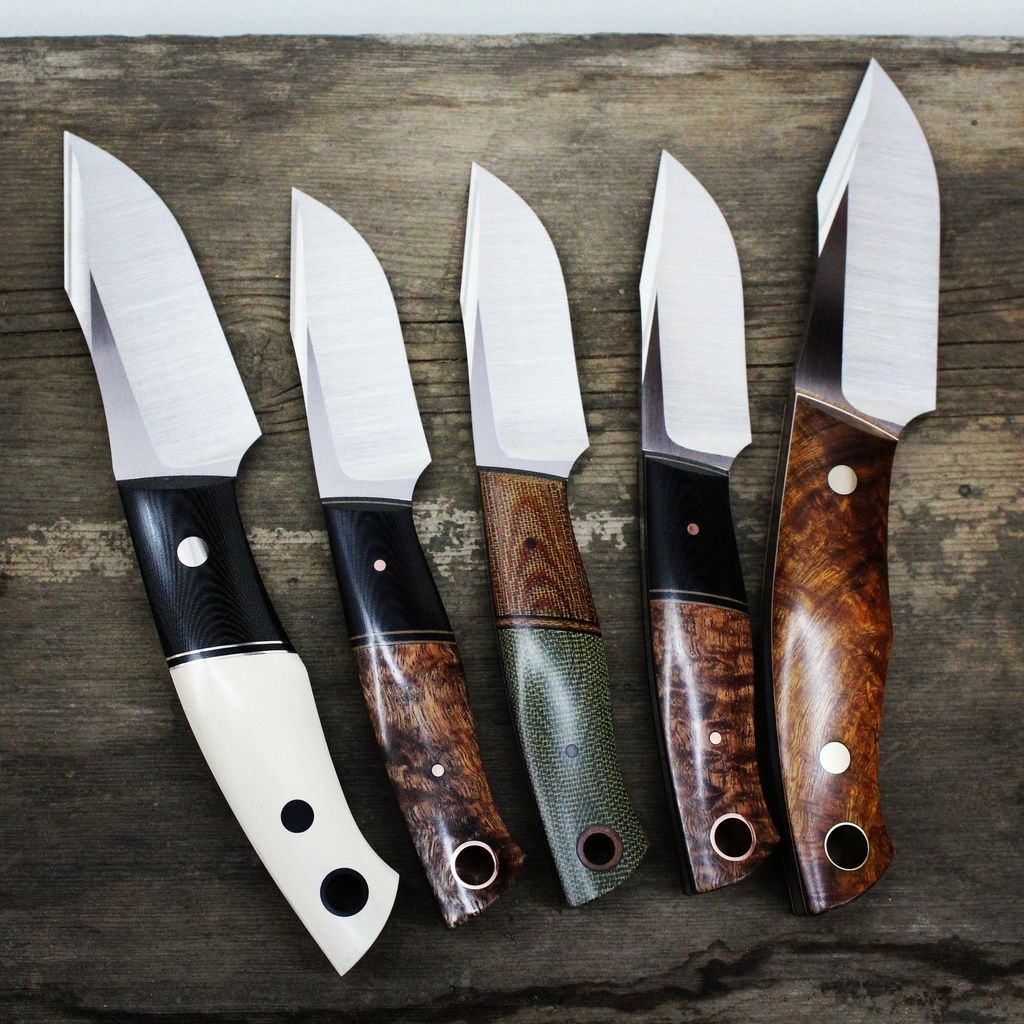

First time using wenge. Really like the look
Looking good JR. I used the same combo on my kith knife. W2 and leopard wood from burl source.

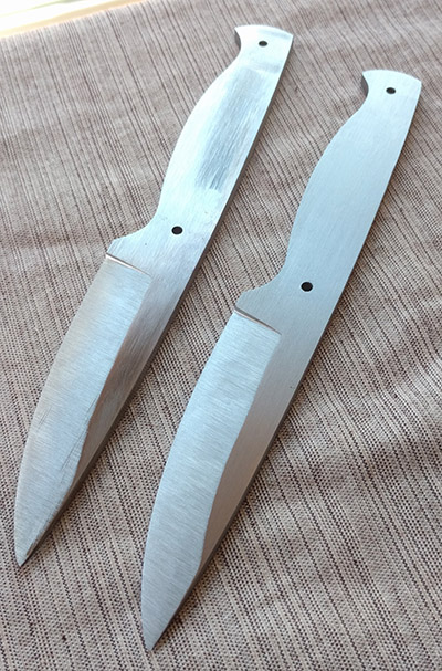

Decided to make a 1084 prototype for a modified version of a classic Schrade I've been commissioned to do in Z-Wear. I liked how it turned out so I put scales on and made a sheath. I just kinda banged the pin holes in there and now I wish I'd laid them out a little more carefully like I would for the actual knife. Maybe I'll plunk a thong tube through the back still.
