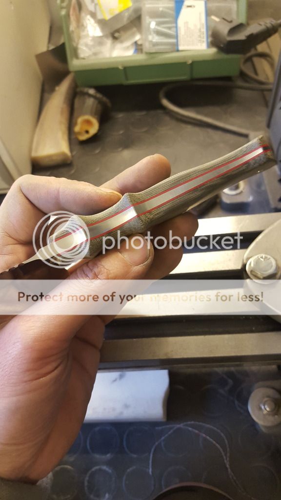

This is a custom order...
_______________-
Riccardo Mainolfi
I am doing that same design (without the serrations). The customer's dad has a schrade/ loveless PH-2 and he wants something similar. The handle contouring has been giving me fits.

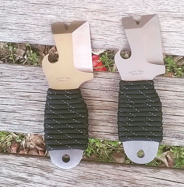

It's been a while! Right now we're prepping for the local hunting and fishing show we do each year. Down to the wire now, the show starts a week from today! Working on some big batches of blades including our new flipper.
Folder lock bars
